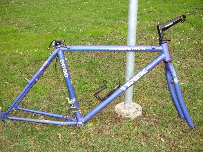

I'll update this thread with some more pics in due course, but right now i could do with some assistance please!
This is the front mech route...anyone know if there should be a roller there? If so, where can I get one from :shock:
Pic lost :facepalm:
Once A Hero
Re: 1992 Trek 8000
al-onestare":lhydecnz said:
No roller, it's a cable stop.
Are those pen marks on the left, or something more sinister?
Cheers - thought so, couldn't remember there ever being a roller there.
As for the marks on the left, in the words of The Black Knight "'tis but a scratch" :)
mynchiboy
Just about to answer this, but pipped to the post..
The front mech should have a 'Trek specific' barrel adjuster fitted to it, and the threaded bolt is indeed a cable stop. You can just about make it out in the picture below. No idea why they did it like that though :?
Once A Hero
That's how its goes?! :shock:
Luckily i do have the Trek specific cable stop, but could have sworn it looped around and back up to the mech.
I'll re-do it :)

Its on the work stand right now!
I’ve stripped it down and am now waiting on a few new bits to arrive. Biggest problem I have at the moment is that the stem is stuck fast! I’ve been soaking it (as best I can) in WD40, hitting the stem with a mallet every now and then, but it still won’t budge!
I’m going to reattach bars and a spare front wheel later to see if I can lever it loose.
Should have been an easy bike strip and rebuild, but it’s proving a pain!
