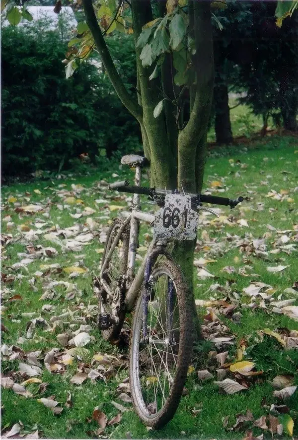

‘92 was a good racing year, competing in some much larger events - the Cheddar Challenge being the most memorable highlight (1st place Youth!). Here’s a shot of the bike post race.

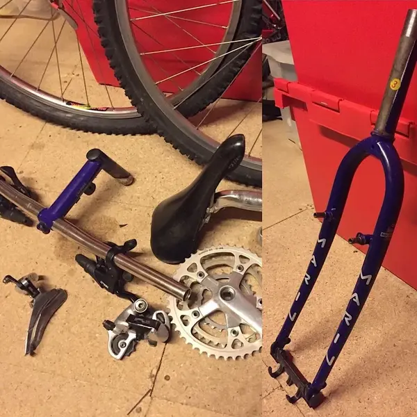

So here we go with another revival build. A complete IFT was found (eBay), and stored whilst I prepared to move house.
The original plan was to go back to factory spec, so I started sourcing the missing bits - 750g Rockstar forks, and matching stem being the key items. The bike has the correct seat post and binder, but condition isn’t great. No Marin saddle, just a shabby but period(ish) correct Flite, and no Marin tyres.
The front hub was M737 XT, and the bars (although Answer Taperlites) were set to be replaced with spec correct items. And the sorry looking XT rapidfire shifters were to be replaced with much tidier examples.
But then I changed my mind.

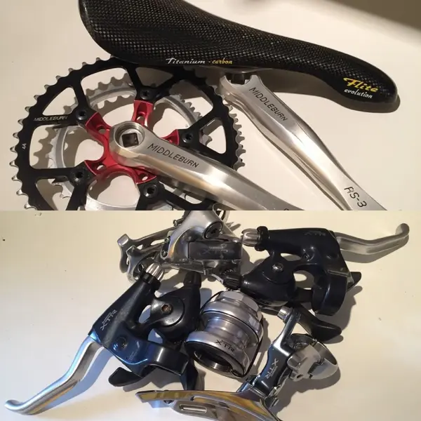

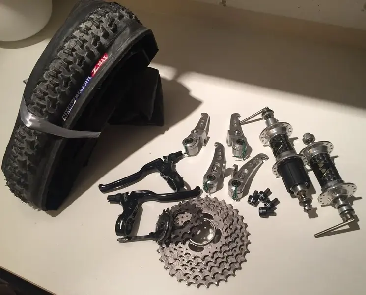

I want the ultra light bike that some toe rag deprived me of. So the build is going much higher end! Here are the some the parts that I’ll be applying;

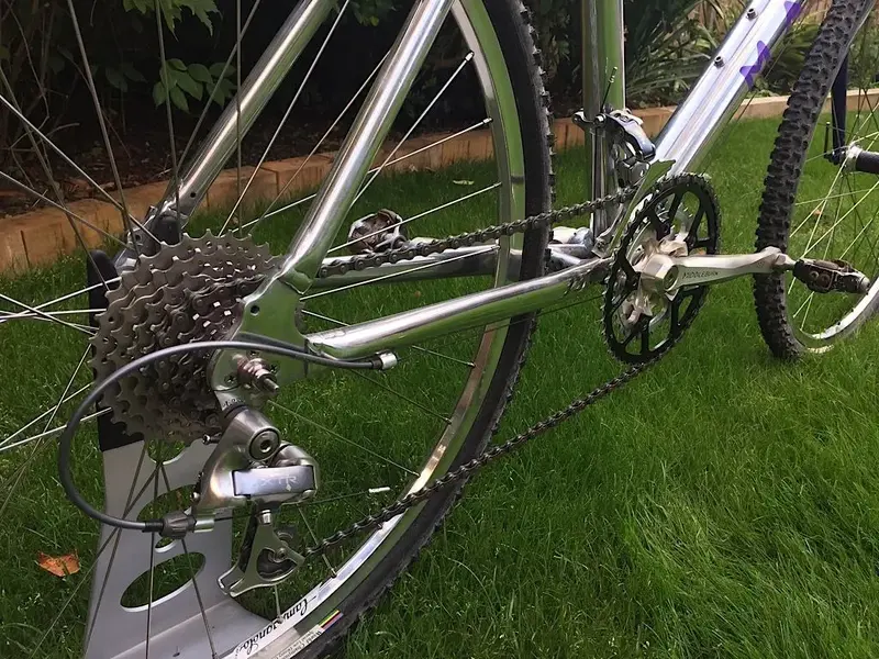

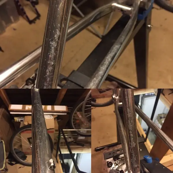

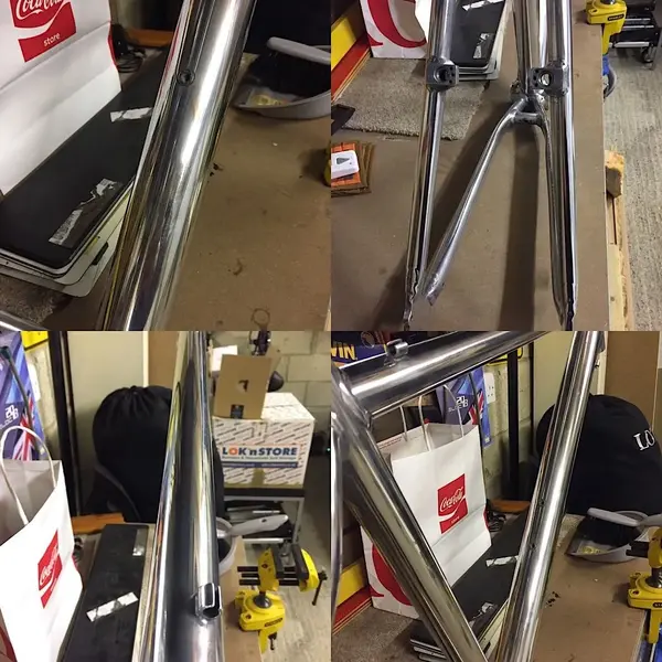

The decals were terrible reproductions, and the frames lacquer was failing, so I’ve had the frame polished to remove the deteriorating lacquer (it’s still not perfect but it’s certainly been improved).
Before:
After:
And new decals were sourced via gil_m.

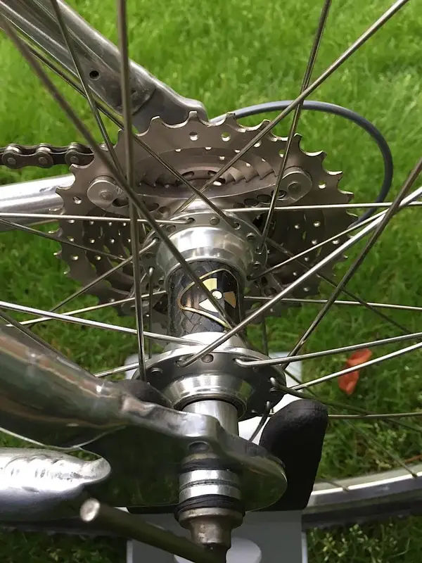

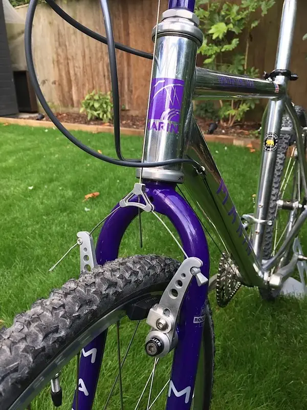

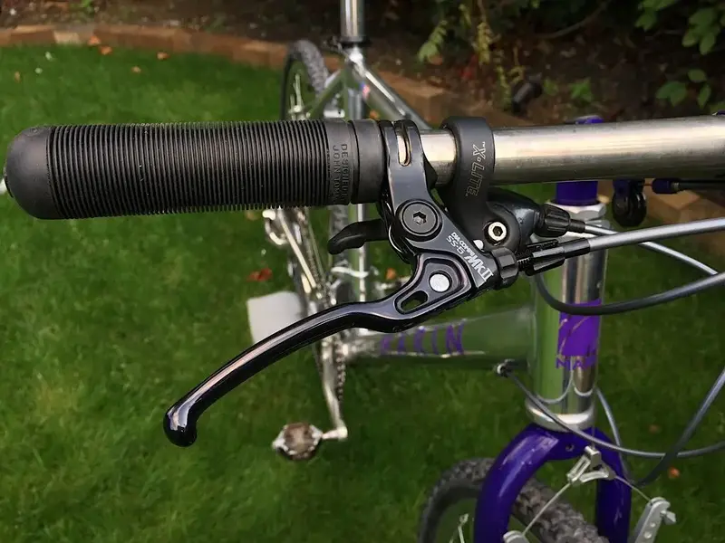

There are a few things I’m not entirely happy with, the X-Lite Ti bars which I had laying around are a bit sorry looking, as is the Marin Lite seat clamp, plus I think it deserves a better seatpost than the OEM item, and the pedals are a bit shabby, so those items may get changed over time.
Here’s the finished spec:
Frame: 17.5” Marin Indian Fire Trail, 7000 series heat treated Aluminium
Fork: Marin Rockstar Cromo 750g
Headset: Shimano M900 XTR
Stem: Marin Lite Cro-Mo
Stem Cap: N/A
Handlebar: X-Lite Titanium
Grips: ODI Attack (NOS)
Barends: N/A
Brakes: Grafton Speed Controllers with X-Lite bolts
Brake Pads: Dia-Compe
Brake Cables: Shimano XTR
Cantilever cable hangers: Avid Tri-Dangle
Brake Levers: Dia-Compe SS5 MkII
Shifters: Shimano M900 XTR on X-Lite perches
Front Derailleur: Shimano M900 XTR
Rear Derailleur: Shimano M910 XTR
Derailleur Cables: Shimano XTR
Cassette: Shimano M900 XTR
Chain: Sachs

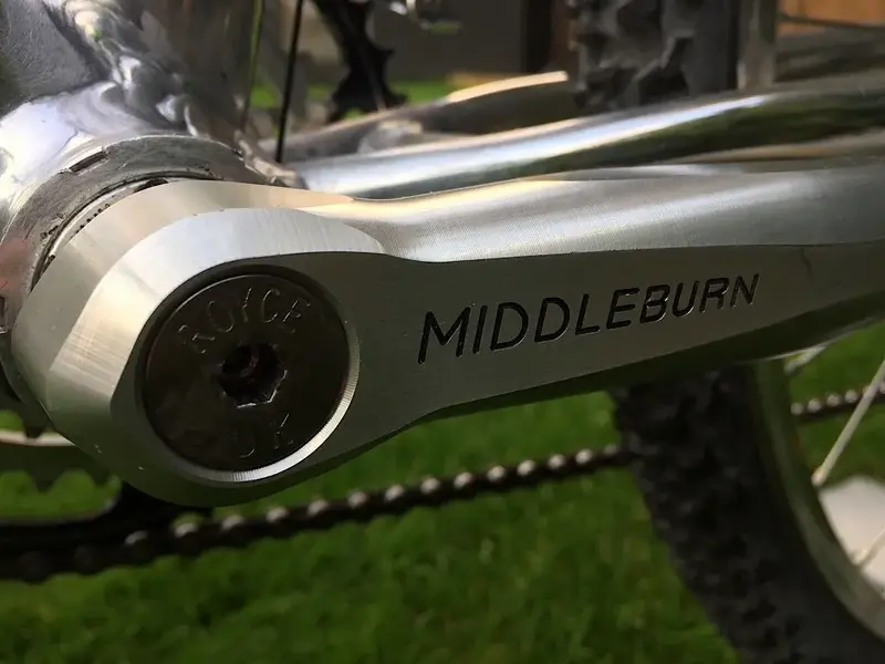

Cranks: Middleburn RS-3
Crank Bolts: Royce Titanium
Chainrings: Middleburn 44-32-24
Chainring bolts: Middleburn
Bottom Bracket: Royce Titanium
Pedals: Onza HO Ti
Rims: Campagnolo Atek (NOS)
Hubs: Nukeproof
Hub Skewers: Nukeproof
Nipples: Sapim
Spokes: Sapim
Tyres: Ritchey Z-Max 1.7 (NOS)
Tubes: Continental

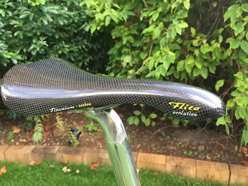

Saddle: Flite Evolution Carbon
Seatpost: Marin Lite Alloy
Seatpost Binder: Marin Lite Alloy
Weight: 9.69kg / 21.36lbs

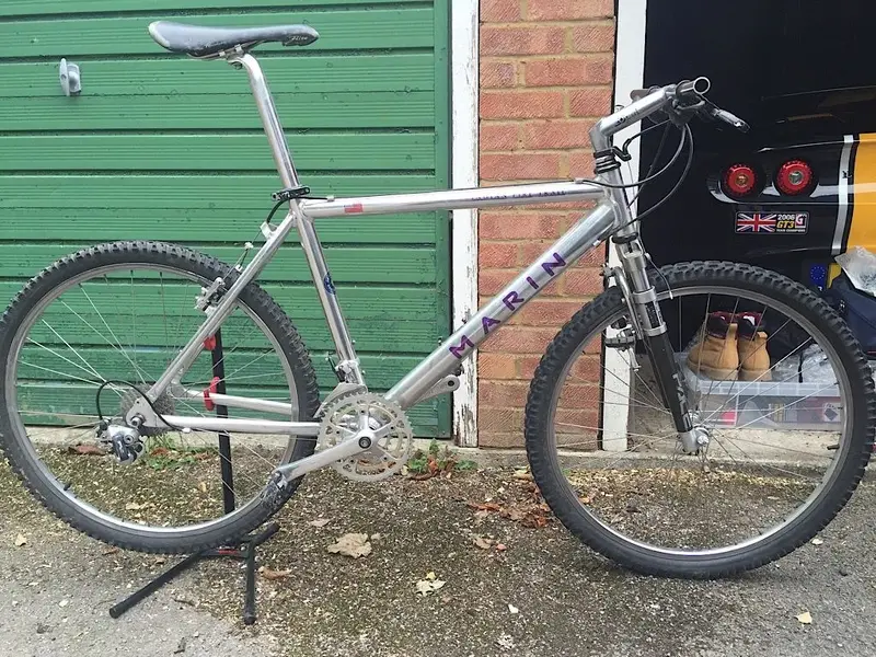

And here are the finished pics, hope you like it.

lovely job on the polishing :cool: ... what was your method ?
Specialist bike painters weren’t interested in doing anything to a polished ali frame, so I took it to metal polishers who used various belt sanders.
It’s not the best job - they didn’t get right in to all the small spaces, so I was a little let down to be honest. Apparently the lacquer was very hard to remove so I am glad I didn’t tackle it by hand however.
