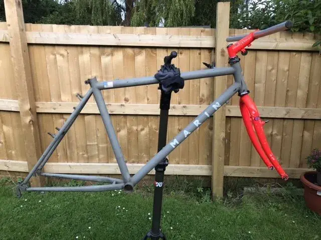

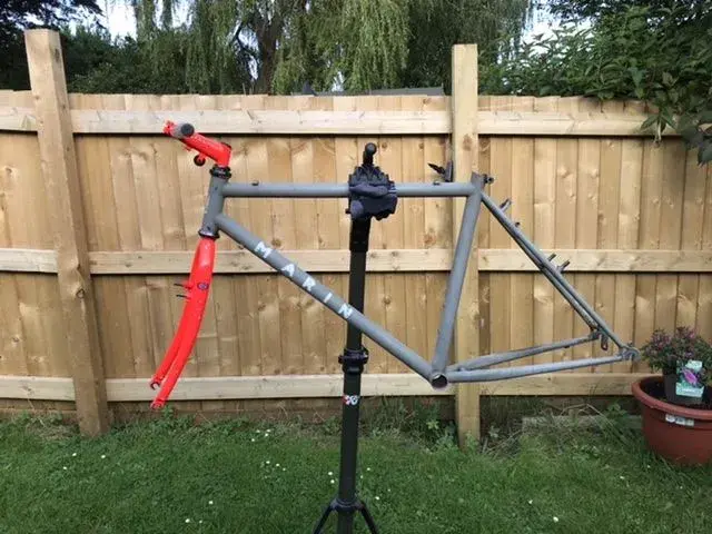

Hi, it’s been a while since I did a build thread, but here goes.. I wanted a zolatone Marin since my friend had an Eldridge Grade back in 92, I know the zolatone on this earlier Pine is slightly different but I’m really happy with it, actually, I’m chuffed to bits! The total gent that is Corblimeygov just dropped into conversation recently that this was available at very reasonable cost and only a short and very nice drive away.. anyway, thanks Ash, I love it!
Just given it a wash and t-cut polish on the orange, cleaned, re-greased and fitted the STX headset (never done a threaded headset before!), I might touch in some of the grey but I like it as is..
I was going to fit M960 I cranks because I have them but might keep an eye out for some closer to the period, or maybe go 105.. it’s not going to be a factory build!
I have some nice old Sun Levander on LX wheels, some thumbies, M739 brake levers etc.. I’ll update as it comes together
