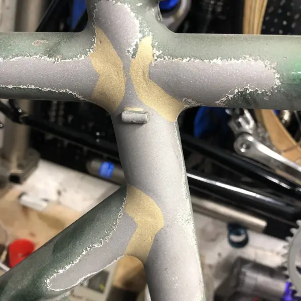

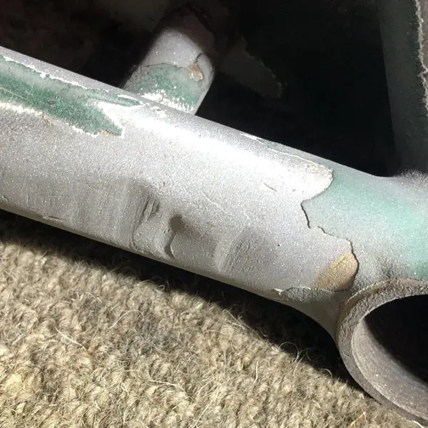

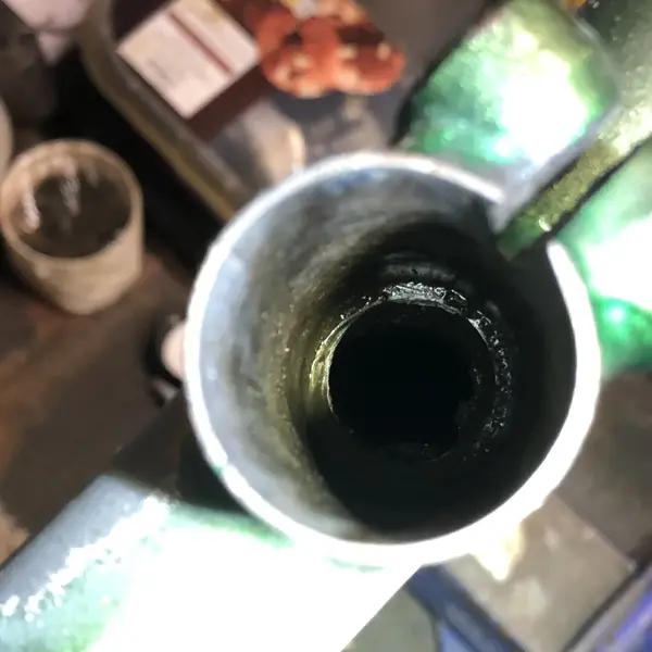

Couple of positives have happened, first the good form from the previous (temporary) owner giving me a partial refund, then after discussing the frame with Steve at Arthur Caygill I’m going to save a fair amount by removing the various details from the frame myself (redundant pump pegs, old school BB steel tube guides & coaster brake mounts) also we discovered that after closer examination the front seat tube can be saved as all the various cracks were only paint deep and the rammed in seat pin is aluminium so I’m going to treat that to some caustic soda.
The rest of the work (including a new chain stay) will be done by AC including a baked enamel paint job sometime in January, so that gives me a while to sell a bunch of parts. 67BAC212-3EA0-4F1B-B21D-957E68811987.jpeg E665ED0B-7D6B-482D-9EED-19F696BC0A5A.jpeg 346B27EE-9E2B-442C-AC72-950B73C0D007.jpeg 52668BBF-A115-4789-A969-FF5738903162.jpeg
Just dont tell him some daft sod has cut the BB shell in half!
