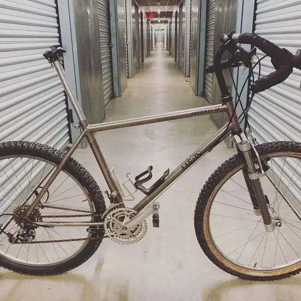

I need to finish mine. Hopefully, it won't ride like a wet noodle given it's an early one.
I need to open a build thread. In a far from the finished state:
