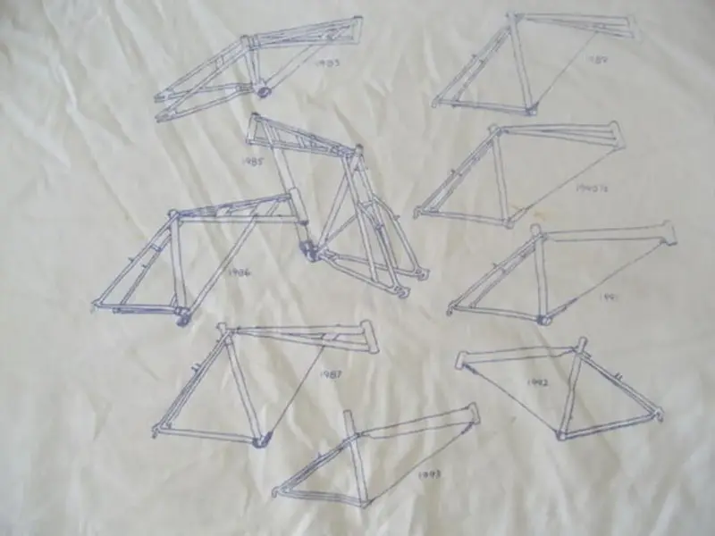

This drawing shows the different versions of the Slingshot. Note that mine is a 86 - the 85 have a pretty distinct extra set of seat stays and the tube that the upper cable is mounted on is round in 87. The 86 also have two sets of flat plates accompany the triple top tube and twin spring/cable set up. In 85 there were two sets of round tubes and in 87 there was only one set of flat plates. The top left marked 85 is the 85 BMX frame. I believe that the 85 and 86 model had a flex board painted in the same colors as the bike, but from 87 and later on it was not.

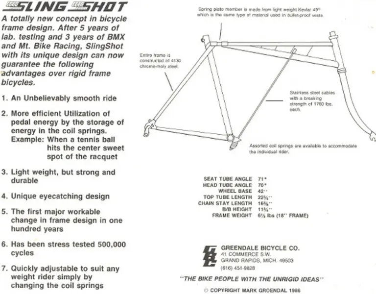

This cool fact sheet from the makers have some funny thoughts. Would love to ride it very hard to see what it's made of, but frankly I would not dare to do so, especially because getting spares for the frame is more or less no way.

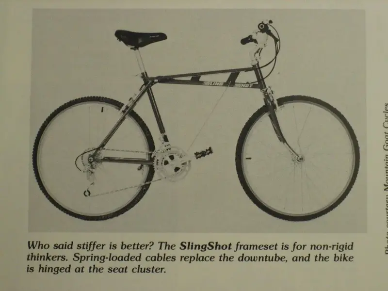

Here you can see the decals that it should have. It's the same as on the BMX bikes and looks pretty fast!
