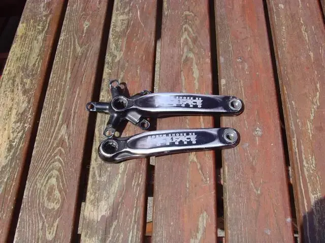

So having dabbled with the spray cans on a pair of crappy old cranks a month or two ago, I thought I'd have a look for something more appropriate for my project virgin build, when I stumbled across these:
So after a rub-down in W+D for a decent key
(the surfaces were prety much gouge-free 8) ) I set about applying 4 or 5 coats of grey primer, just giving the smallest/gentlest of rub-downs in between coats, to get a good 'all-over' coverage.
A few days later (After the wind and rain had calmed down) the sun came out, so I got to work on applying the white paint, really thin coats to start with, trying to build up the layers, and allowing a decent amount of time between coats. 10 or maybe even more :shock: coats later, I had a good all-over finish, in white, which I was very happy with, so gave them a half-hour low-bake, just to try and harden the paint a little, prior to lacquer.
Next day, the sun was out again, so I applied maybe 5 or even more coats of clear lacquer, and once I was sure the final coat was hard enough, I gave them another half hour low bake...
Today, the decals hav turned up, and I have applies 4 or 5 more coats of lacquer to seal it all in....................... and here ar the results....--> :D 8) 8) 8)
Cheers guys, :D
I forgot to mention that I'll be applying Helicopter tape to the areas most likely to rub, and luckily I have the top picture for reference as to where that might be :wink: :lol:
So based on that top picture I guess you'll need to completely wrap each arm with the tape? :wink:
