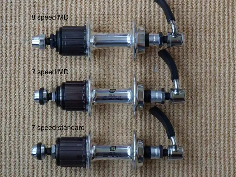

just hitting my old info bit
Freehub spline lengths
6 speed = 23.7mm
7 speed = 26.1mm
8 speed = 30.8mm
of course to help things :roll:
7 speed MD = 20.7mm
8 speed MD = 25.4mm
file.php
