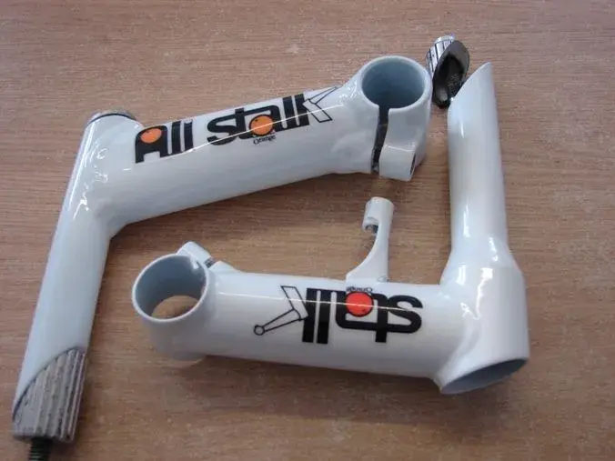

Im also getting a stalk stem done which I have decals for but it will look a bit weird if its white when the rest of the front end is orange..(I have the rigids as well)
Did they do stalk stem is orange?

stalk

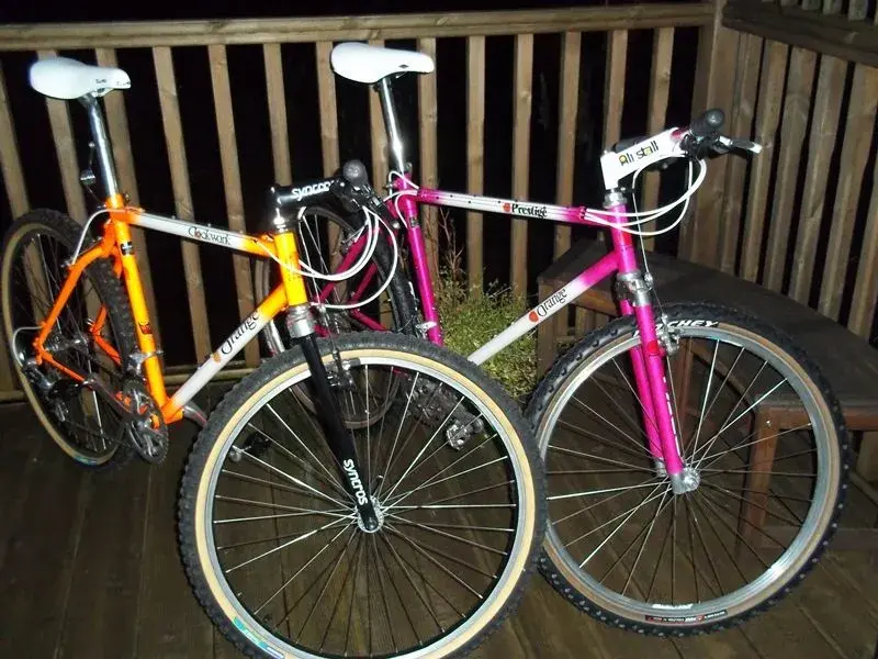

Closest image I have to hand im afraid, against the pink, not the orange. :oops:
Brocks maybe able to help though. 8)
