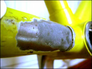

Another potential issue was the chainsuck damage. The chainstay had a fairly deep dent and gouging in it. After removing the remaining paint and rust I was relieved to find that the damage wasn't as bad as it first looked. There were no holes at least.
I'd already made the decision that I wasn't going to spent too much money on this build, so decided to repair the damage with metal epoxy repair putty. 24 hours later I lightly filed and sanded it back ready for a protective coat of paint.

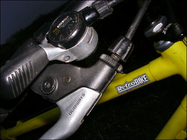

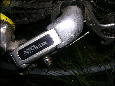

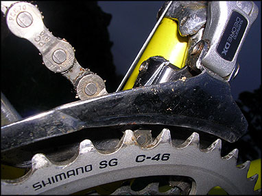

So far I've built it up using a selection of Deore DX mechs, brake levers and cranks, matched up with XT thumbies and some Alivio cantis for now. Put in a spare set of fairly modern wheels and a 26.4mm seatpin and Vetta saddle borrowed from another bike.
The bars are some scruffy Easton EA50s that were just lying around. I removed the tatty decals with some nail varnish remover.
The stem and forks, which came with the frame seem to fit in pretty well for now. I've ordered a shorter stem though as know the 130mm stem will be just a bit too long for my liking.

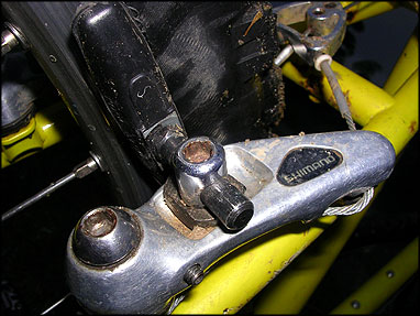

Hoorah! All the parts I needed to get this one rolling came in the post this morning, including a new headset mounted canti cable hanger. The cheap plastic one which came with the frame snapped off as soon as I applied a bit of pressure on the lever. :roll:
So this morning while my computer was hard at work rendering some video footage for a client, I found some time to fit everything.
I've swapped the long flat 130mm stem for a shorter 100mm one with what must be about a 15 degree rise. Much more comfortable and puts the bars and bar-ends within easy reach.
Also received some Deore DX cantis with new Kool-Stop pads from rigidkona (thank you), so I've fitted them in preference to the spare Alivio ones I had knocking around. Pretty much all period correct now then... 8) (apart from the wheels)
Early this afternoon, the computer went onto DVD authoring, so I fitted in a little test ride.
I have to say that I'm very happy with the way it all rides. Immediately felt comfortable and completely at home with the handling. This bike rides very fast too, albeit only on a little 12 mile road loop.
So all set for a proper test ride at Gisburn on Saturday.
