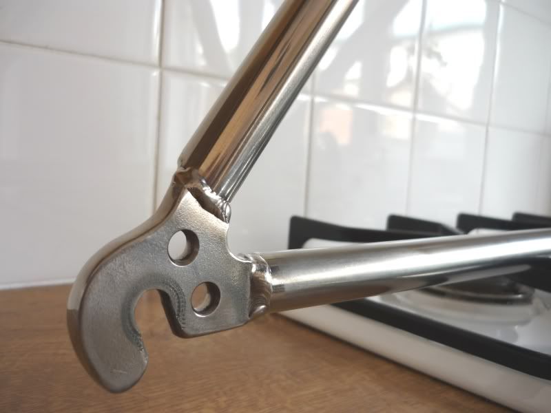

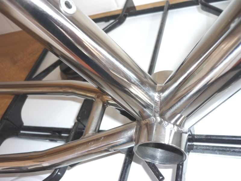

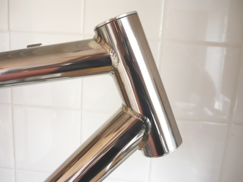

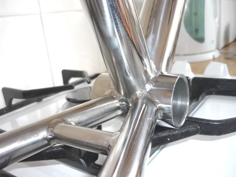

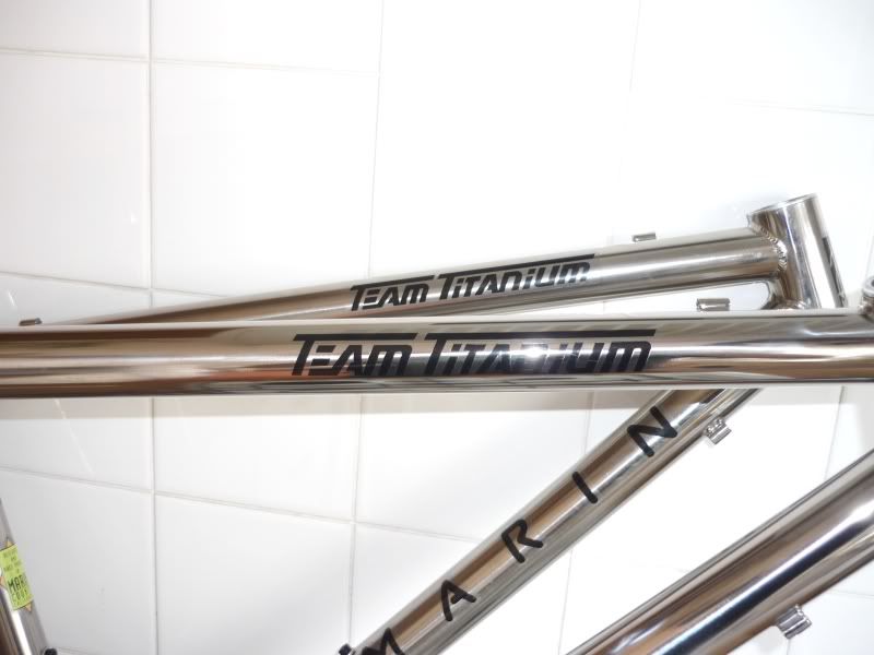

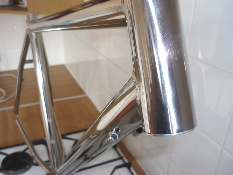

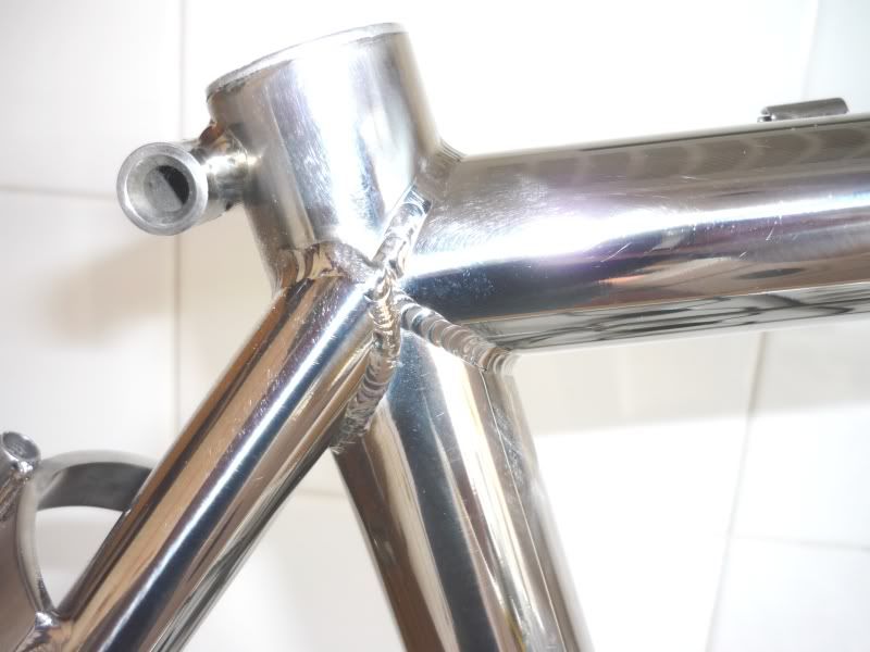

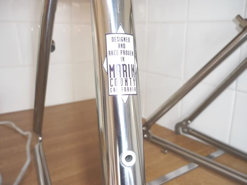

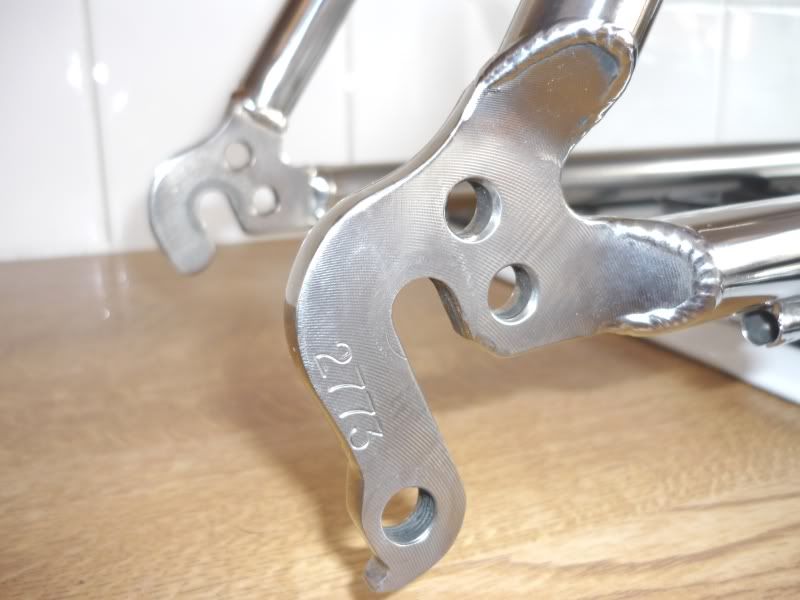

Take it to a proper metal polisher and he'll make it like a mirror for not too much money.
Professional job, with far less hassle and time.
See below for a job I did recently. Compare it with the NOS frame in the background.

How much does it run from a pro?
Is it me, or do the welds look sloppy! :lol:
