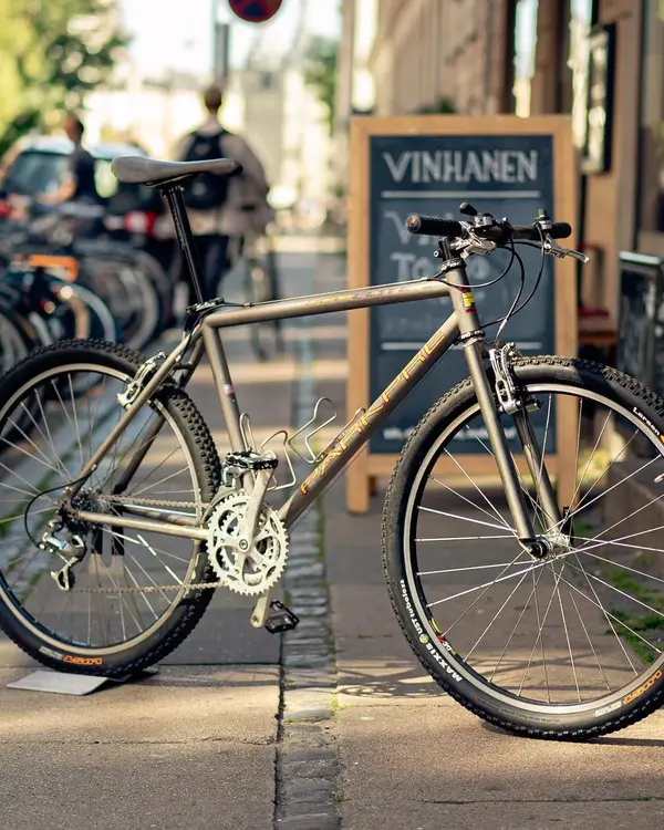

Frame as I got it:
Frame data:
PARKPRE PROELITE, Titanium
Stamped under the BB: 4S-12
Frame Geometry:
FRAME SIZE 19"
SS C to C 17"
S centre to top 18.25"
TT parallel 23"
TT' top tube 22.2"
WB wheel base 41.4"
head tube angle 72°
seat tube angle 72°
HT 4.5"
First build:
2#
#3
#4 (100mm REBA forks)
#5
#6
see page eight.

Looking good, glad someone from this forum got hold of this! And if ever you want to sell give me a shout!
As rekiborter says, some of the details of that frame are unusual and different to other ProElites and indeed other Parkpres too. The seatube doesn't extent much past the toptube, and the seatpost size is unusual for a Parkpre. The rear dropouts are different too.
Still a nice frame though. How does it ride?

As my colleague in all things Parkpre said it has some unusual features on the frame. Any chance of doing some more detailed pictures? Maybe this is one of the Litespeed welded frames?

Big up, Stinus! The bike IS lovely and it will be even sweeter with different tweaks ;)

But I'm with Rekiborter in wondering whether it's a Litespeed. As an ex-team bike it's pretty likely that it's preproduction at the very least.
Fork ends and seattube closures are very different from the others. Is there an alloy sleeve in the seattube?
