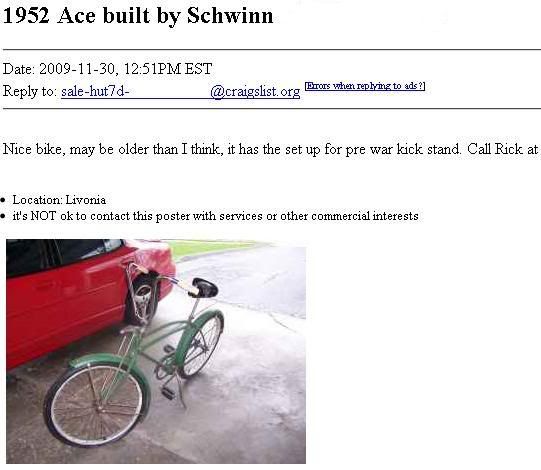

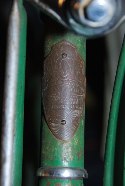

I really wasn't looking for new klunker project, but this DX popped up on the local craigslist and I couldn't pass it up :D

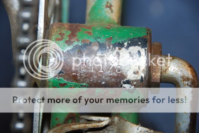

The frame looks decent. The seat stay cross brace needs to be re-brazed and the weld at the head and down tube is kinda funky, but nothing serious. S/N: B21178

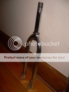

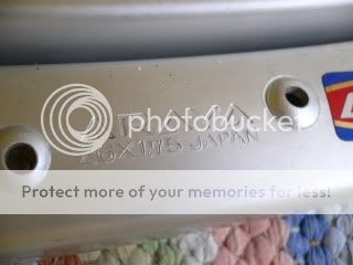

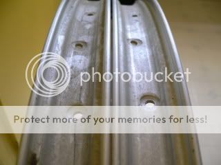

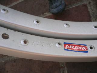

Araya 7C Rims: Anyway I think they are 7Cs. NOS 26x1.75
Akisu BMX forks: Stamped 1983

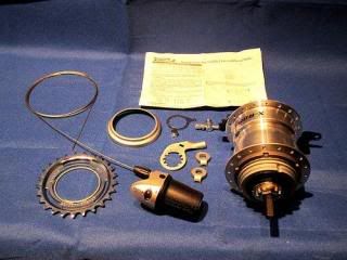

Sturmey Archer X-RD8(W) Hub: 8 speed IGH, 70mm drum brake. It's not supposed to be super strong, but the SA guy said this newer "W" is stronger and should be okay if I'm really careful to not shift under load.

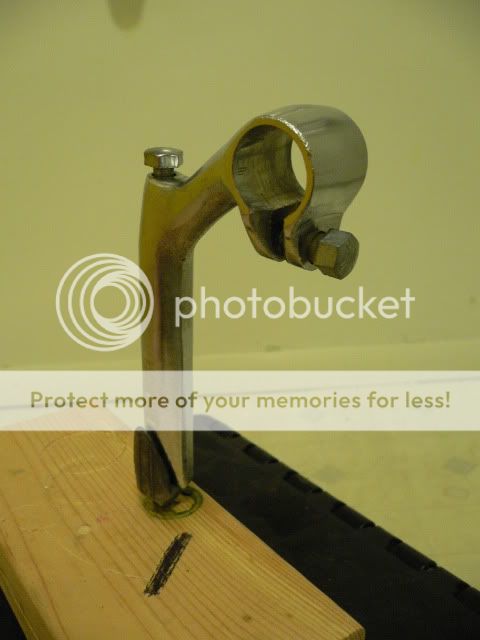

Picked up this chrome plated Ashtabula stem off of the bay. Date stamped 1979. It's off of a Schwinn Stingray.
Asking around the BMX forums, it's the same as the black oxide version except for the possibility that the bolts may not be heat treated? Much cheaper than the black oxide ones. Look for the side wedge and the chamfer in the handlebar clamp slot.

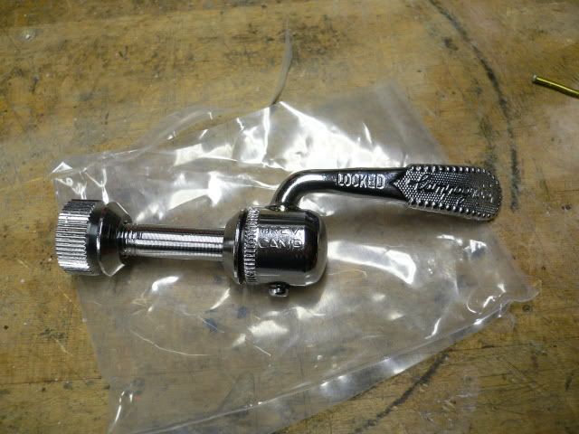

New Campy seat post binder came in the mail today. Not vitage, but sure is pretty :D

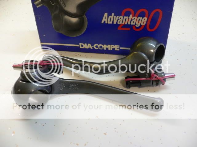

Another goodie came the mail today!
I've always liked these levers since I saw them on my college roommates late '80's C'dale. Not exactly klunker era correct, but I think they are cool.
NOS/NIB 1987 Dia Compe AD 290 4-finger levers in grey

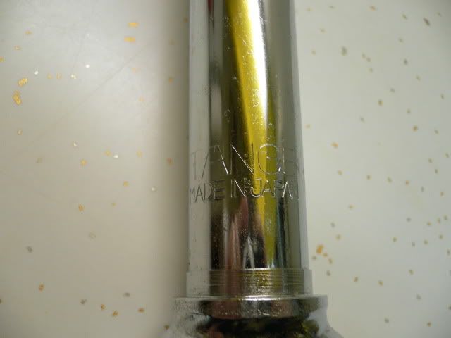

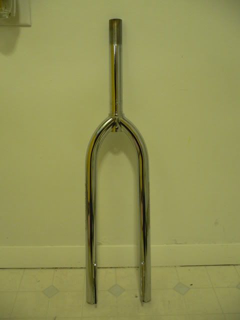

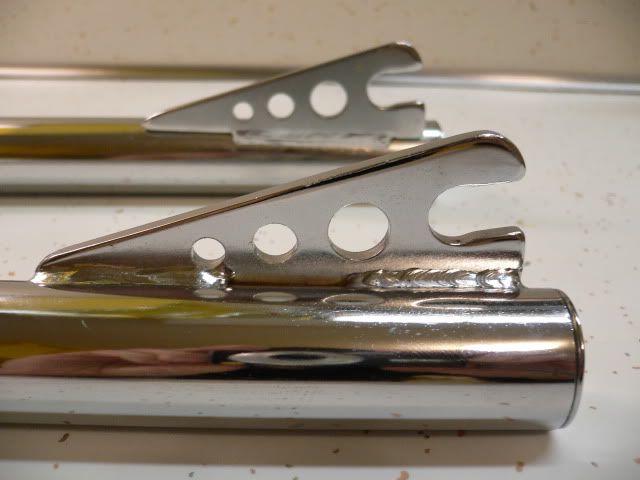

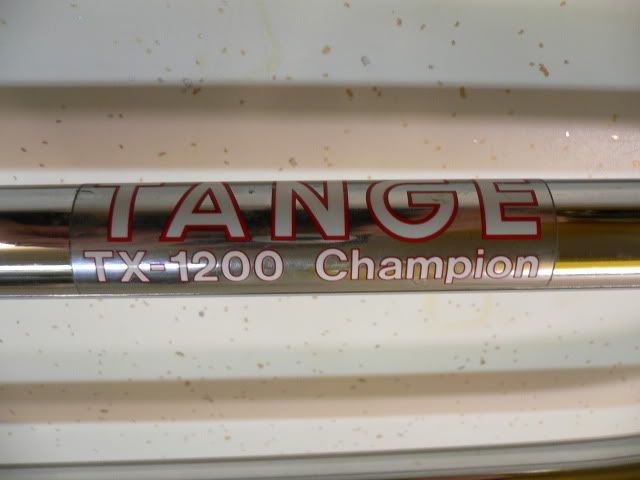

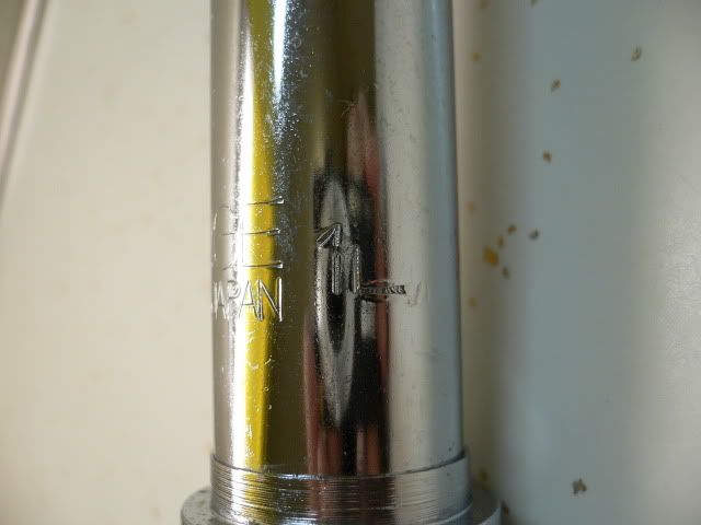

Got my mitts on a NOS Tange TX-1200 fork. Super nice condition. It's going to hurt cutting down the steerer tube!
I believe "1L" means 1981 December
It's a full pound lighter than the Akisu above.
