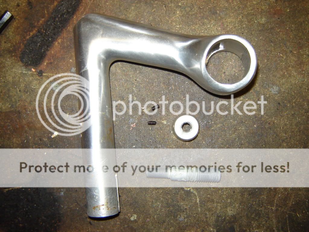

I've just taken this off a 600 AX. The coarse thread is left handed. The wedge swivels on the narrower part and is held on with the nut.
PostPosted: Sun Dec 06, 2009 7:37 pm
Joined: Thu Aug 06, 2009 5:48 pm
Posts: 868
Thanks a lot, Simplex. That's a massive help. Might be able to figure something out now I know what's what.
