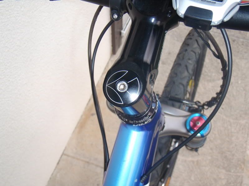

okay, been patient and persistant and got some parts and here is my adept with some vintage goodness
thanks everyone for the responses

Just now reading this post including the bit from way back. RE: powdercoating....Klein were somewhat vague as to why but they were pretty particular about the temperatures that their frames were subjected to and claimed that their processes added to the frame's strength. The frames were "cold welded" (their term for this) and then heat treated which changed the grain of the aluminum and again, added strength. I'm not too familiar with powder coating but if it involves heating the frame for a period of time, you could weaken the frame significantly. Also, since your frame has parts that are bonded, I wouldn't be too keen about heating up the resin glues that keep vital parts together. The last thing you want to do is have something crack or let go completely while you're riding. :shock:
I like the look of your bike and if you really wanted it painted a flat black, I'm sure you could go to any automotive repair shop and have them do it by painting over the existing finish - although I HIGHLY recommend NOT doing any repainting at all since your bike looks really decent. If you're going forward with the 3DV look, clearly you want your bike to stand out, right? Why would you paint it black and have it blend into the sea of other black bikes out there? :P :wink:
