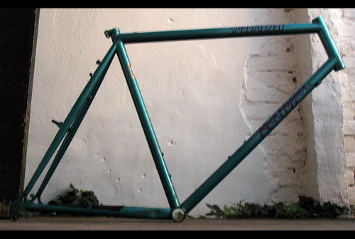

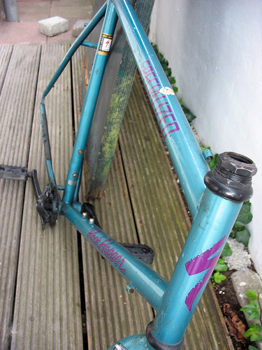

Got myself another Specialized Rockhopper today (as I said in the other RH topic).
Curious about the original specs. Can't find them on bikepedia (too early)
big: http://www.flickr.com/photos/leunkstar/3860159040/
big: http://www.flickr.com/photos/leunkstar/3860159480/

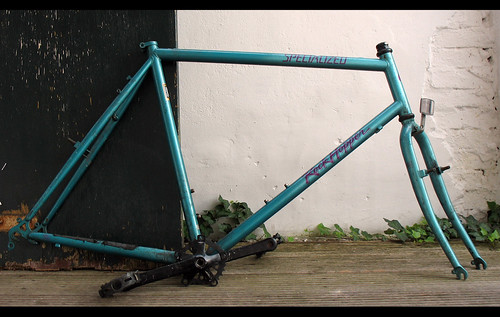

some quick cleaning and writing down of parts:
big: http://www.flickr.com/photos/leunkstar/3860158634/
frame is 54cm (21.5") steel Specialized Rockhopper
sticker: "conforms to B.S> 6102/1F.C.I"
serial: GW165537
also in the BB is a 3 and an A
any clues?
Bottom bracket is a Shimano, yearcode PH (1991), 73mm BC 1.37x24
headset is a steel YST
crankset is a Shimano Exage 400 LX FC-M400 "Biopace-SG"
got to love Biopace ;)
48-38-28
175mm
yearcode PC (1991)
pedals: HTL-P48
never heard of
reflector: Cateye RR-180-BT
plans?
I had this nice RockShox Mag21 fork to fit but the headtube of the frame is way to long. The Mag 21 only has 14cm top tube :(
I have a 1990 1" Shimano Deore XT HP-M735 headset and a 1995 Shimano Deore XT RD-M737 rear derailer for a start. Oh and a Syncros seat post if it fits.
Any comments on it?
btw, the paint is in nice condition but very dirty. Elbow grease will restore it!

think it's a 92, possibly a 93.
Lovely.
8)
PostPosted: Thu Aug 27, 2009 2:07 pm
Joined: Wed Feb 20, 2008 12:21 pm
Posts: 5955
Location: Lost in Translation
That's a '92 model year:
http://www.retrobike.co.uk/gallery2/mai ... emId=15578
I say this all the time, but be aware that the original headset is (95% certain) JIS standard:
http://www.sheldonbrown.com/gloss_ha-i.html#headset
You can replace like with like, or have the frame and fork milled to ISO standard.
Quote:
plans?
Keep it rigid!
If the dropouts are semi-horizontal (hard to see from your pictures, and there was often variation within a given year) it would make a decent singlespeed.
I'd lean toward a cheaper OEM build. A Rockhopper doesn't want flashy kit.
