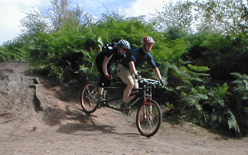

A Turner tandem based on a Burner V-2 with a DH rocker, built for Interbike 1997.

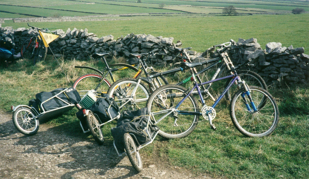

In the middle, towing a BOB trailer at Spring Polaris, 2000, in the Peak District*.

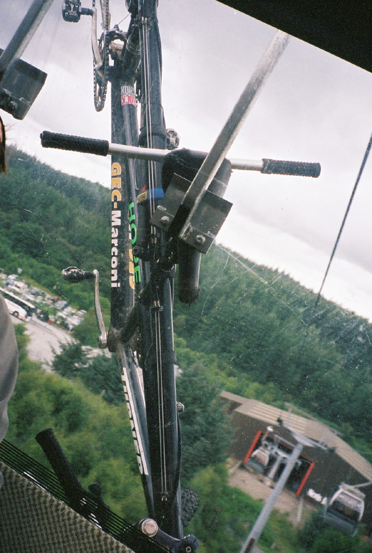

And finally, on the chairlift at Fort William, ready to do the 2001 DH course:

As displayed at Interbike 1997 it had Mr Dirt upside down forks, Magura HS11 brakes, Hugi rear wheel with DH rims, Titanium BBs.
It destroyed the rear wheel (flatted the rim, chewed the hub body to pieces) and the Magura HS-11s were pants - you could sinter the pads on a good descent.
It was refitted with early model Boxxers, which meant that we could fit Hope C2 calipers and big discs on Bulb hubs. The rear hub always runs a BOB trailer compatible skewer.
The BB spindles got bent hitting a log at a NEMBA downhill at Richmond, N.Yorks. It now runs sensible BBs. Spot singlespeed rings handle the timing chain.
The Alps 4R has chewed itself up internally and it now runs a Fox RP3.
Even if I still had the parts to rebuild it to show spec I wouldn't because it's more usable this way.

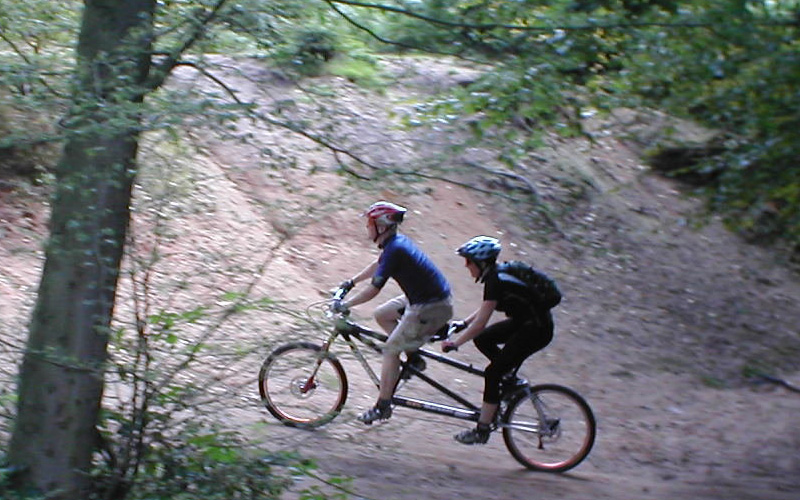

Sheffield 1997 in Wharncliffe woods gave it away. There were two tandems, us and Guy Kesteven on his Collela. The race organisers set us off as the first two bikes fo the day and we could hear exactly how far behind the other tandem was by the cheering that was reaching us coming down the hill.
Here's the Collela being ridden XC at Eston. Uncle Peter as captain, Uncle Nick as stoker.
And there's air under those wheels.
