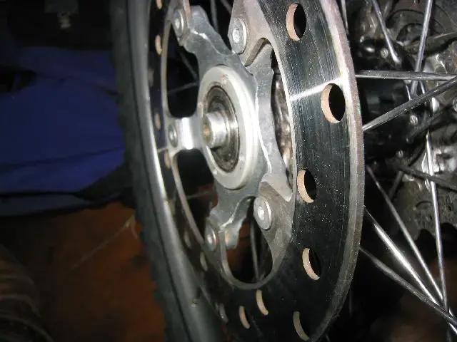

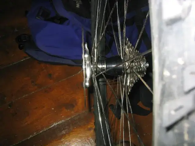

I just bought a rear wheel with hope Ti hub and when I went to fit it I discovered the dropouts didn't meet the axle. If you look at the photos the axle is recessed behind the line of the disk rotor - it would need to be another 15mm at a guess for the dropout to sit on it nicely.

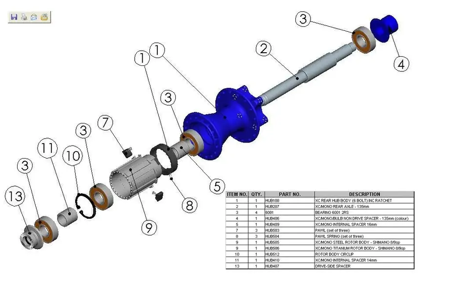

What am I missing here? What's going on? Is there a spacer I didn't get or what? It's going onto a standard MTB dropout (135mm?) - normal anyway. I've also attached Hope's bulb diagram which must be similar - do you think I am missing Item 4 (The non-drive spacer)?

Looks like your axle is the one specific to the universal disc adapter mount. The hub axle sat in it and the adapter then bolted on to the drop out and canti mount so that you could mount a disc on a non disc frame. The only way around it is to replace the axle with a full length and add a new alloy collar on the non drive side.

Assuming hope still do the parts it shouldn't be too pricey, but it is a faff if you haven't got the bearing drifts and stuff. May be worth having a word with a big hope dealer like merlin or chainreaction for spares (or hope themselves) if you want to do it yourself or your LBS to have it all done for you. I'd have a word with the seller as they aren't really an upgrade as you can't use them in their current state without the axle change
