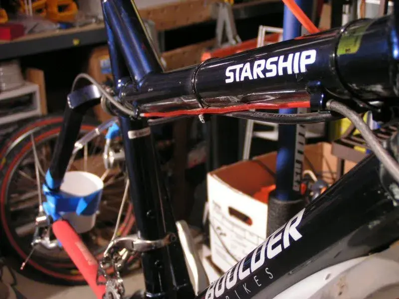

File comment: The Boulder on the work stand in the pit of my basement

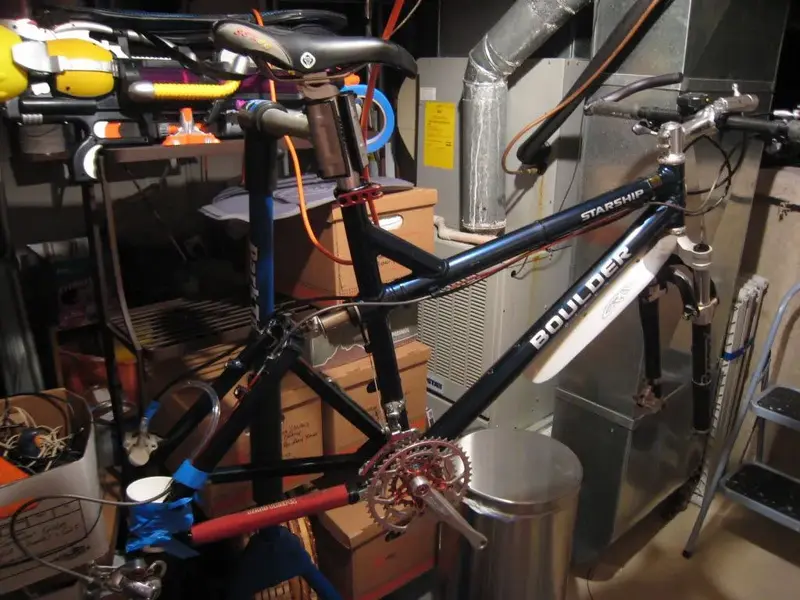

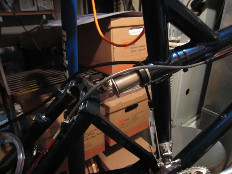

File comment: I still love this shock design. So clean and yes that is still the original O ring on it even after 10 years.

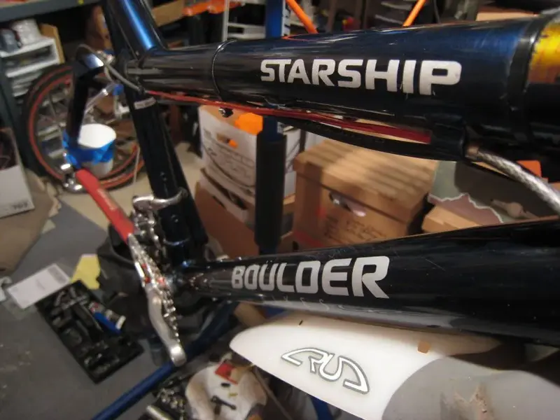

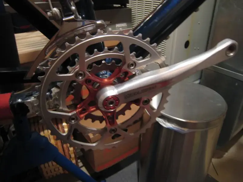

File comment: Middleburn cranks and Royce BB. Unfortunately the frame has seen some major chainsuck over the years.

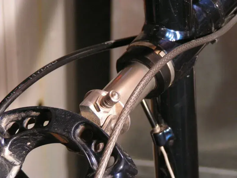

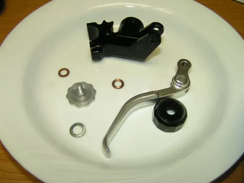

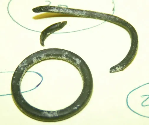

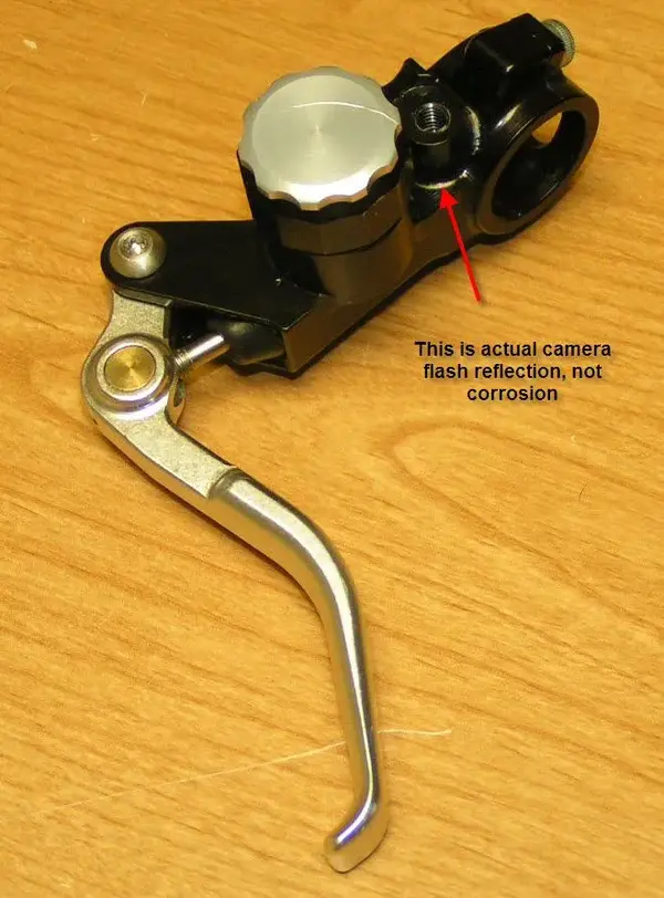

Okay, I have overhauled the faulty brake lever. I have to say, that reinstalling the master piston was a nightmare. Hope have changed the secondary seal design from '99 to '08 and it has a stronger spring (or mine weakened over the years).
You have to insert the piston pressing against the force of the spring until the second seal jams. Then while pushing against the spring to stop the piston popping out, you need to help seat the seal (I used a fine screwdriver) which allows you to push the piston all the way in. Next you have to push the washer all the way down into base of the cylinder (you did put the washer on right? No, then you have to do this all again...)
Next, you have to get the spring clip in, and seat this with spring clip pliers all the time while holding down the piston to stop the spring from popping it out.
Suffice to say, I could have done with 2 pairs of hands working in a space of about 1 sq.cm. I think it took me about 10 goes but I finally got it together.
I was going to overhaul the other one lever as well, but that works for now, so perhaps I won't given how difficult it was to get this one back together.
Does anyone have tips for inserting a master piston into a closed hope lever that is easier than the method I did?
File comment: The reassembled level.
File comment: These are the only parts that I am keeping plus a couple of bolts (not shown). All the internals will be new.

File comment: The remains of the piston seal that cause the adjuster to jam up.

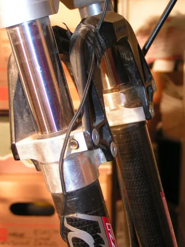

This weekend, I intend to strip and clean up the Pace Forks. I'm gonna gradually get this thing cleaner...
The forks by the way were converted down from 100mm to 80mm travel to fit the geometry of the Boulder.
