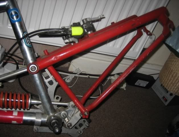

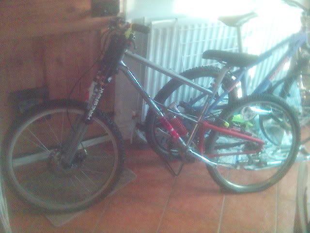

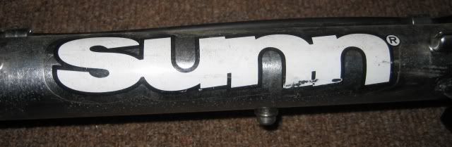

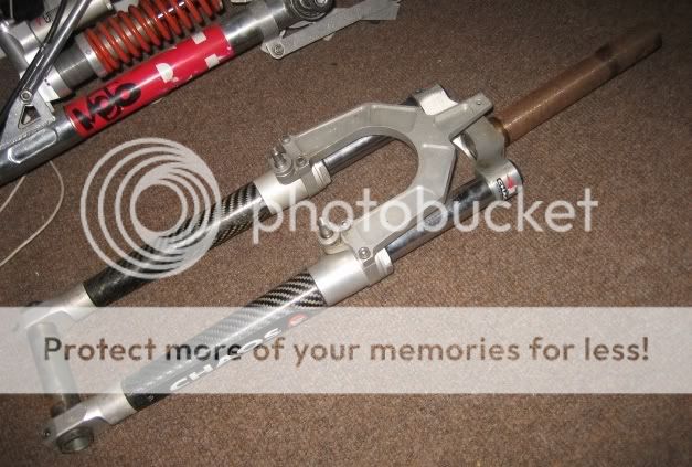

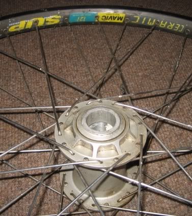

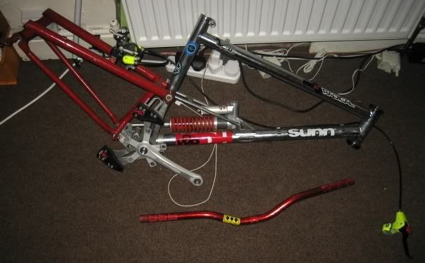

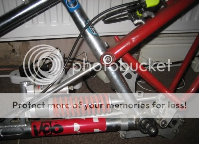

Well finally I have it again and here are some pictures of how I found the bike at my parents place over Christmas. So much to do to get this bike tip-top again.
And now it is partially stripped.
The Radical 2 frame and Chaos rear shock.

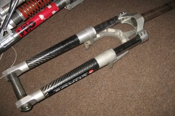

Sunn Chaos forks

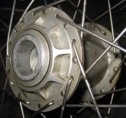

Massive Sunn front hub with 25mm through axle

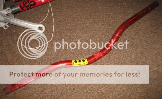

Sunn DH bars, I have the brace but it's not pictured

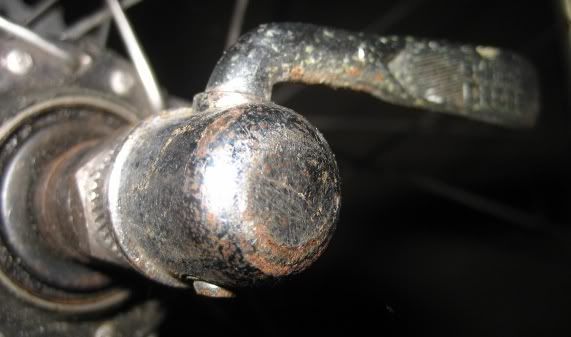

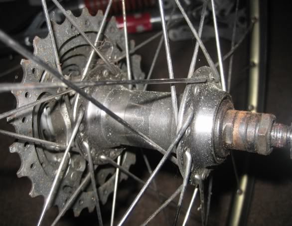

Also, have I found the rear XT M737 hub I require on the rear of the bike? Can anyone identify this hub, it's missing its sticker and rubber seal?
If it is the right one, are these the right quick releases to go with this hub?
