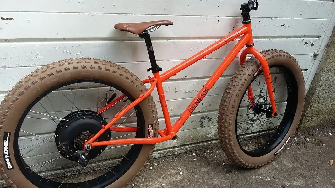

well, I thought this may be a giggle!
...and if it all goes horribly wrong I'll just stick a normal back wheel on it :roll:

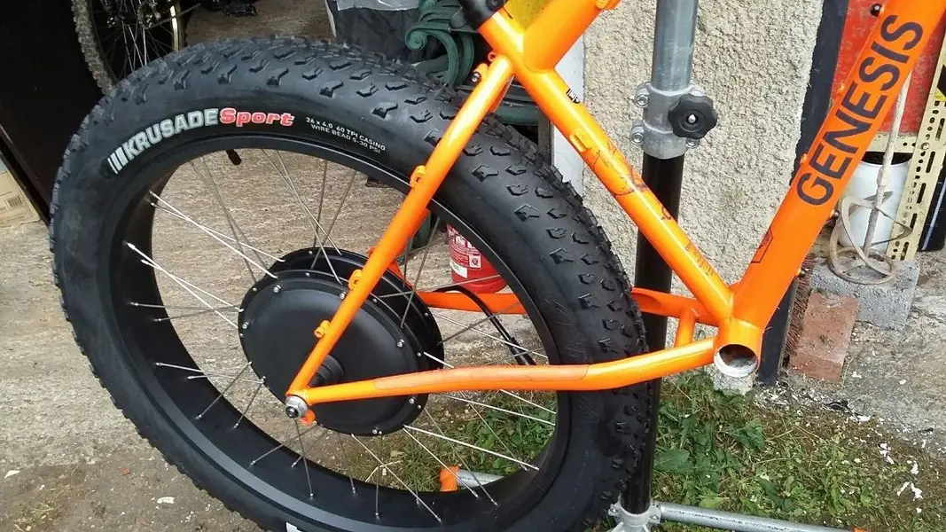

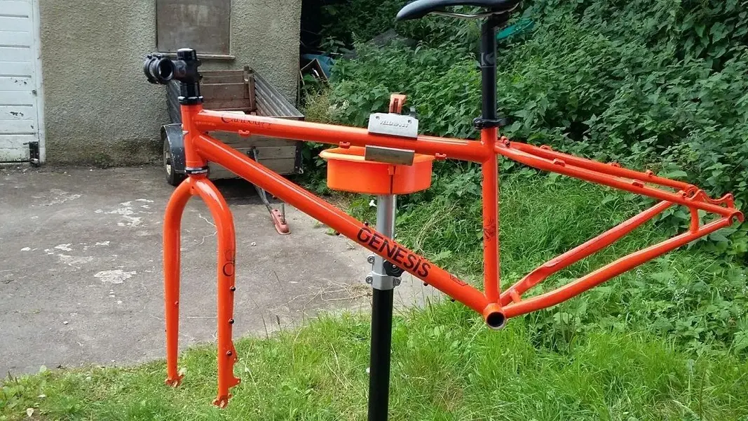

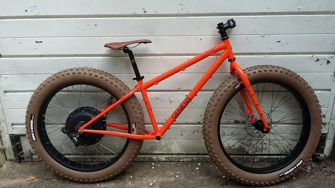

Photo 1 - frame as I got it.
Photo 2 - Cheap arse work stand couldn't take the weight :LOL:

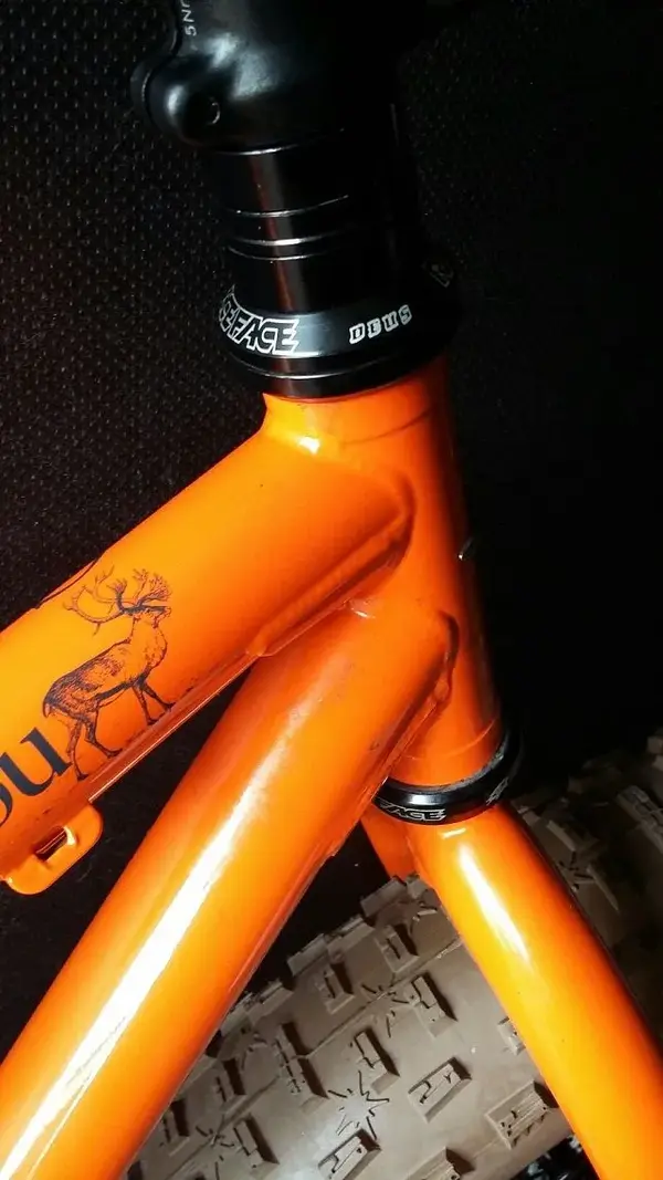

Photo 3 - Changed the headset from FSA to Race Face
Photo 4 - Race Face cranks

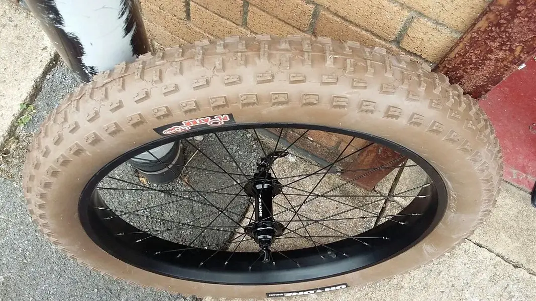

Photo 5 - Front wheel and tyres from the deals at On One website
Photos 6 & 7 - So far...

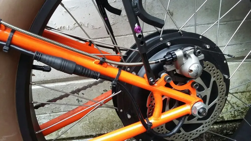

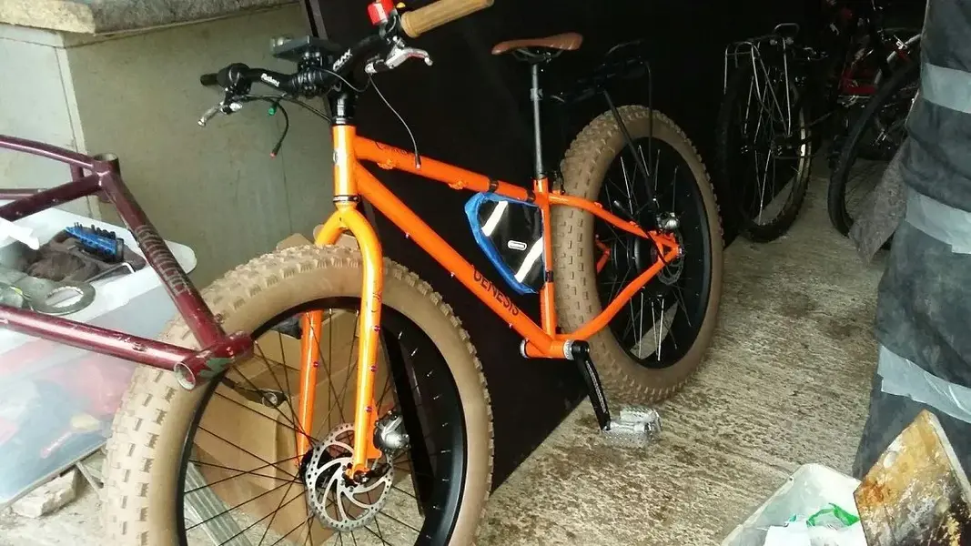

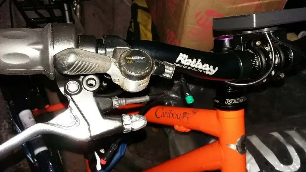

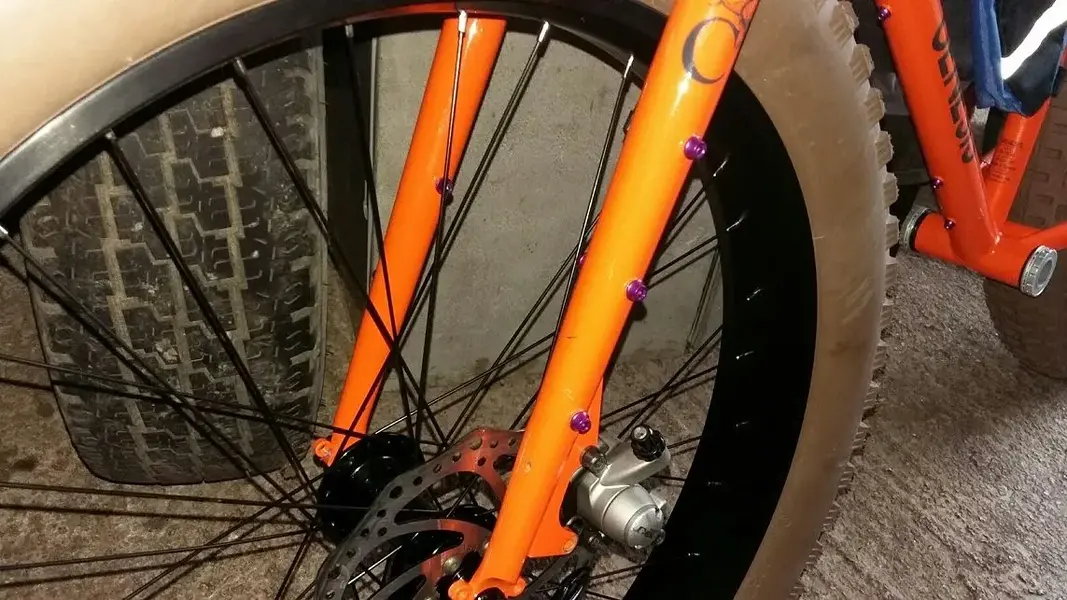

1. I bought some purple bolts and 2nd hand Deore cable pull calipers. I've got to use cable pull calipers as the supplied brake levers have a cut out to the motor. I've still either got to fit a 160mm disc or change the mount.
2. Bell fitted - safety first!

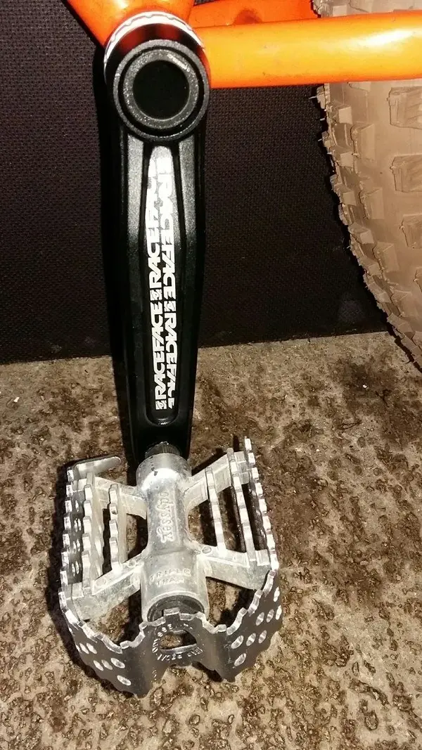

3. Odyssey Triple Trap pedals fitted - bit of retro. The BB is going to have to come off again so I can fit the pedal assisted system sensor and order a front chainring.

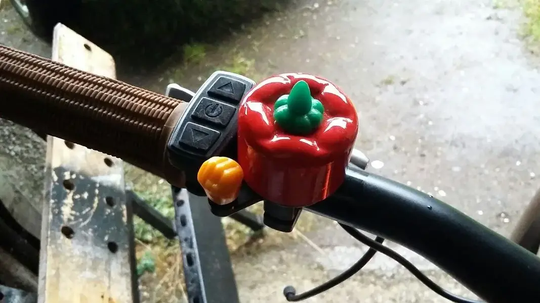

4. XT thumbie fitted. I tried a couple of different RF+ shifters but they wouldn't have worked with the twist grip throttle (anyways screw on rear block is 7 speed). Also purple top cap, speedo monitor and suitably named handle bar.

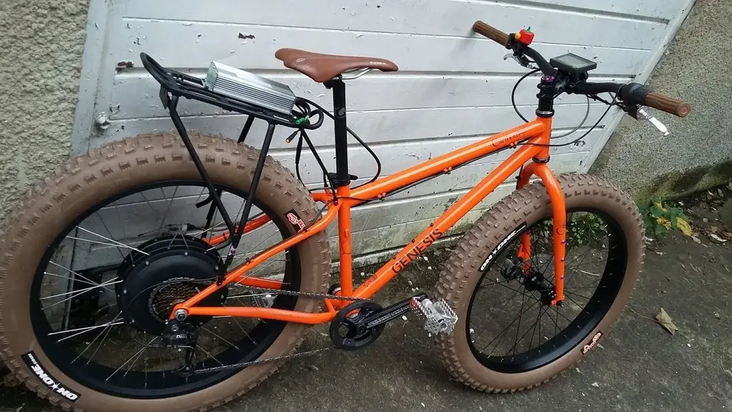

5. So far picky - rack fitted for battery pack (edit - change of plan, rack now for lunch).
Weight so far approx 22kg :shock:

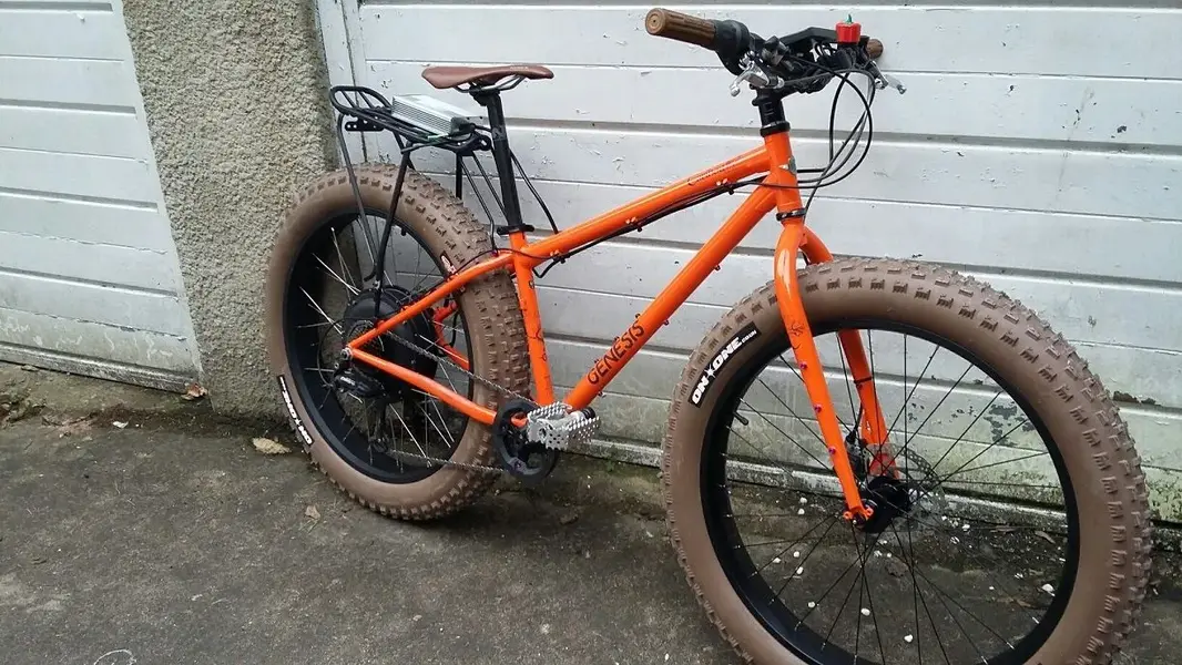

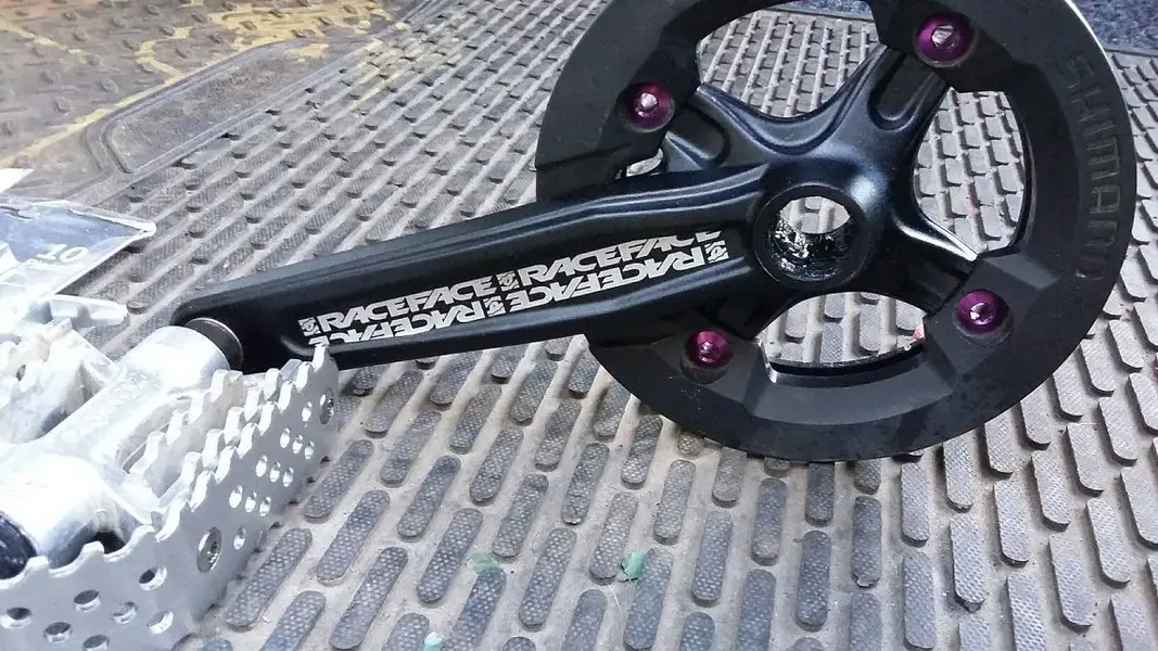

Got the ring and guard fitted today. Didn't do owt else as I was working on other 2 bikes :)

Quick update ➡️
I've just ordered a 48v 17ah battery that'll fit in the main triangle (help to get the weight forward), an RSP chain tensioner (was tempted to fit a DCD) and a fat copy of a crud catcher.
Once wired up I'll bag up that control unit and get it out the way.
Hopefully it'll be running in a couple of weekends :xmas-big-grin:
