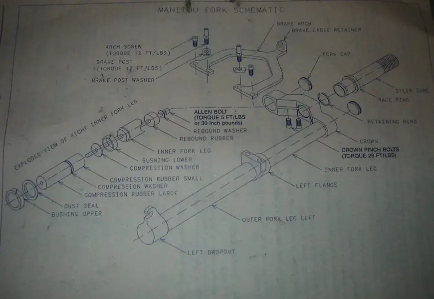

Does anyone know which order the elastomers/washers go back in on Mani 1's?
Taken apart for a service prior to fitting to the Chance and I wanted to make sure they went back together correctly.
I've got the following (per leg):
1x Long elastomer (3")
1x Short elastomer (less than 1")
2x Washers
When it came apart it seems as though the order was:
Large elastomer / washer / small elastomer / washer
If anyone has a manual for these that would be great (searched the interweb to no avail)

large on top , washer , small on bottom , washer
PostPosted: Mon Jun 16, 2008 12:21 pm
retrobike rider / Gold Trader
Joined: Tue Nov 14, 2006 2:27 pm
Posts: 2751
Location: In the Woods. . .
Nope, from the bottom of the stanchion down, there has to be a washer first, as this pushes the lower bush back in place. Small elastoner, washer, large elastomer. You can swap the elastomers around, except the small one on the bottom is hard to keep in place on reassembly that way, but it offers no functional advantage.
:wink:

OOPS , my memory is getting worse
checked manual and elite is correct :wink:

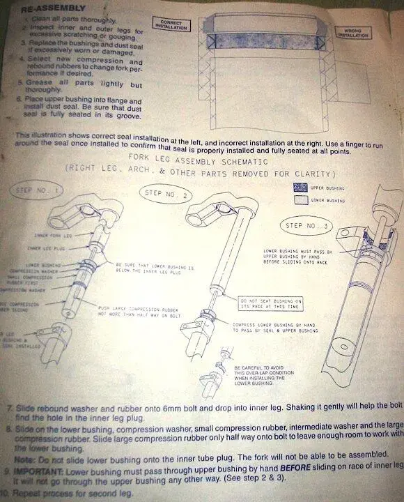

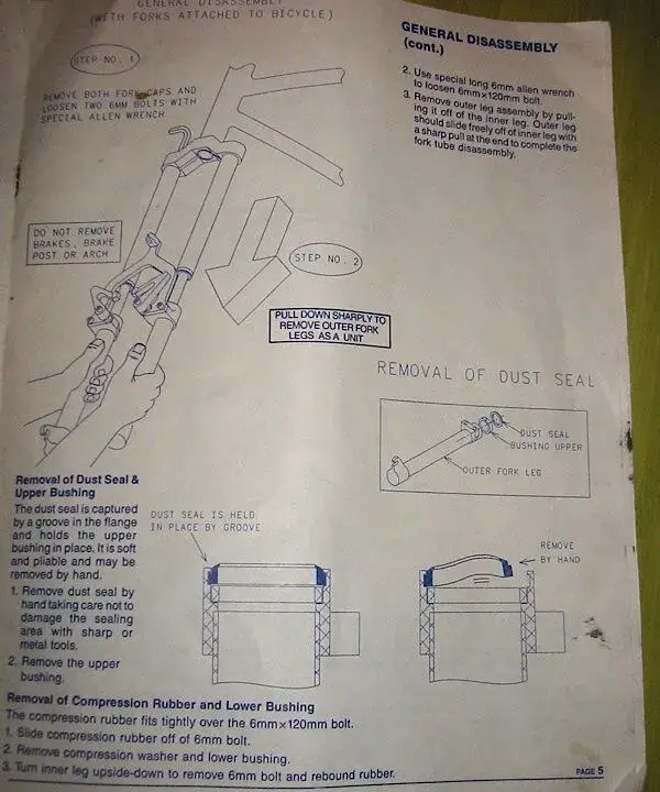

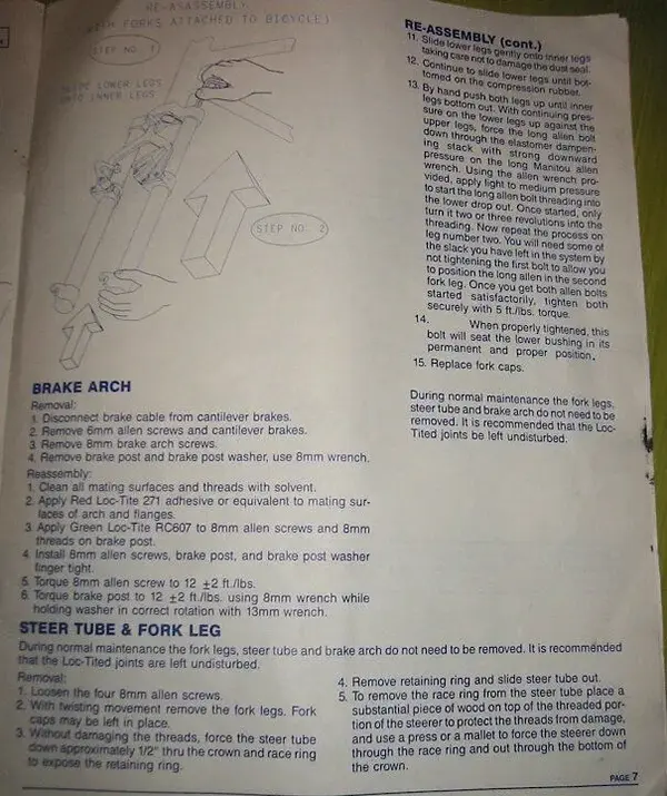

Here ya go. If you need larger, I can email. Cheers.
