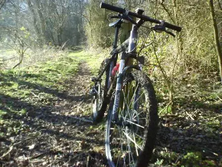

Rock Shox Tora on my Avalanche are the business. Fully adjustable U Turn ride height and lock out facility.
Lovely 8)
