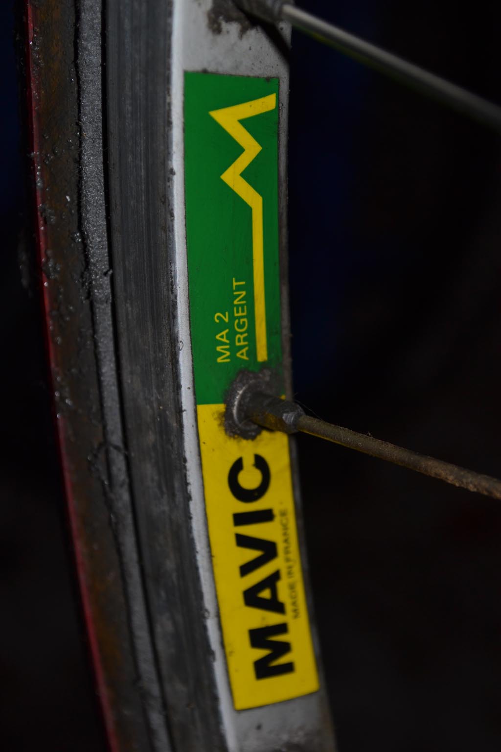

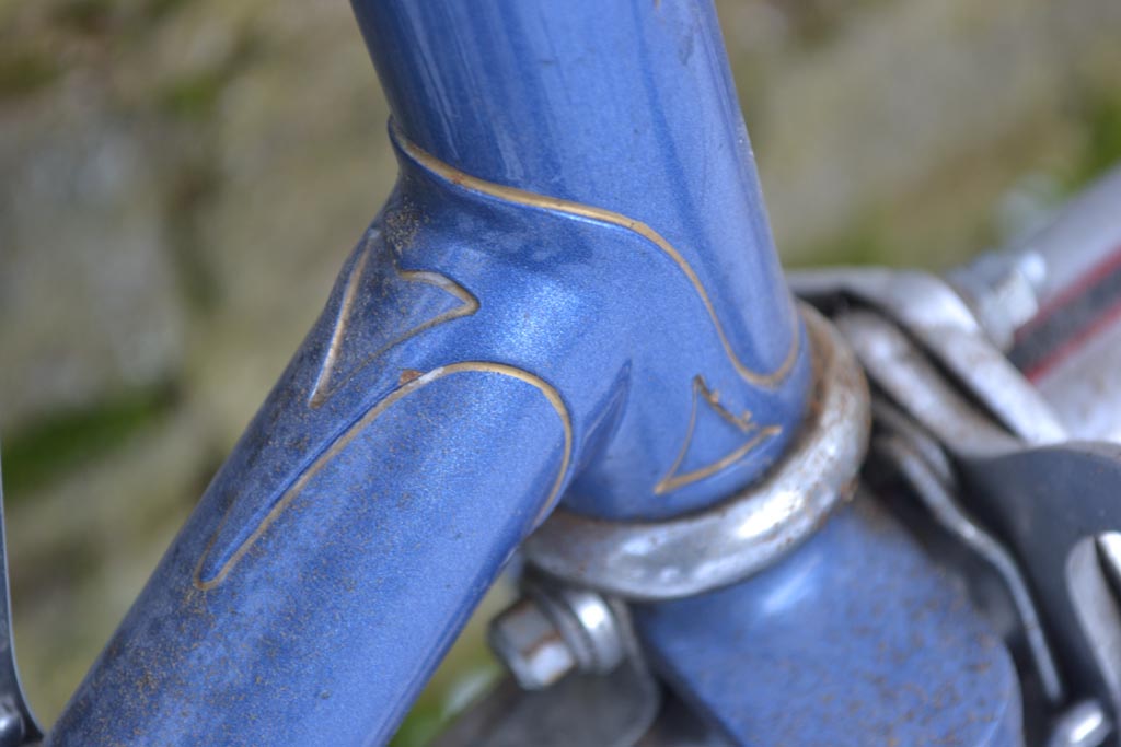

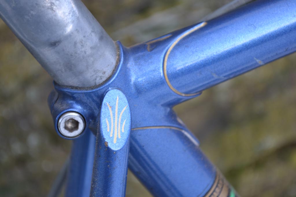

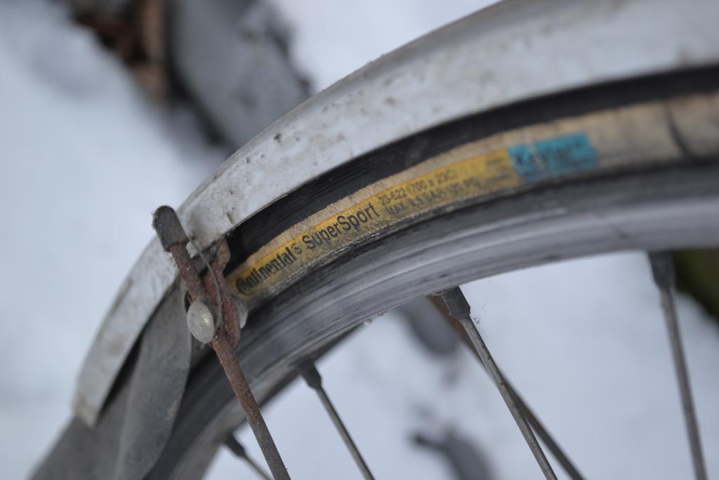

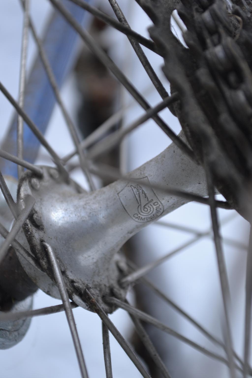

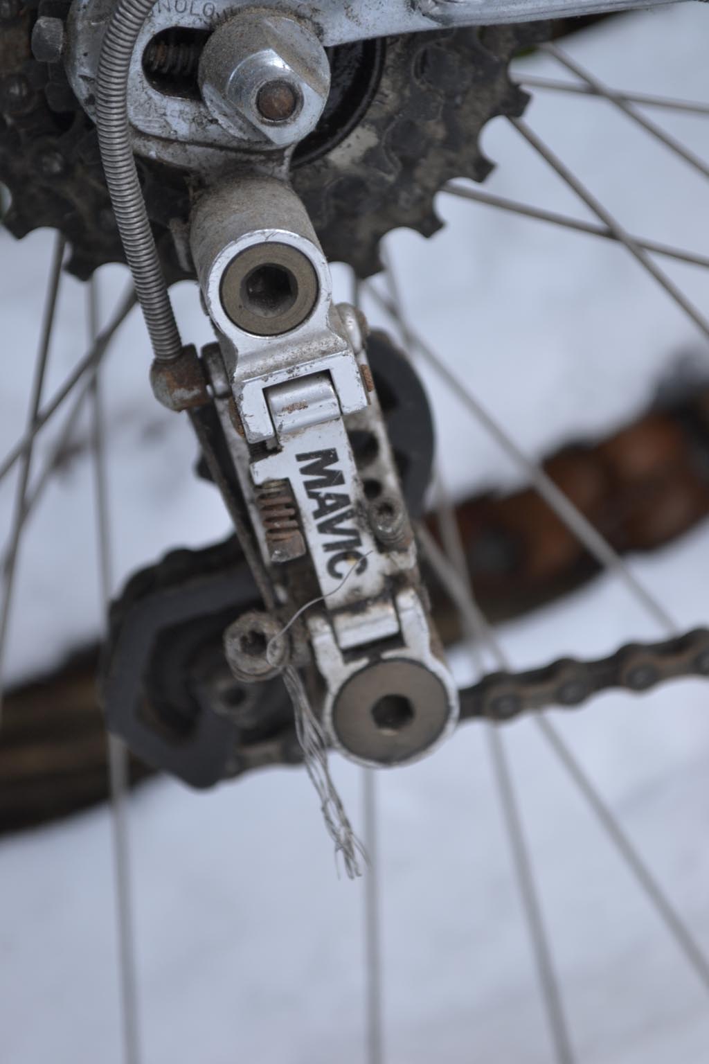

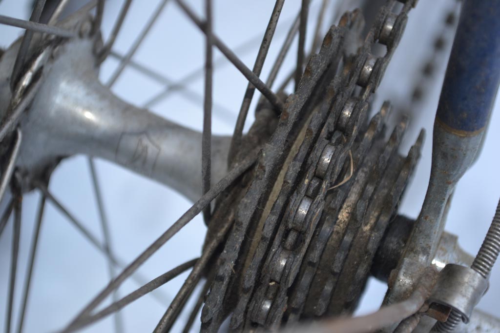

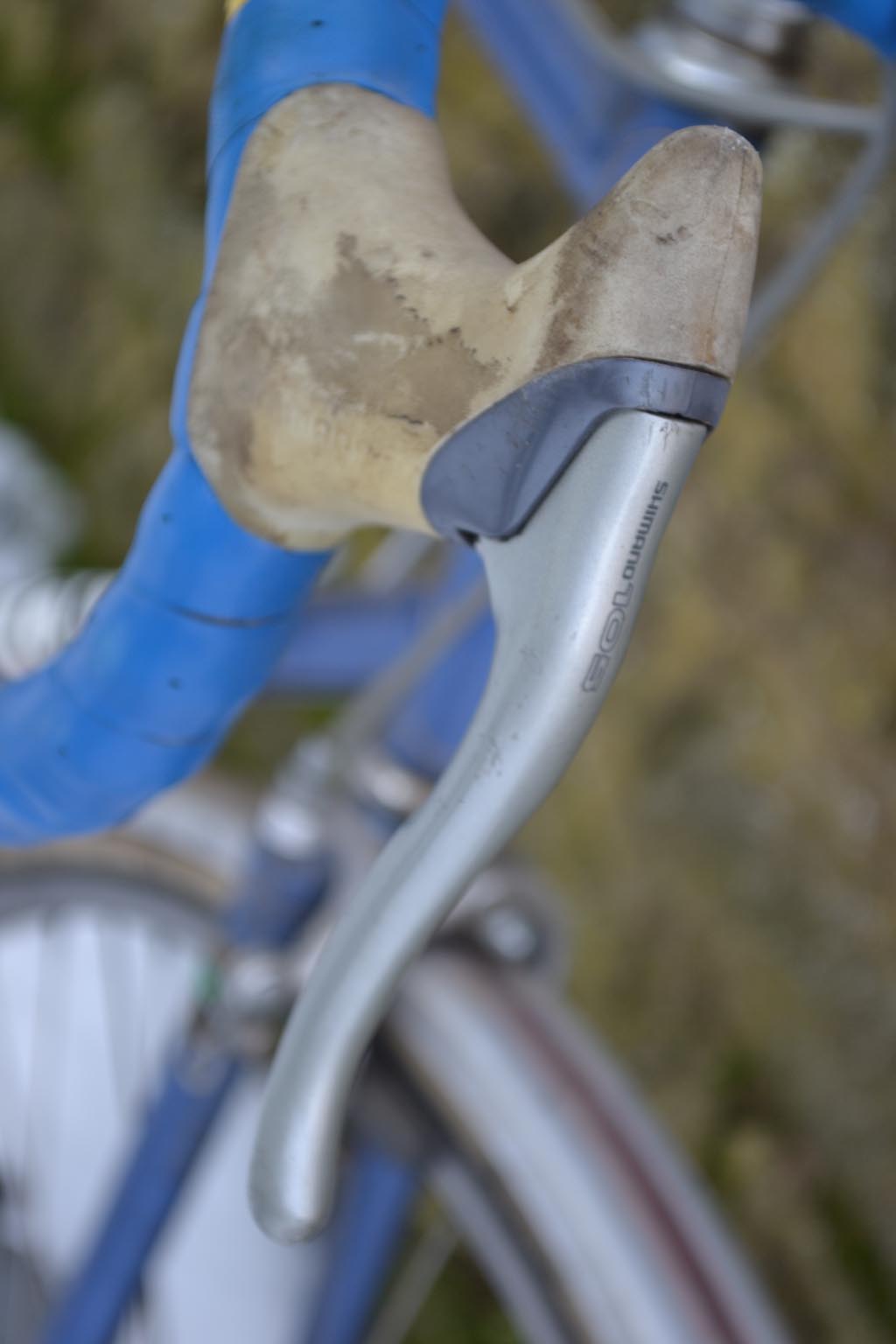

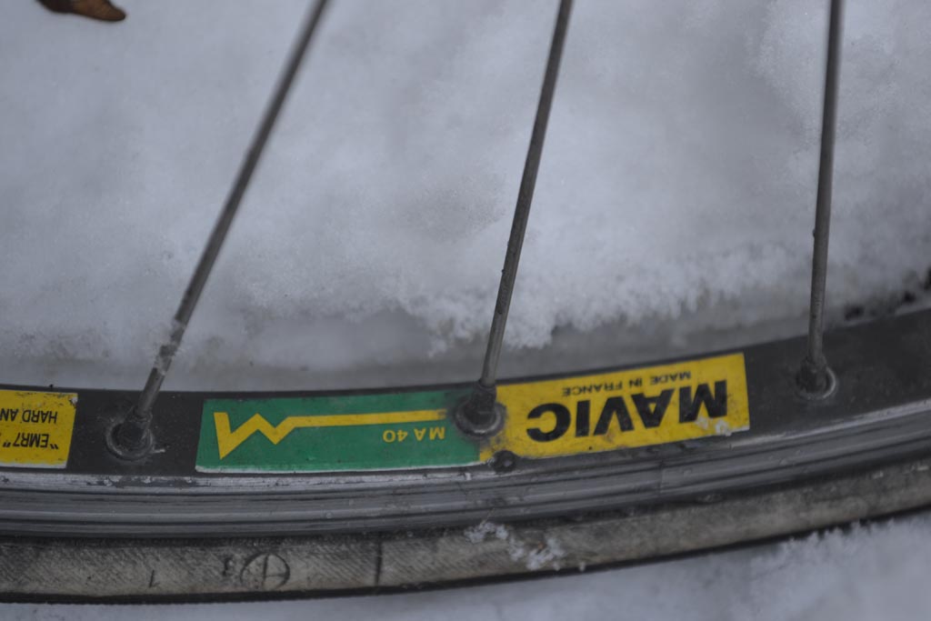

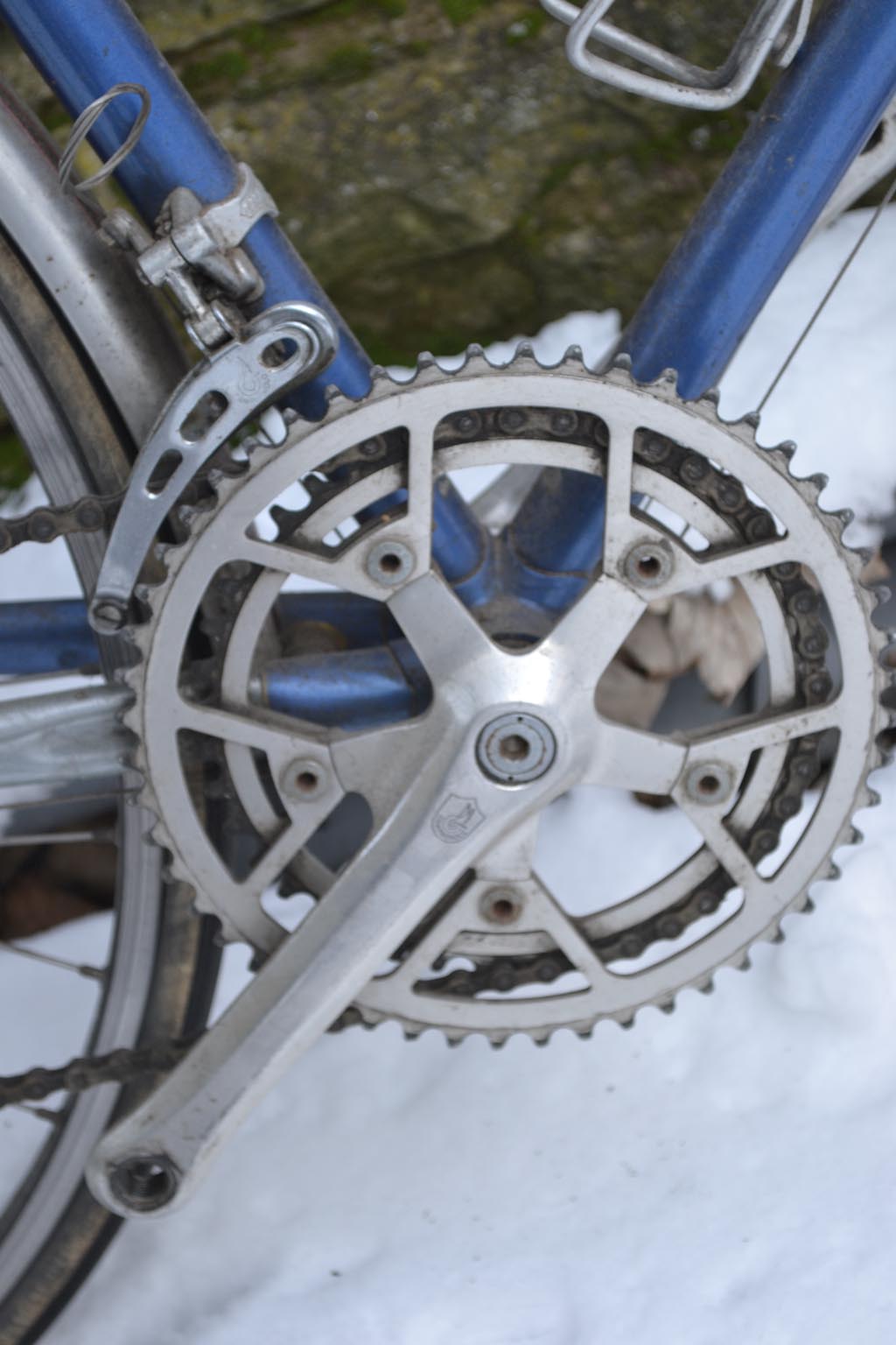

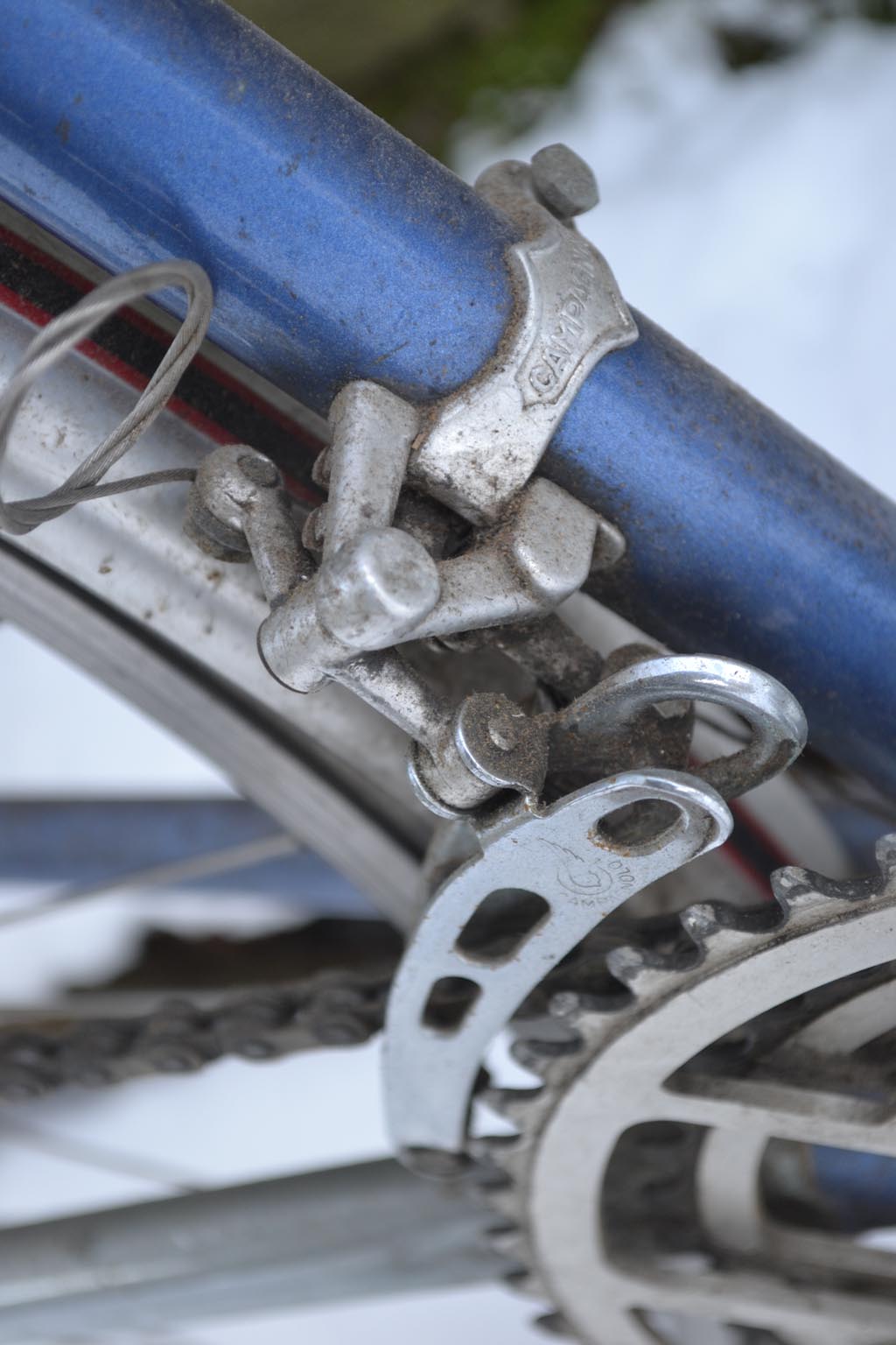

I picked up three bikes during a garage clearout this morning and I'd really like to find out more about them.

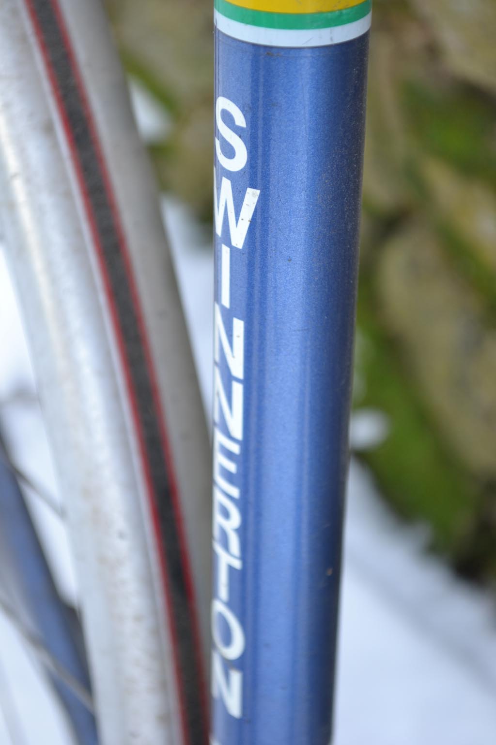

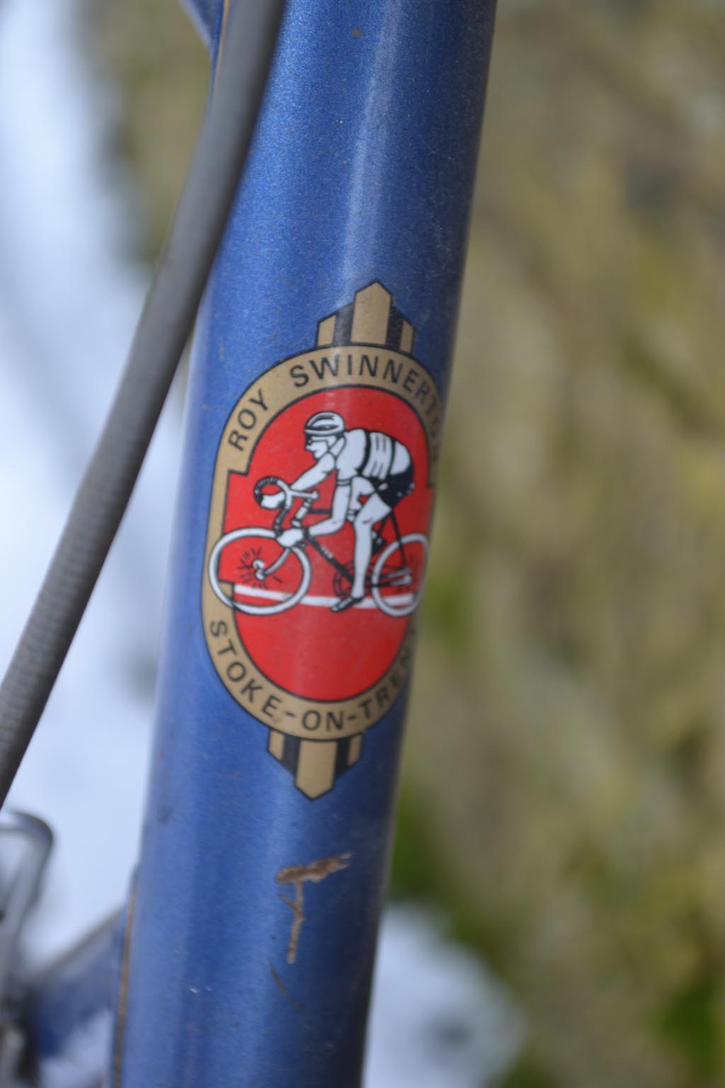

The second one is this Swinnerton.

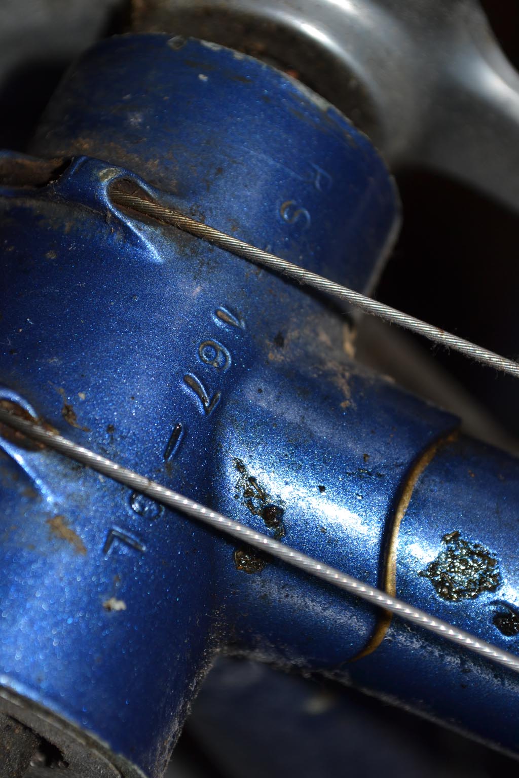

The owner reckons this was built around the late 80s or early 90s. The frame number is RS - 167 - GL, which I assume denotes Roy Swinnerton and Graham Longstaff who built frames under the Swinnerton brand.
It'd good to confirm this and I'd like to know what year it would've been built...
Again I'm not sure how many of the components are original or period correct due to the paucity of my road bike knowledge.
I'd really appreciate as much information as possible about this bike and the components.
Thanks in advance...

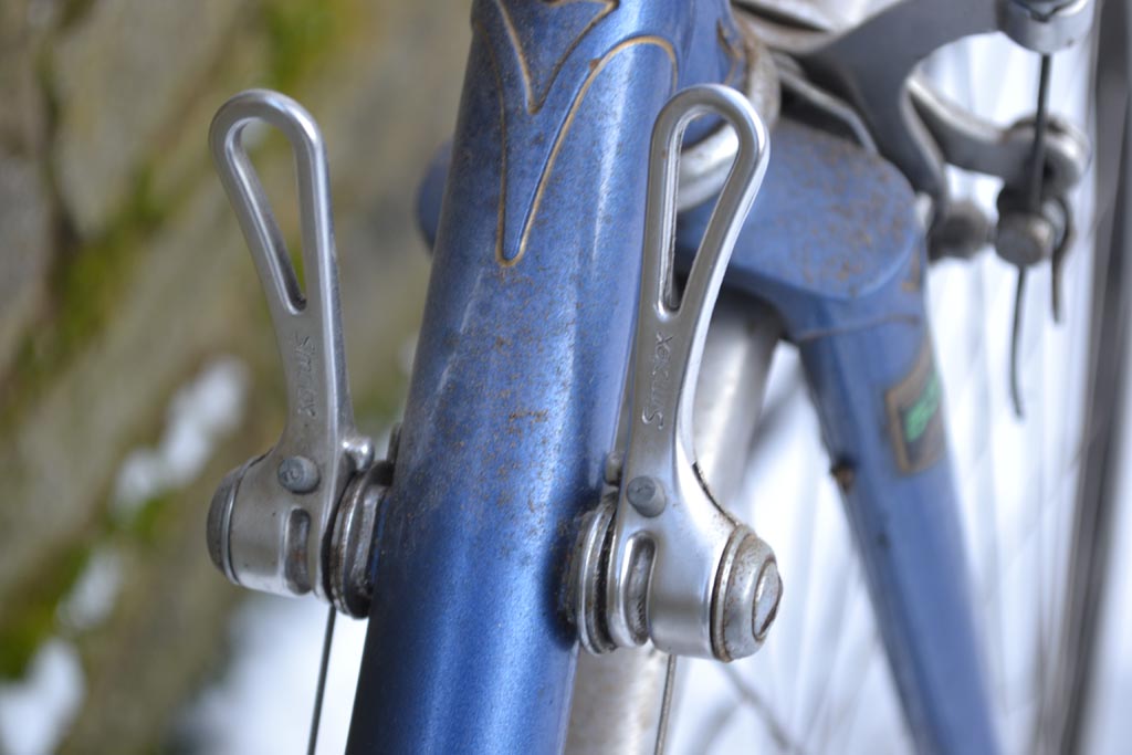

Campagnolo Victory or Triomphe chainset (I forget which is which), mavic mechs, Campagnolo Nuovo Record f.mech? Frame looks mid eighties again but definitely a parts bin special. Simplex Retrofriction shifters - very nice and super smooth, one of the best friction levers I've used.
What I used to find around my way was a lot of club bikes built out of hand me down parts - and this looks a classic, later parts on an earlier frame as bit wore out or were acquired.

Yep, ball scratching rear cable run over the top tube and under BB guides marks it out as an 80's frame. Some nice bits typical of a club bike upgraded over the years, either bought bits new or hand-me-down from richer riders selling their used kit on..........

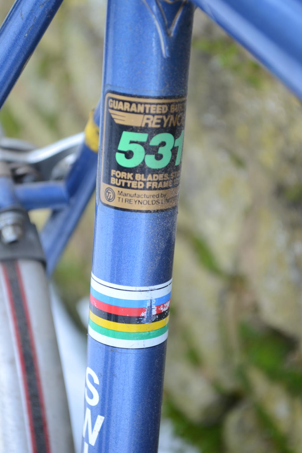

Looking at the Reynolds 531 logo I'd say early to mid-eighties: http://www.hlloydcycles.com/531%20history.pdf
BITD you tended not to buy a complete groupset, but buy bits and pieces and use what you already had off your previous best bike. That's why many older frames can be a bit of a Heinz 57 component wise.
