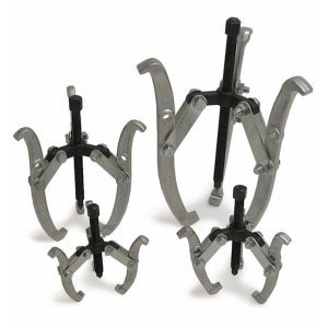

To get the crank off you need one of these widely availble tools:
If you're okay to go with something just to get you on the road then a tange passage headset has a very low stack height or I have a steel headset that would look the part (think its Japanese too though) I could sell for not too much money.

With regards the crank, you might have some luck with a TA puller. I believe those are 23mm. I've been after one for awhile. Alternativley, you could get a duel-sided one (22mm + 23mm) from 'Var'. Spacycles stock them at £20ish.
Where did you get that puller from Tel? I have a stripped crank that might be in need of one of them.

I'm having bespoke extractor done in few weeks for free (if everything will go ok) so I'll wait for it. But thanks for advice - bearings puller could do the job, I may actually need it in the end.. Did you actually use it to remove a crank?

I've used one of those bearing pullers on cranks a few times and they are OK as long as you are careful. In fact it's the only way I've ever removed my TA cranks because I'm too mean to buy the proper extractor!
Yes many times, it's my fail safe. Removes the crank without causing any damage so providing you have one you can still use chainsets with dodgy threads.
