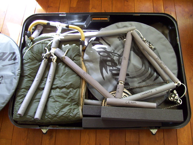

I couldn't get the bike I initially planned for l'eroica ready, so with one week left there followed a chance of plans.
So dear people, I present you my...
'Strada bianche' ! :D

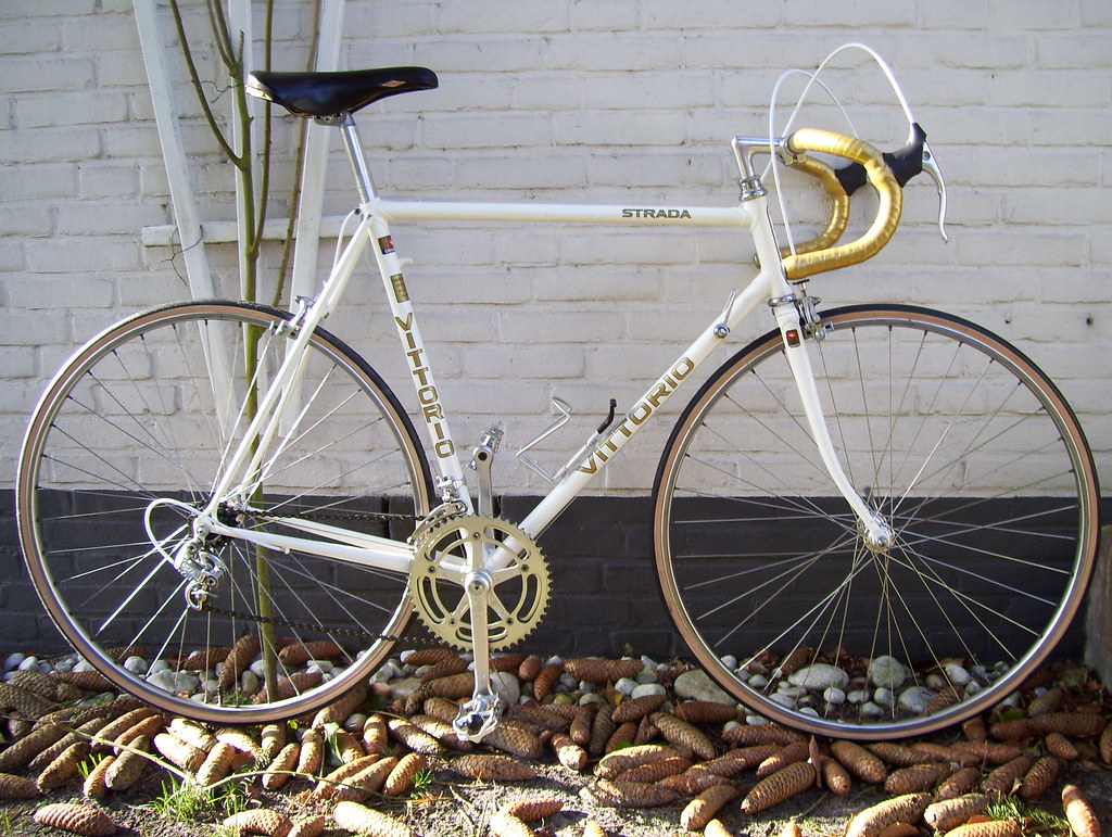

The Vittorio Strada before:

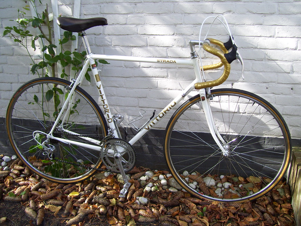

The Vittorio Strada with the l'eroica specific modifications:

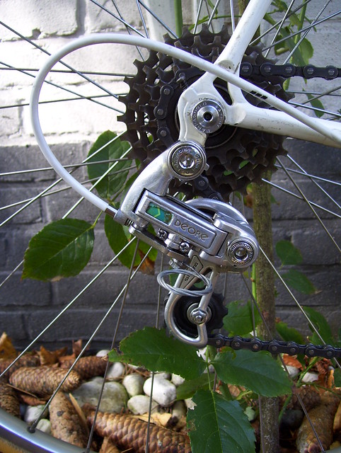

Low-land freewheel replaced by one with substantailly larger cogs. One 'hatch-plate' derailleur made place for another: Dura-Ace EX went for early Deore:

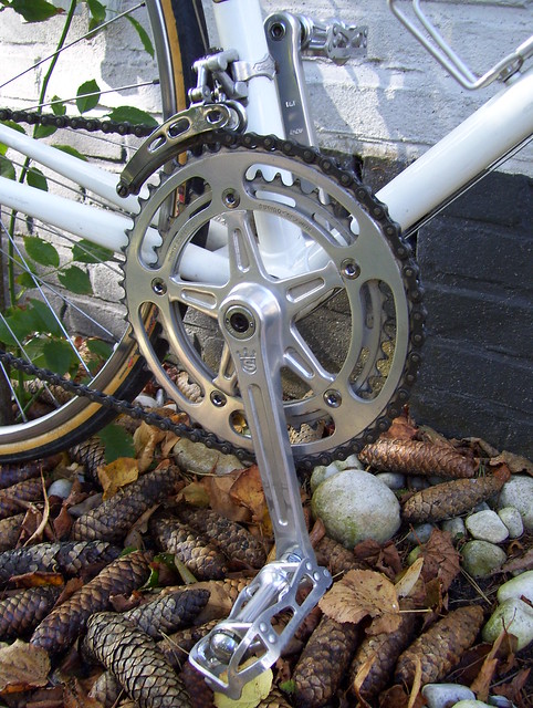

Campagnolo chainset replaced for Suginos with smaller ring. Handy one key release bolts:

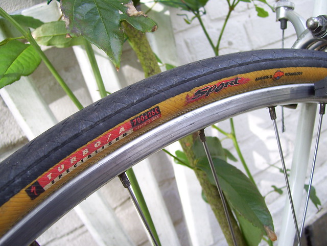

The Avocet 25mm tires weren't really 25mm. Hopefully the 26mm Specialized tires with 'Armadillo technology' will offer more comfort and snake bite resistance on the poor 'Strade Bianche' roadsurface:

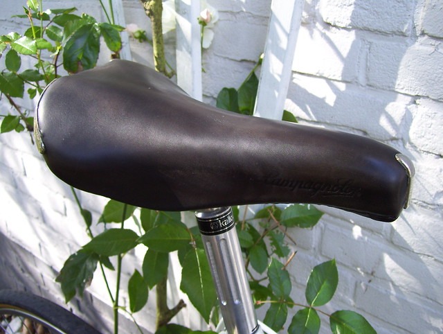

Campagnolo Electa seat. I like it. Of course I won't forget to let the air out in transport... (plane) :
Some additional parts and some extra padding has to be put in the box and I am ready to leave:
Happy :)

Have you tried the Campagnolo airbag saddle in this type of situation before,
or is this an experiment? Does it work?
