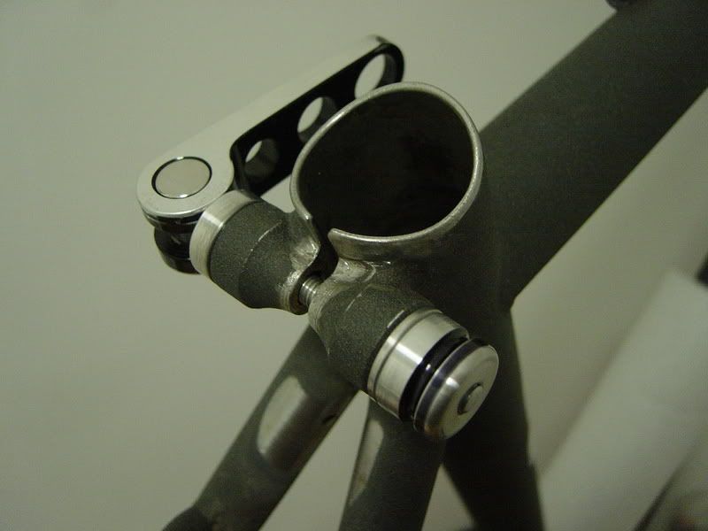

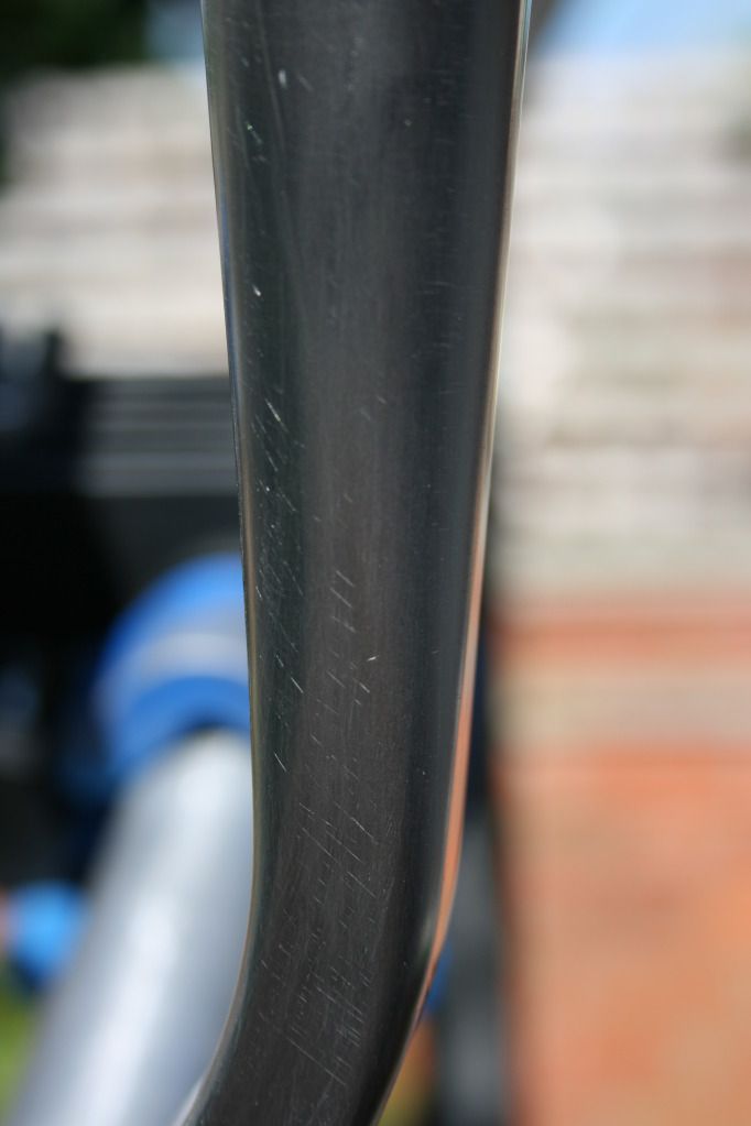

Aluminium Frame polishing project going well so far.
I'm using Wet & Dry paper to create a finish on this frame ready to polish up (autosol) afterwards. No lacquering or paint. I'm after a high quality mirror finish and quite I'm happy to invest time and elbow grease into this but I want it to be an effective technique too!
I've started with an 800 grade W&D paper and will progress to finer and finer grades- up to 1600 I think.
The key question I have is when to move onto the next grade of w&d?
I'm removing the scratches and minor dings with this first 800 grade paper and am now at the stage where there are very fine scratches-almost like a wood grain- remaining..
[img][img]http://i1248.photobucket.com/albums/hh488/saulusmaximus/Klein%20Pulse%20Comp/chainstays001.jpg[/img]
Shall I leave them and move onto the next grade paper or persist with the 800 grade w&d?
or get it like this, or better before the next grade?:
[/img]Image
Another Q I have is as to which way to 'finish' the tubes before applying polish: Do I rub lengthways along a tube or crossways around it? Either way has a very different effect.
I'm enjoying the fruits of my labours. It was covered in scratches in the paint and the decals were all b*ggared when I bought it but now I'm at this stage and I have some decals from gil_m :)
Thanks for reading.

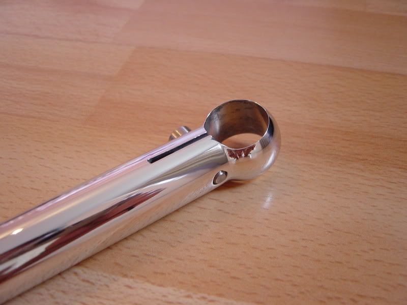

I haven't polished anything for ages, but when I did (back in my apprentiship days, when every piece you made had to be mirror polished), the key was to always keep the workpiece wet, and only move to the next grade of paper when the one you're using is making bigger scratches than the ones youre trying to remove.
The direction really doesn't matter, since as the grades get finer the effect you see is reduced until you've finally blasted it with autosol and achieved the mirror image you are after.
Rather than elbow grease alone, why not invest in a polishing mop and a series of ever finer polishes? A dremel with a small polishing wheel will get into the corners and the welds as well. Only thing to remember is not to let the metal get to hot, or you'll discolour it.

I've never contemplated tackling the polishing of a frame, but when I do cranks and the like, I always start with a lower grade paper, such as 320grit to really remove the deeper gouges... 8)
When you're doing it my hand, you'll feel the metal surface start to feel 'smooth' through the paper, and this is the point to move onto the next grade (normally 600grit for me) and repeat this until the next stage (800grit) and so on - right up to 1200/1600grit.
As has already been said, keep the surface and paper as wet as you can (have a bucket full of water by your side, and dip into it constantly) and you may find that when you get to the Autosol stage, you may need to polish again with your finest grade paper and then re-autosol, and sand/autosol many times before you get a finish you're happy with.
Once it's done, you'll need a good sealing wax (car products are pretty good for this) that are more like gels, than creams. This will prolong the life of your finish.
But to contradict all of that, as has been said before, you'll get a better finish with a machine. 8)

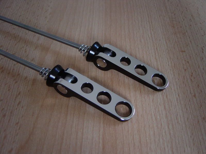

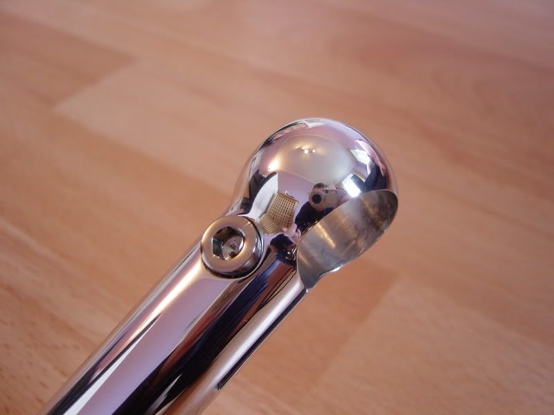

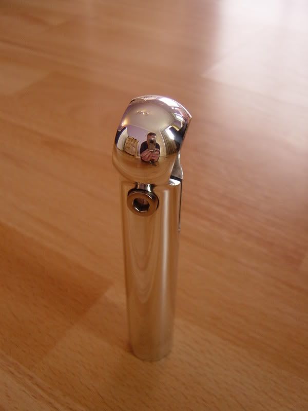

First things first – I am no expert on it but with patience you can manage most things !  :lol:
I was actually after some of those pedals until I saw how much they went for second hand and then I decided on SPD’s.
If I got some my original plan was to :
• remove the cages
• Polish the bodies by hand
• Flat off any big scratches on the cages by hand
• Get the cages re (hard) anodized in satin black
This would have meant losing the white lettering (but that wouldn’t have bothered me) but got me something that looked almost new. The only give away would have been the missing logos and on close inspection – some marks under the anodizing.
I defo wouldn’t want to mirror polish the cages by hand as I think that would be a lot of work due to the complex shapes and holes etc  :shock:
I have polished anodizing off by hand but its hard work and that has only been on basic shapes …
If you do choose to have a go use a rougher grade of paper but switch to a much lighter grade as soon as the anodizing starts to thin / fade so as not to mark the soft ally. I used 600’s (this can be got from B&Q) to break though the anodizing.
I know you can remove it chemically (saw a thread on the forum) but I have never tried it and don’t know how easy it would be to polish up the etched surface.
The bodies would be dead easy to polish – an hour max per body – sat in front of the TV  8)
Looking at your picture I would go straight in with the NXT polish (from a good car shop for about £8. Any light scuffs / gouges should be removed with wet n dry. I favor 1500’s or 2000’s (about 30p per sheet from a car body paint suppliers) as even though it feels like paper it works very quickly when used wet on bare ally and the matt finish it leaves polishes up very quickly with the NXT.
As a guide I cut the sand paper into small pieces (1” x 2”) for curved shapes as it seems to go further that way and I would estimate 1 piece max per pedal body. If I use bigger pieces I just seem to waste it  :lol:  Use it dry and it will clog very quickly rendering it useless  :(
In my experience a course grade will work quicker but you spend longer overall trying to polish out the marks that it leaves – Some of the pictures on the forum (NOTE FROM WD TO MOUSEMAT – There was a thread on some BMX pedals that had been done – they looked really good) have obviously been done by a professional with the right equipment to quickly remove the initial sanding marks  :wink:
A standard green 3M kitchen pad will also leave a nice matt even finish if that’s what you are after.
If you look on my Marin thread the x lite caps are the finish the 2000’s leaves when used wet. They were done on the kitchen work surface – clean the top (no Crumbs !  :lol: ) wet the top – Stick a full sheet of paper down – worked wet and just rubbed the cap in straight lines until the anodizing, logos & scratches had completely gone. Probably about 20 mins per cap. Leaves a lovely black residue to clean up …
The X lite bar ends were done under the tap, small pieces of wet n dry and finished with a 3m pad. They took much longer to do as I had to get through the anodizing first. Seemed like longer but probably 1 hour, maybe 1.5 per item.

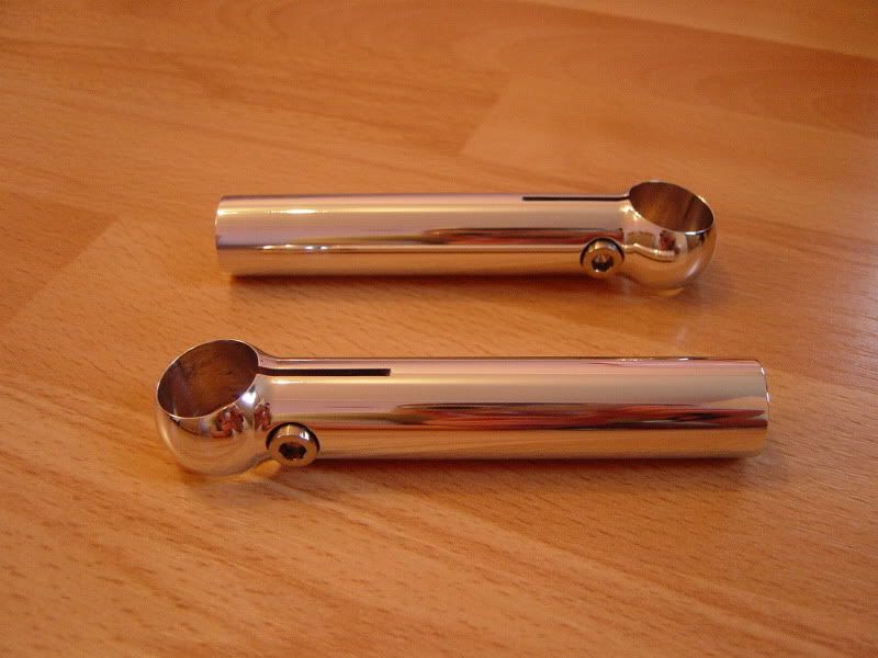

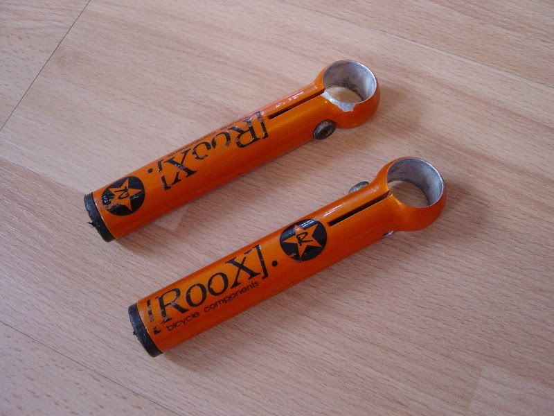

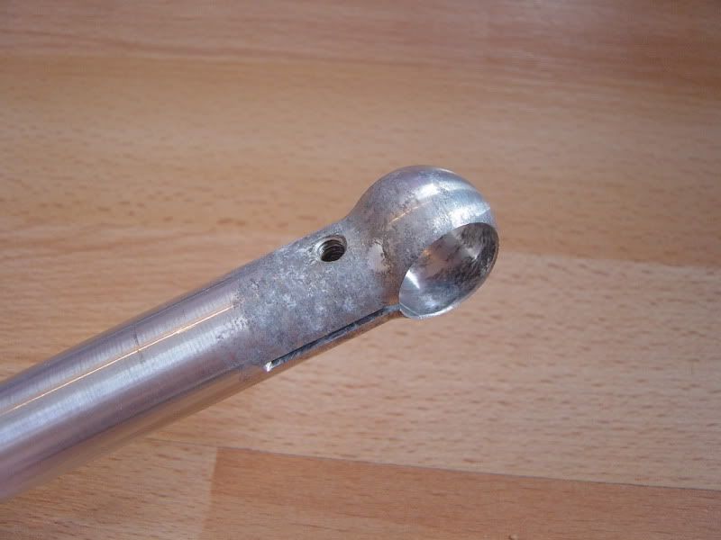

WD Pro wrote:
From page 3 of the ProFlex build :
WD Pro wrote:
Thanks for the comment :-)
Well ‘elite504’ came up trumps with a new faceplate for the Ringle  8)  he also supplied a new clamp assembly (as I found a crack in the old when cleaning it up  :( ) and a set of instructions so I have the correct tightening torques for the rebuild. All cleaned and ready for ano  :
I was looking around for some bar ends and came across these RooX items from ‘Jamis Diablo’ :
I know nothing about RooX (are they any good ?) but they caught my eye as their appearance / construction suggested they were made from billet and machined to shape (rather than having any bonded or welded joints etc). I figured any company that went to that extent must be making a quality product ?  :?

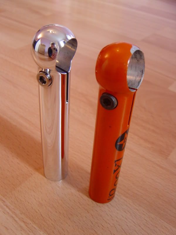

Anyhow, once the paint came off there was good news and bad. Good = one piece CNC’d construction  :D  Bad = corrosion due to no surface prep / bonding of the original paint …  :(
A bit of patience, elbow grease, wet n dry and NXT came to the rescue though quite nicely :-) Added a polished Ti bolt :
Old v new :
Both finished :
The end plugs will be some blingy carbon jobbies I have spotted on eBay to match the stem top cap  :oops:  The problem is, I am not sure what to do with these, leave polished or ano with the other stuff …  ?
A couple of arty farty shots now, I should title these “WD’s Workshop – View From A RooX” :lol: :lol:
WD :-)

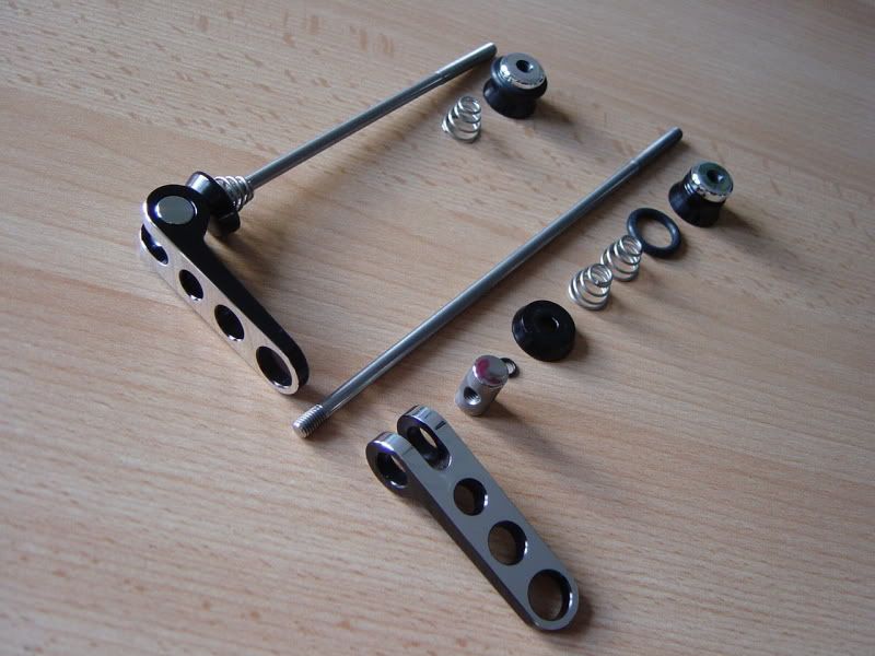

WD Pro wrote:
From page 14 of the Marin build :
WD Pro wrote:
fingers wrote:
Amazing...
The brazing work tooks top draw, excellent job!
Thank you, the best work I have done on it that no one will see  :cry:   :lol:

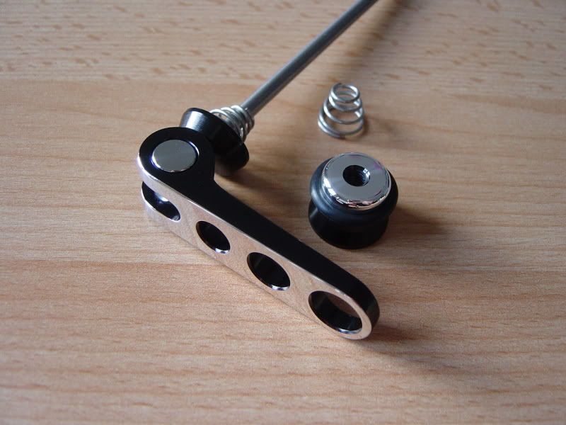

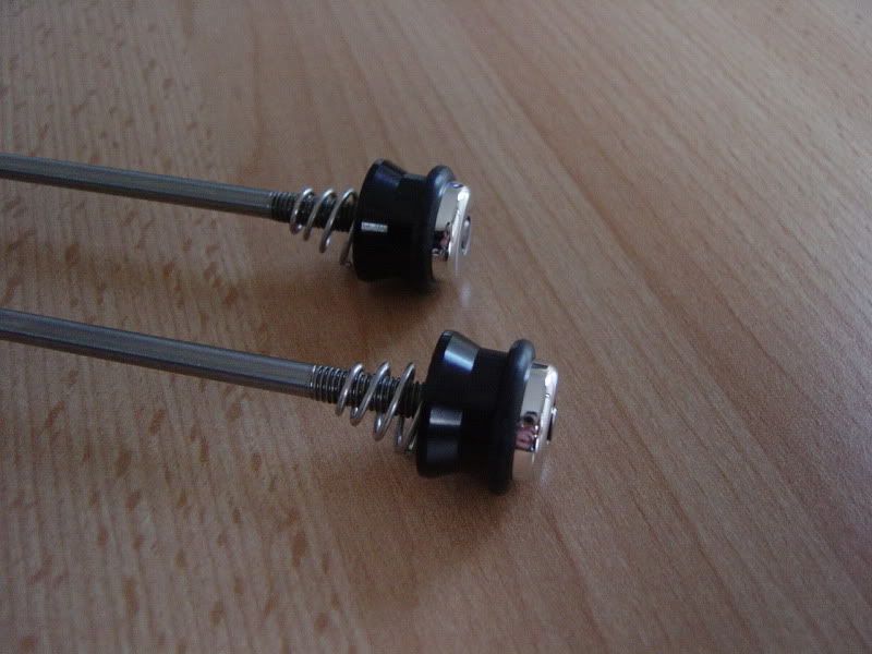

Well sorting through the bits to build it up (itching to get the forks back :lol:), I was reminded about the QR’s which had a bit of a story …
I originally had Ringle holeys (silver) on the wheels and these were striped, cleaned up and sent for black (hard) ano with other bits, unfortunately though they ‘suffered’ a little with hidden corrosion (mentioned way up this thread somewhere) which was highlighted by the re-anodisation process. Two of the three levers were good but one leaver and the nuts / washers didn’t look pretty enough for me to put on the build. The new bits I made for the seat came up really good :
And are defo on the build to stay but I ended up with a new set of USE ti spin sticks on the wheels  :?
I had been keeping my eye out for a wheel set of ringles to complete the look of the Marin but didn’t have much joy. They would need to be in black A1 condition so I could use them ‘as is’ or another colour in A1 condition so I could get them re-anodised in black again without fear of the same problems as last time  :?  Also I didn’t want to pay for another batch of ano until all the bits off the ProFlex are ready to go so I could get it all done at once.
I don’t know why I didn’t think of it earlier but Mum’s orange had come to the rescue with the temporary loan of the USE ti post - and it also had black ringles … 8) Dad (who really owns mums bike :lol:) spotted the brand new spin stixs and actually wanted them to keep so the deal was done and I ended up with a ‘pretty good but not mint’ set of black ss holeys 8)
Should I clean them up ready for ano or should I use them as is until I can get them done with the ProFlex bits ? hhmmm, well my impatience got the better of me and I went to work with the wet n dry to remove a few scratches to go down the ano route :lol:
Looking at the first one part way through the process got me thinking, I could really bling them up without having to go through the cost and delay of fresh ano ;-) A few hours later and I was pretty pleased with myself 8)
Black / polished alloy, new Ti rods (bought for £4 off here ages ago on the off chance that they may come in useful :lol:) – chopped to perfect lengths and polished ends, polished barrels and new O rings :
They are now assembled and loctited. I think they will actually be easy maintenance – If I scratch them (so long as I don’t take a chunk out of them) I can just strip, flat and re-polish as all the vulnerable parts are now silver / bare alloy anyway – Its seems a win / win situation all round as they actually suit the build better to !
I am now looking out for one black holey in good condition (doesn’t matter if it’s a seat or wheel QR) – I can flat / polish the lever to use on the seat QR and this would give me two good levers in full black hard ano to use elsewhere / keep as spares / possible sell etc.
Just the rear derailleur to assemble (its all in bits) and spruce up now, shouldn’t take long - if I can remember how to put the springs and o rings back … :lol:
WD  :D
