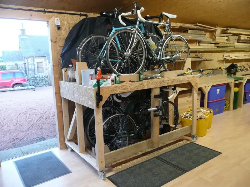

Hi Tel, if your fettling skills extend to 4x2, MDF, OSB and castors you could knock up one of these to hold n+1=7.....or bigger.
Frame is roughly 4 foot by 4 foot by 7 foot long, with the castors locked and against the wall it's as rigid as a frozen stoat.
Needs a bit of space in front to wheel out over the ones underneath but a good area on the front for a bike holding clamp, wheels are hooks in the ceiling as close as possible, remove skewers and if a high ceiling an "S" hook and one under the other.
And yes, I know about the OCD.

Good idea. You could have raked the gravel first though, couldn't you?

Wow! That is some workshop. I wouldn't have the skill to do that or the space!
