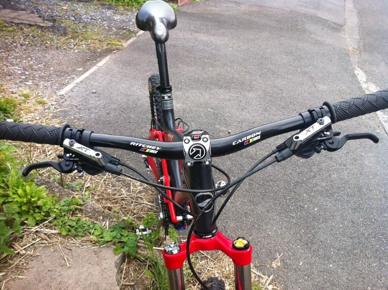

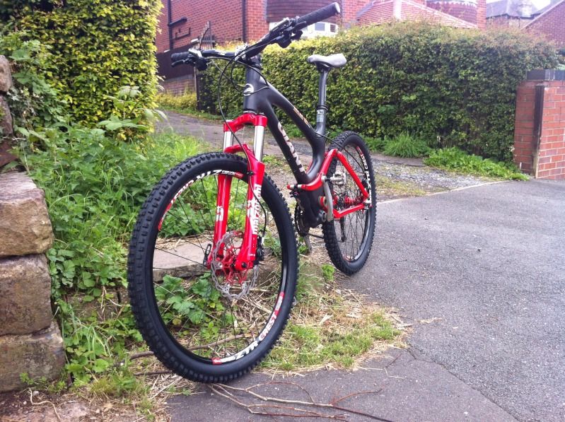

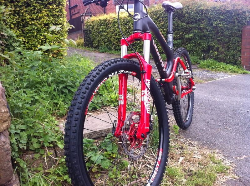

Frame: Giant MCM980 Carbon Fibre
Fork: Marzocchi 4X
Rear Shock: Rock Shox Monarch RT3
Headset: Ritchey 1 1/8 WCS
Stem: Atherton Pro 50mm Downhill Stem
Handlebar: Ritchey WCS Carbon Fibre over sized
Grips: ODI X-Treme Lock-On
Brakes: Shimano XT M785 disc brakes 203mm front floating disc, 160mm rear floating disc
Shifters: Shimano XT M739
Front Derailleur: XT M738
Rear Derailleur: XT M739
Cassette: XT M737
Cranks: LX M569
Bottom Bracket: Shimano BB-UN72
Hub Skewers: Marzocchi QR15 Front and Hope Rear
Rims: Stans ZTR Crest Tubeless
Hubs: Hope Pro Evo 2
Spokes: DT Competition
Tyres: Maxxis Minion 2.35 DHF 42A compound, Minion 2.35 DHR 60A compound
Tubes: Tubeless
Saddle: Selle Royal Eclipse Carbon
Seatpost: Syncros FL Carbon
Great job you've done there, it looks just as good as the new ones I use to build back in '97
Thanks for the positive feedback guys. I thought i would have been committing a sin on this site modernising a retro bike.
To answer a few questions;
It rides very nice and i feel confident on it. Due to the short stem and wider bars i feel as though my weight distribution is not now over the front end so makes it better when going fast down steeper hills, no sudden surprises that threaten to chuck you over the front.
The front 203 disc brake pretty much stops the bike with the slightest of touches. This is taking some getting used to as it was only 6 months ago i was still using canti's on the fisher and V's on this :shock:
I was very lucky when i got the bike as it was pretty much a museum piece and had not much use at all. I still have the original tyres that came off it and they show little wear. They guy i brought it from had two bikes and this one was his garage queen and was only brought out on 'special occasions'.
The rear shock is a revelation and fantastic compared to the old coupe deluxe. It is nice that you can change the rebound + it is lighter. It also allows you to stiffen it up on the fly but with the rear linkages the way they are it does not bob much when pedalling anyway - this is one area i still need to play with though.
Also since these pictures were taken i have managed to remove the VBrake bosses - thay just screwed out and have cable tied the rear brake hose into the boss hole to stop it bouncing into the tyre. I also now have a red rear hope QR in place of the black one.
