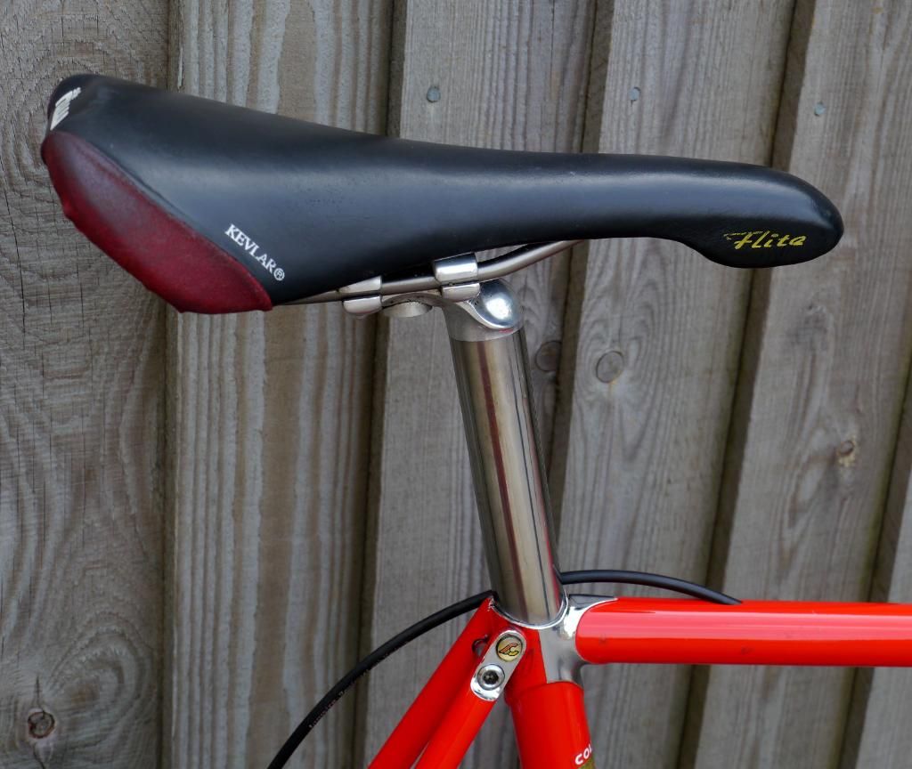

The ' foot long' MTB carbon seat post has long gone , replaced by a Campag Record Titanium post .

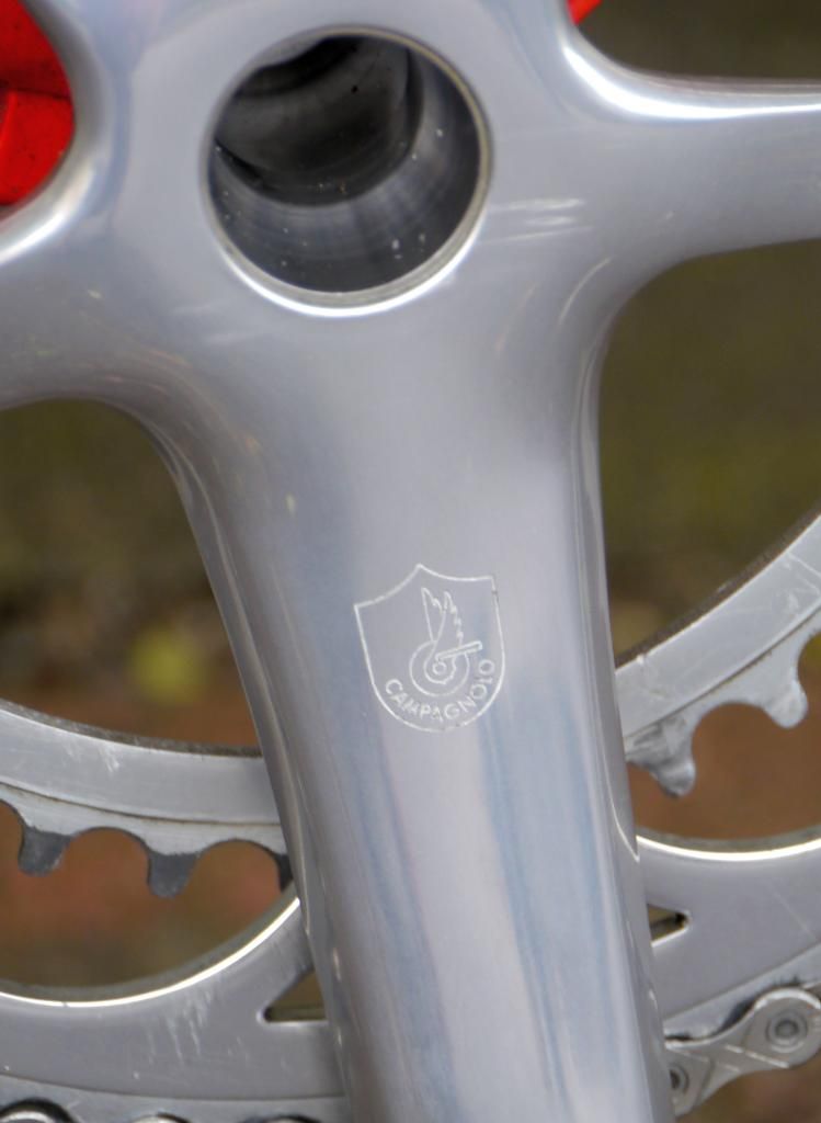

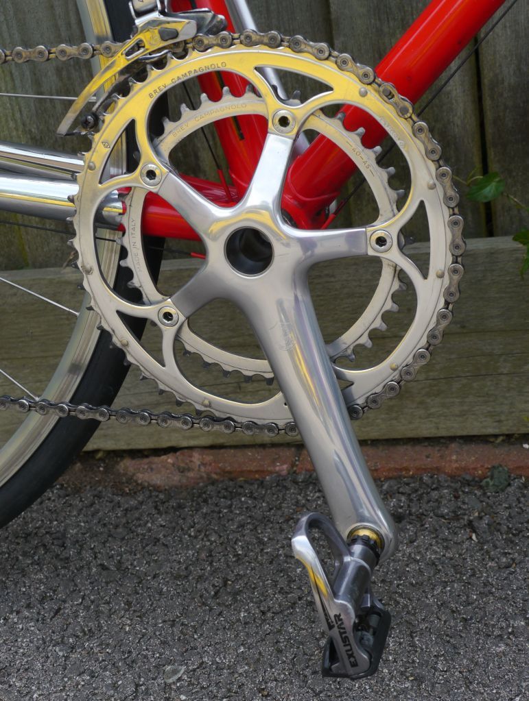

I've always been a fan of the Campag ultra-torque cranks , so when Tel of this parish came up with his gorgeous pantograph alloy custom jobs , I snapped a pair up . There fitted with a Campag Chorus 10 speed outer ring ,C-Record inner ring with Record alloy bolts . I also upgraded the Exustar pedals to the Ti spindle model .
