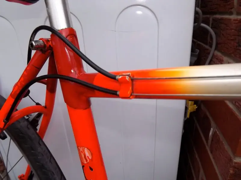

I picked the formula up today :D
Can’t do much with it at the moment as I’m away for a couple of nights so it is in the boot of the car at the moment!
I thought I’d start a thread for the bike by adding all the stuff I can find on Orange Formulas of this era.
This post appeared from Bedazzled13 a while back but has gone quiet which is a pity:
viewtopic.php?t=152968
The frame that I have bought looks very similar – the main differences in detail being the cable guides on the top tube - his are on the top mine are on the drive side.

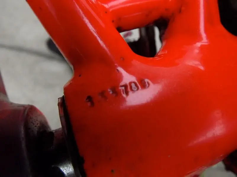

The serial number of mine is 133788, I have checked with Dave Yates and it isn’t one of the frames built by him which makes it likely to be one of the 6 Donohue frames referenced by michael@orange in the other thread;

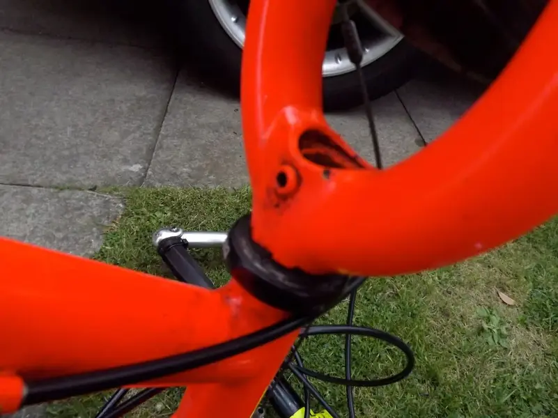

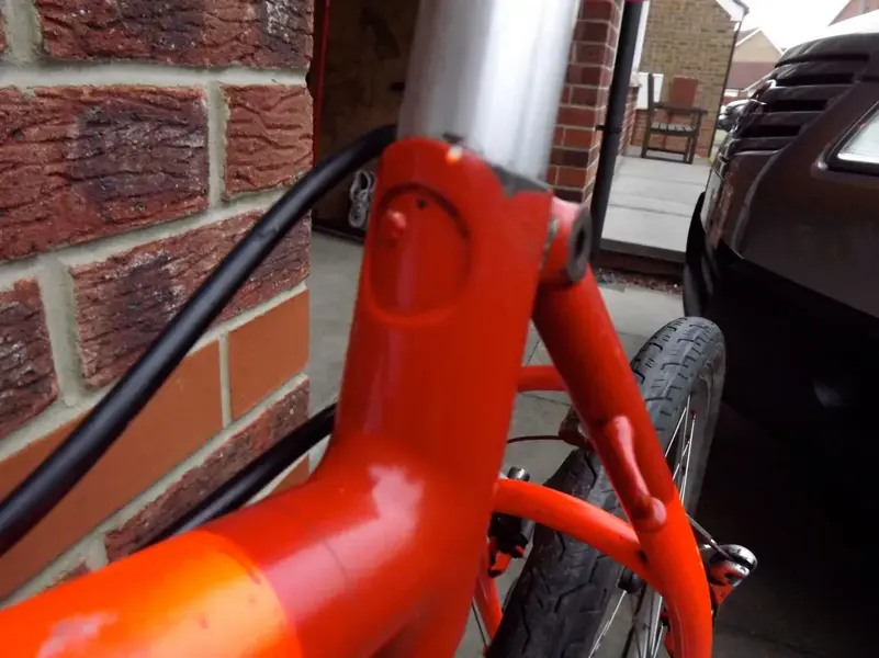

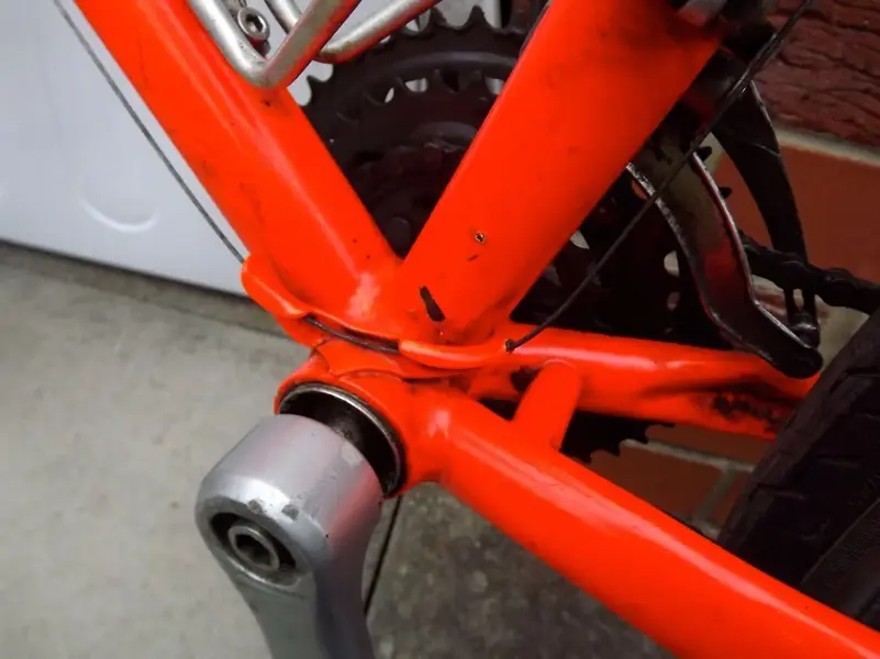

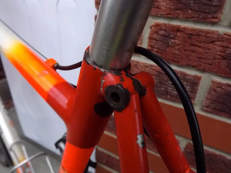

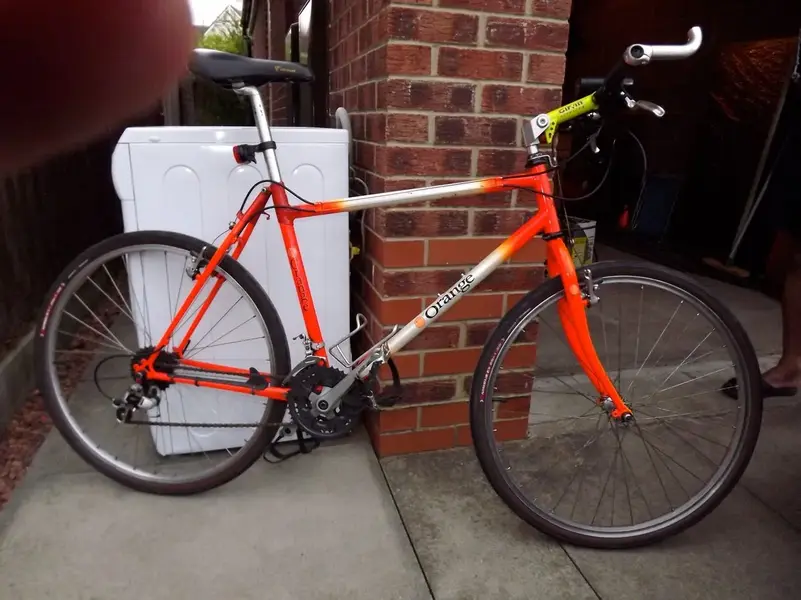

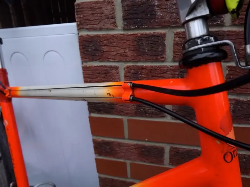

Some pics of the bike that I took before below. It is going to be a full restoration, I am really hoping that the corrosion in the seat tube isn’t too bad as that is going to be a problem to fix and retain original details - stabbed at it a bit harder now its mine and seems solid enough - the corrosion product is very well adhered and hard which are good signs but who knows what the insides look like!
Plan is a full strip down, detailed photographs to record the 'as found' condition, shot blast and then a visit to Argos or Dave Yates to look at the repairs….. can anyone advise the best place for a re-spray of an Orange?
Build will be XT m730 with either m7CD or MA40 rims, Timbuk IIs, turbo etc - keep it plain 8)
This is a really important one to get right so please let me have your thoughts suggestions etc - advice/opinions all very welcome and appreciated!

File comment: the logo
File comment: rear cable guides
File comment: front cable guides

File comment: serial number
