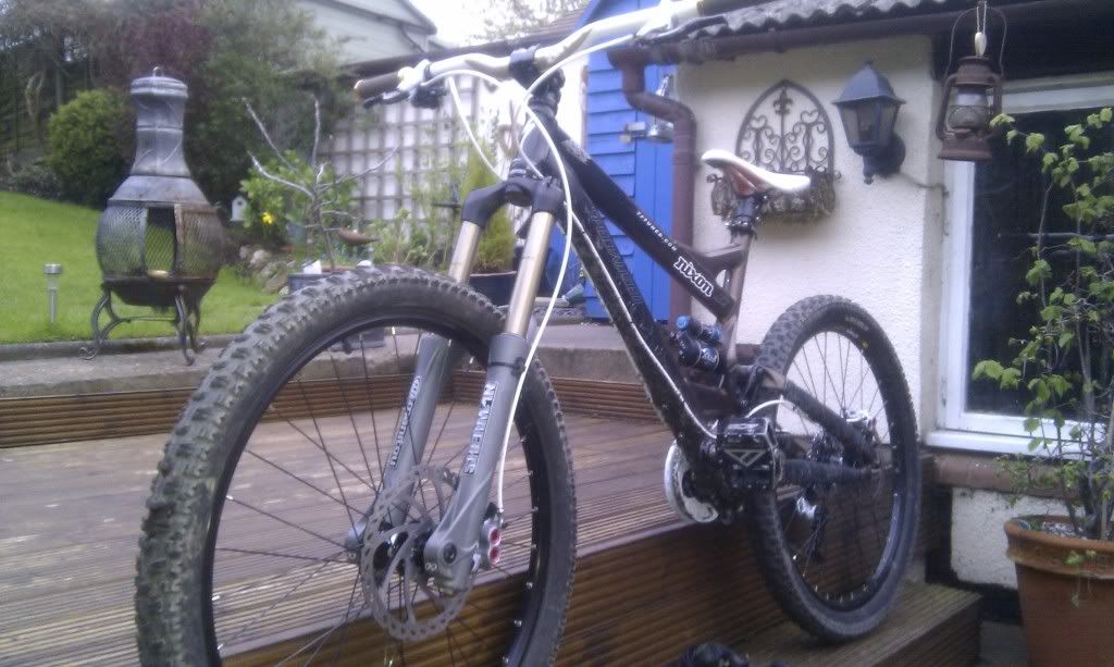

As the Chameleon project is not really going anywhere (due to lack of funds / poor choice of forks causing compatibility issues), I thought I would start a thread for my SX Trail.
Having been on a cycling break for a couple of years (I blame the Patriot 66 that I bought and loathed), at Christmas, I decided it was time for a new bike so I bought the frame and began collecting bits. The first incarnation involved a pair of Sherman forks but the bike never felt right with these - I think they were too short. They weren't very active either.
Pics after its maiden voyage...
I sold the Shermans and ended up with a pair of Z150's - these were awesome, but they weighed more than my house.

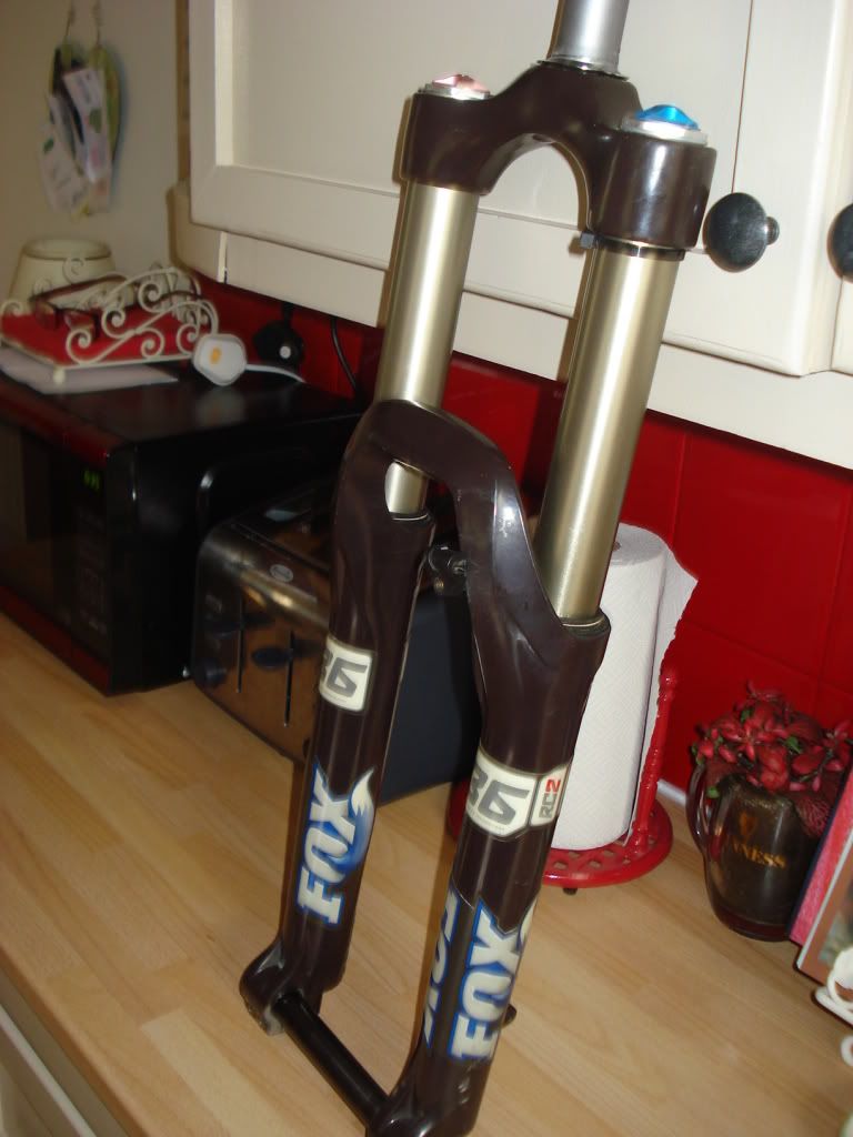

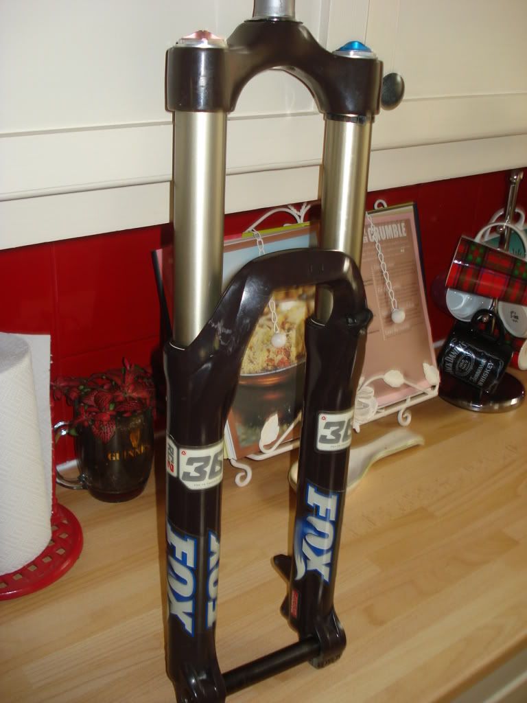

The Z150's went on E-Bay and I had to collect these from the Post Office on Friday.

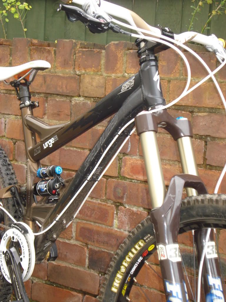

A pair of 05 Talas RC2's that have been converted to Vanilla RC2's. They have shed teh best part of 2lbs off the last incarnation.

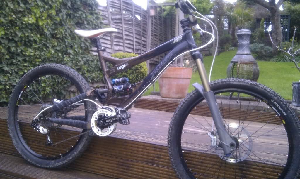

Some pics of the new forks fitted...
Full spec is:
2005 SX Trail, medium frame
2005 Fox 36 Van RC2's
Race Face Deus Headset
Thomson X4 Stem
Answer 780 DH Bars, uncut
Race Face Diabolus Cranks with Saint BB
Blackspire C4 Chain Guide
Sram X9 Shifter (10 speed)
Sram X9 rear mech, med cage
Sram chain
Shimano SLX cassette - 11-36teeth
Hayes Stroker Ace brakes with Superstar hoses
Azonic A Frame pedals
Charge Spoon saddle or SDG I Fly for longer rides
Race Face Evolve post cut down of SDG I Beam
NS Bike hubs on Mavix EN 321's
Maxxis Highrollers both 2.35, Super Tacky (f), 60a (r)
Plans are to try and shed a few pounds off it over the coming months - Superstar Nano pedals, Race Face Atlas cranks, E13 LG1 Train Guide and Conti Rubber Queens.
Here are some pics from a very muddy ride today.
I am very impressed with the 36's - easily as plush as the Z150's but mush stiffer, not as much brake dive and loads lighter.

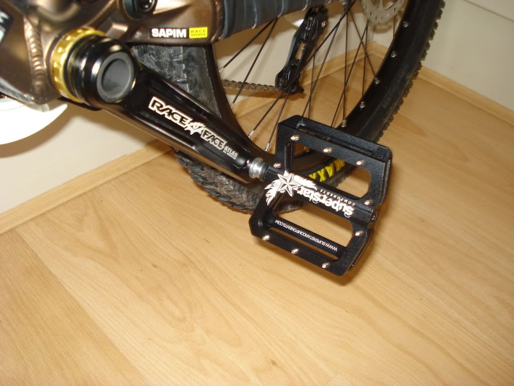

Having banged on about reducing the weight of the bike for a while now, I bought a pair of Race Face Atlas AM cranks from STW and a pair of Superstare Nano flats. The Conti Rubber Queens are out of stock in Germany (a shop there has them for 35 euros each rather than fifty quid each from this country), so they will have to wait.

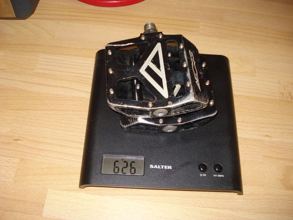

Azonic A Frames (how much!)
The Nano's on the scales
A total saving just over 1lb.

The only downside to the new cranks is that there are not as many axle spacers to help with the chainline so there is a bit more rubbing than there was before. This isn't too much of an issue because I was planning to buy an E13 trail guide next month.
Pics of the bits fitted.
Not the most exciting update, but hey ho.
