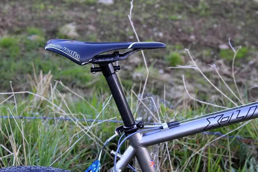

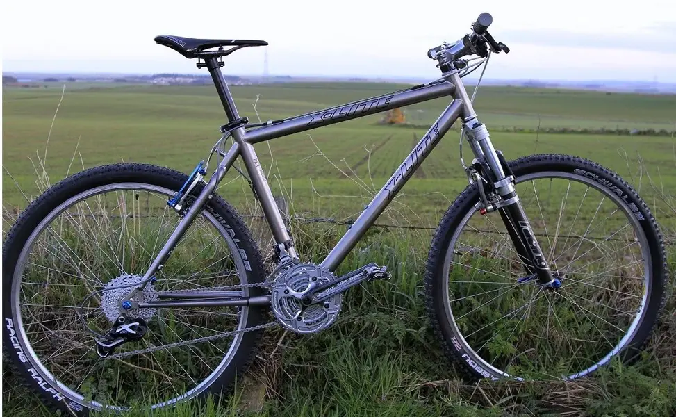

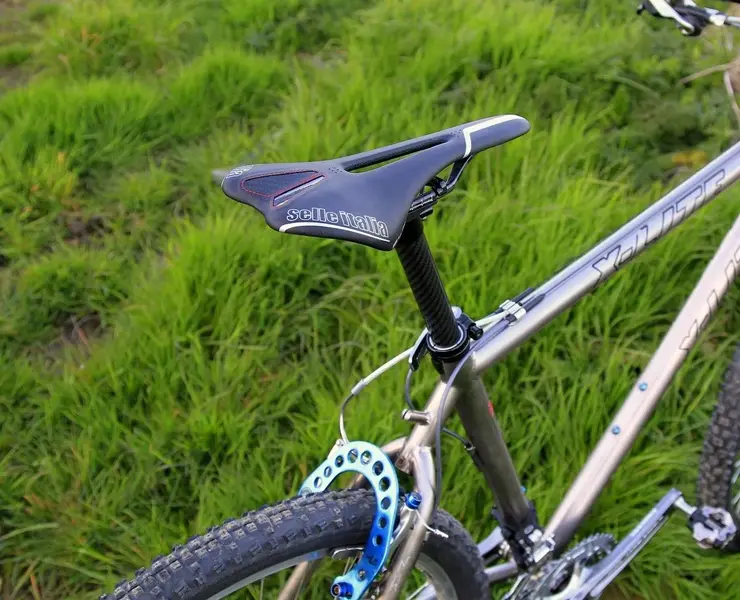

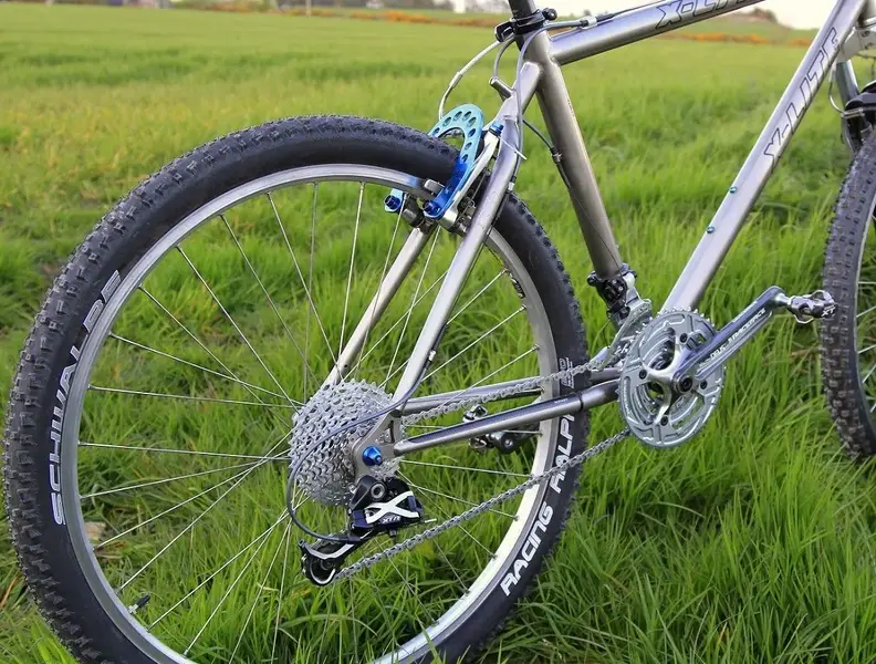

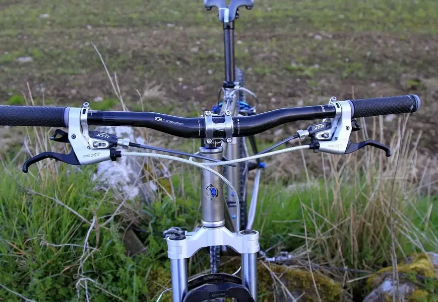

The ti frame build is now well underway; most of the first phase of parts have arrived. I’ve opted for 9 speed kit rather than 10 because most lightweight cranks other than Shimano stuff are geared towards 9 speed. The full build spec includes:
    RaceFace Deus XC SL Chainset, ltd edition with titanium axle
    XTR 9 Speed Rear Mech
    XTR Chain 9 speed
    XTR 9 Speed Shifters
    XT 9 speed Front Mech
    XT 9 speed Cassette
    XT SPDs
    Racing Ralph and Nobby Nic tyres
    Crank Brothers Cobalt 11 XC carbon riser bar
    Sunline XC-1 Stem
    Crank Brothers Cobalt XC SL Headset
    eXotic Carbon Seatpost
    Selle Italia SLR Kit Carbonio Flow Saddle
    Crank Brothers Split QR Seat Collar
Other than the frame itself, the old kit which has been re-used includes:
    XT Vee Brake Levers
    XT Vee Brakes
    Odyssey Brake Booster
    Pace RC36 Evo 2 Forks
    Mavic X221 wheels
    Hope Front and rear QR skewers
Total weight is now 9.8kg.
The Pace forks are due to go to Justbackdated soon for a rebuild and to fit a disc mount. Next on the list will be Crossmax / XTR wheels and XTR disc brakes, which should help shed further weight and improve stopping.
Anyway, hope you enjoy the pix – any feedback is always welcome :)
Rae

Haha like the one that was on the bike and I'm now selling: http://www.retrobike.co.uk/forum/viewtopic.php?t=199755
A clikon doesn't work with oval carbon rails I'm afraid.
A Thomson elite was on the cards but I opted for a carbon post in the end. The idea was to match the look of the pace carbon forks. Seat, seatpost, headset spacer and bar are all carbon.
It is a carboncycles.cc post. I asked them if they could do a carbon post without the garish big red logo on the side or a titanium post without the extensive etching. They could, but it was going to cost a lot more and take 3 months to arrive. I've seen people on other forums sand the logo off and spray a coat of lacquer over the top so I thought I'd give it a go. For anyone wanting to try it, mask off the area and just use some very fine emery / wet and dry. Keep slowly going until the logo dissapears. If you are careful you dont go through the clear topcoat. You can then polish the post back to gloss with t-cut or diamond paste (what I used) and you'd never know a logo was there in the first place :)
