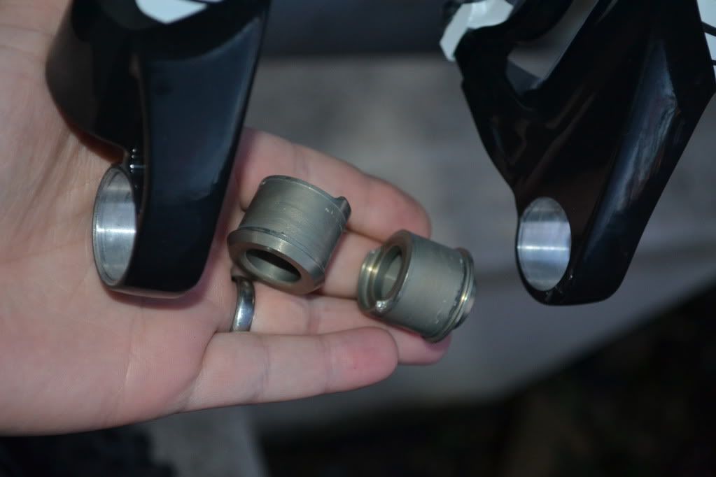

so when i first got my new bike the two brass? washers/ dropouts that the bolt through axle goes through were in the bottom of the bike box (not on the fork) so i thought this was normal... However its difficult to tighten the axle as they both 'spin' in the fork legs - does anyone with dt swiss experience know if they are meant to be bonded in or should they spin freely like this?
the manual just says stick the axle in and tighten to 15nm.....
I'm thinking the worse and that they havent been bonded in properly, the fork will have to go back to Canyon for warranty....

There doesnt look to be much glue on them? Or is there?
The half rounded bits, wouldnt they sit in something?
Or try them in the other way?

The half rounded help you put the wheel in, holding it in place. There is what looks like the tiniest dab of glue on the threaded one....

Yeah i see now.
Probably have to agree with you there.
Maybe get some araldite or something on it if you wanted a faster fix.

If it were 2 year old I would, but its only 2 weeks old and any araldite will void the warranty.
My thoughts exactly, but you must be itching to ride it!
Back it goes. Call them first.

But its been nagging me since i got it - the way that they were loose in the bike box, and i just cant get it tight... so i reread the maual and stuck it back on the work stand, had to use rubber ended plyers to hold the screw in one so that i could undo the axle.....
not goood - back to germany it'll go - just hope that they only need the fork and not the entire bike....
