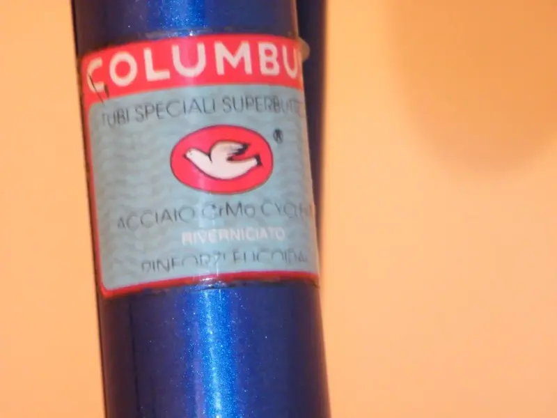

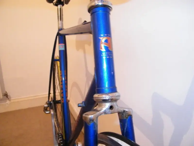

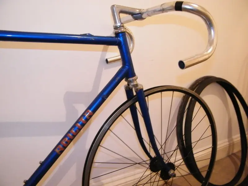

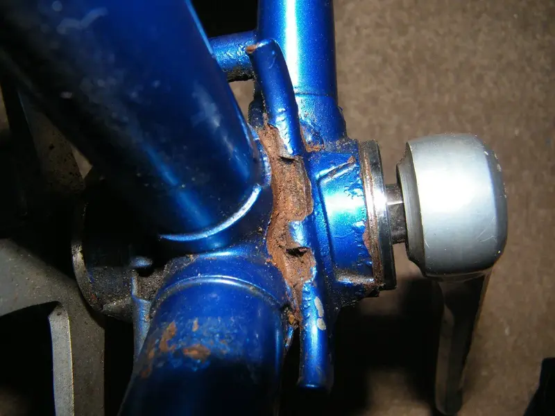

Recently bought this Abilita frame. Intending on dong it up as a road bike. Can't find any information on the builder and slightly confused about the tubeset. Lastly, slight concern about the bottom bracket cable routing rust...
Any help with any of the above appreciated.
NB. Tubeset sticker says the following:
TUBI SPECIALI SUPERBUTTED
ACCIAIO CROMO CYCLEX
RIVERNICATO
RINFORZI ELICOIDAI???
Any help on any of the above much appreciated.

RIVERNICATO means re-painted according to Google Translate so it's had a respray at some point.
The super-butted tubing was SLX/SPX/TSX as it was butted and had the helical reinforcements at the tube ends. You should be able to feel the spirals in the seat and down tubes at the bottom bracket.
A decent frame re-finisher should be able to tell you whether that rust is serious or not. Hopefully it's just the cable guide.
Mark.

With a name like that I was expecting it to be Italian - and then I saw the Dorset tag on the headbadge!
Anyone here from the area?
PostPosted: Wed Mar 14, 2012 12:25 am
Joined: Thu Mar 10, 2011 4:47 pm
Posts: 255
I assumed Italian as well - can't find any trace of the company in Dorset...possibly the (re)painter??? Any ideas for someone i could take it to in the London area?
