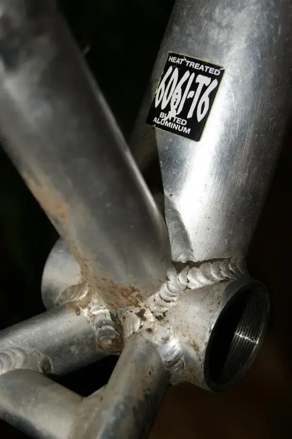

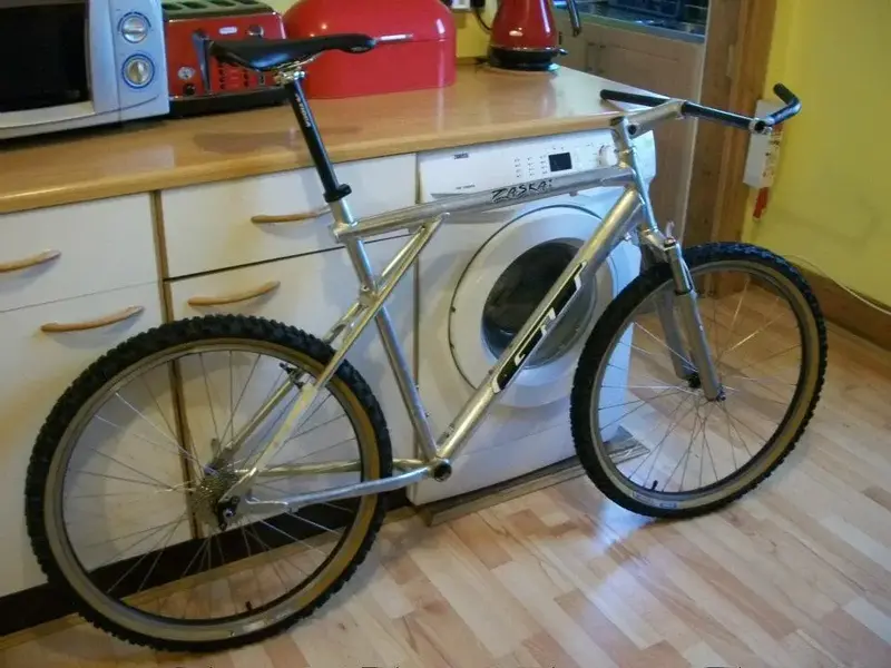

This build started mid-October 2011 and is now nearly finished, except one skewer I have a lead on.
The starting point was a super scratched, oxidized, minging mess of a 20 inch 1996 Zaskar LE frame bought of Ebay. The plan - to build it in an earlier style with 1992 decals, courtesy of Gil M.

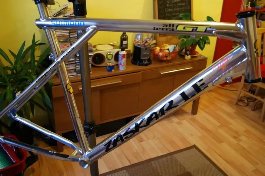

Frame prep 1)
Stripped old decals off with a hairdrier. To gauge the real condition of the frame I quickly washed it and polished it using Autosol on a toothbrush and on mutton cloth. This showed up the worst of the scratches, dings and misty white areas.
Frame prep 2) Using 600, 800, 1000, 1200, 1600,1800 and 2000 grade wet "n"dry paper I progressively went through the grades, using lots of hot, soapy water. This eradicated all the oxidization and most of the scratches. This procedure took a 1 1/2 days!!
Frame prep 3) Gave the whole thing a real buff for 5 hours with Autosol and finished of with Autoglym Resin polish to seal in the blingo!!
Frame prep 4) After pressing in the Tioga Alchemy headset I used brake cleaner to remove any traces of grease, before installing the awesome new decals from Gil M, as well as the NOS Onza and Shimano ones I found in California. This stage was nerve racking!

Looking loved now...

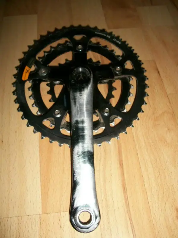

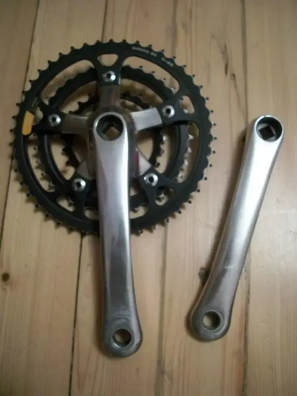

With the heart of the bike looking a trillion times fresher, it was time to get stuck into some component detailing.
Using good old oven cleaner and Autosol the scabby, black anodizing was removed and the alloy buffed to a mirror shine. this is soo satisfying to do!
All bolts were painfully scrubbed clean and the wells in the teeth of the chainrings were also cleaned one by one.

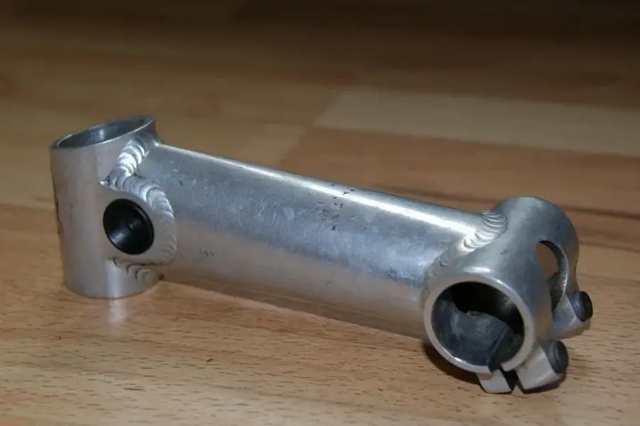

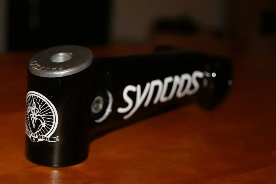

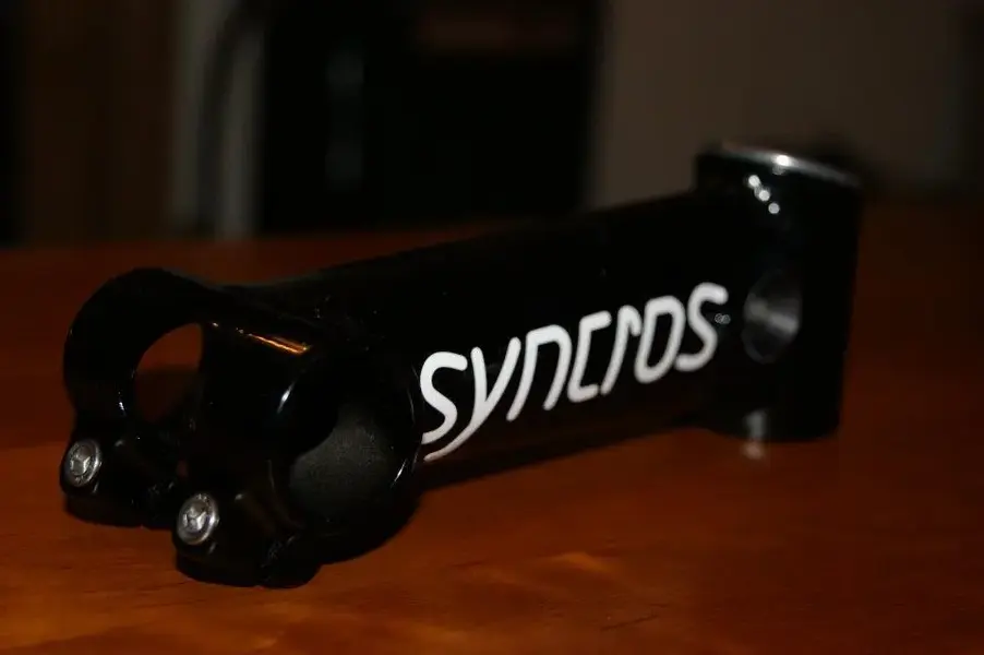

Stem time! Scored this Syncros 140mm Aheadstem from Ebay! I gave it a good dose of black two-pack paint, colour polished it and freshly garnished it with new bolts. Decals, again from the sticker dude, Gil M were applied and it looks AMAZING!

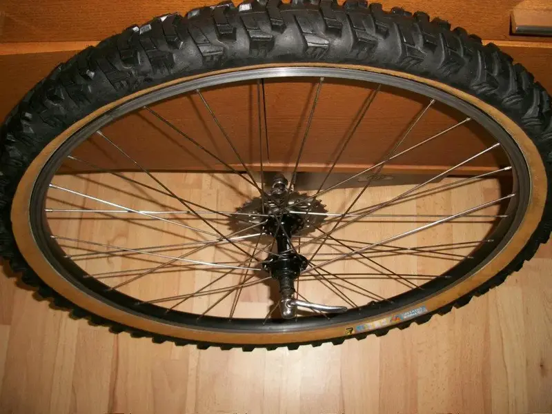

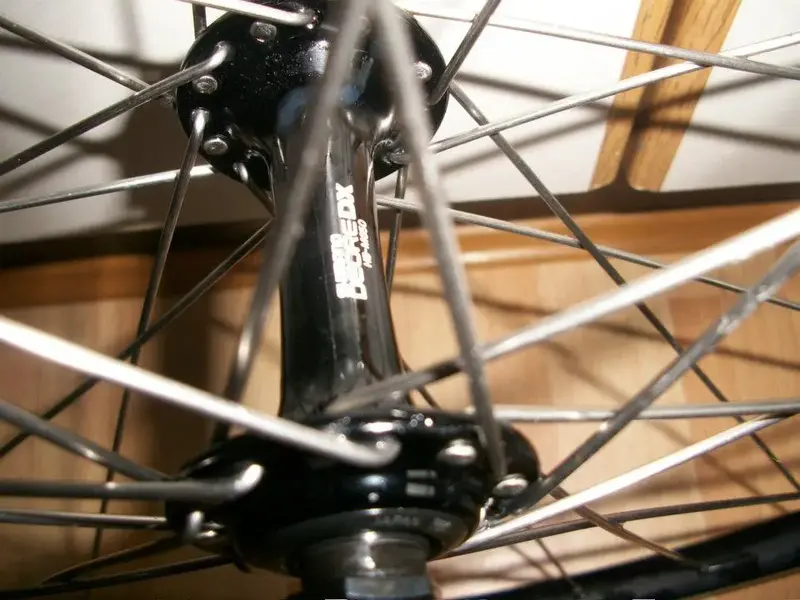

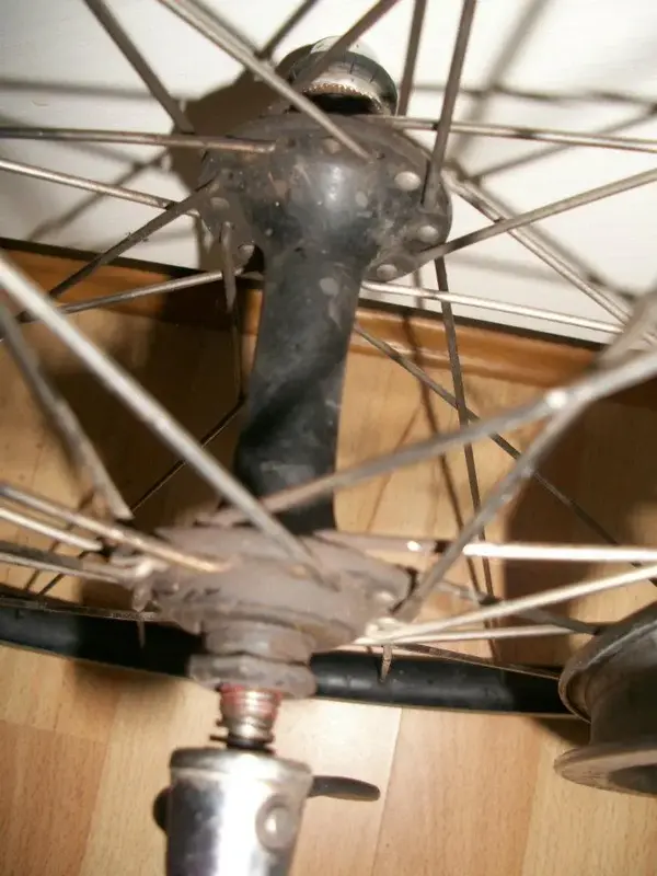

Wheel time! As I work in a bike shop, I managed to find some good as NOS Tioga Psycho K tyres which were promptly scrubbed up to the max and fitted to the freshly re-built hubs and re-dished rims.
