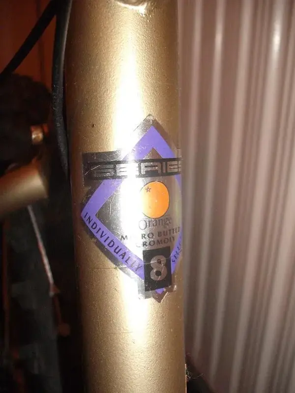

Ok, so firstly i must thank sylus for pointing me in this direction, an ebay find which after some negotiation and costing me a few beer chits became my next project.
Bronze C16R ? Or is it ? Now i am no expert at identifying bikes but it does have some tell tale signs of being a C16R, and also a few that don't and point more towards being a P7?.
First of all a quick run down of the spec;
Orange Frame & F7 Forks finished in a Bronze/Gold colour. (Series 8 Tubing on the frame) Frame number is A4060336 (Note - Frame has round bottle mounts not diamond shape. Has Canti Mount on rear stay). Paint looks original.
Shimano LX 1" Headset
Shimano M735 Front and Rear Mech
Mavic 121 SUP Rims fitted to Hope Hubs Front & Rear, and dressed with alternating Red & Blue Spoke Nipples.
Middleburn Chainrings fitted to a bent Sugino Crank and Rocky Mountain Non Drive Side Arm.
Redline Beartrap Pedals
Innova Tyres Front & Rear
Orange SK8 Stem
USE Seatpost/Shim & Unknown Saddle
Tranz X Highrider Bars
Unknown Grips
Bit of a mixed bag but i am sure has some potential, let me know what you think. Any Orange Guru's out there please drop me a line :)

Thought it may be a P7 ? The front mech is clamp on but my later C16R is BB mounted, and the seat clamp and shim and USE seatpost are identical to a 1994 P7 which reflects the age based on the frame number. The Decals are aftermarket and badly positioned apart from the Series 8 Tubing decal which is original.

Looking at the 1995 PDF Orange Catalogue It looks like its a 1995 P7, (Series 8 Tubing on the P7, and Series 7.2 Tubing on the C16R)

Ok few things that dont add up;
C16R has Series 7.2 Tubing,
This bike has Series 8? (According to the decal which looks original)
P7 has diamond shaped lugs on the bottle mounts.
This bike has round bottle mounts?
So P7 or C16R? The plot thickens..................

Those decals look wrong.

I have never seen that colour before, so I would assume that it is a respray - in which case, I would ignore the assorted stickers that are on there.
I'm pretty sure that at that time P7s had an external ring reinforcement at the bottom of the head tube, but C16Rs didn't.

The chances that someone put the wrong sticker on by mistake are a lot bigger than the factory using the wrong tubeset on a single frame, wouldn't you say?

I've had a look through the PDF Catalogues from 94/95/96, on the forum and on some of the 'Action Shots' you can see riders on Golden/Bronze bikes.....Im now swaying towards it being a C16R from 95? As that looks closest to the one i have, The stickers are a mess, although the Series 8 Tubing Decal looks original, but maybe an addition by the previous owners. The spec is a mixed bag but a good starting block to proceed with. :)
