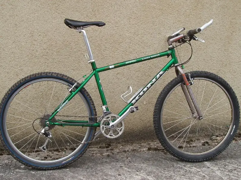

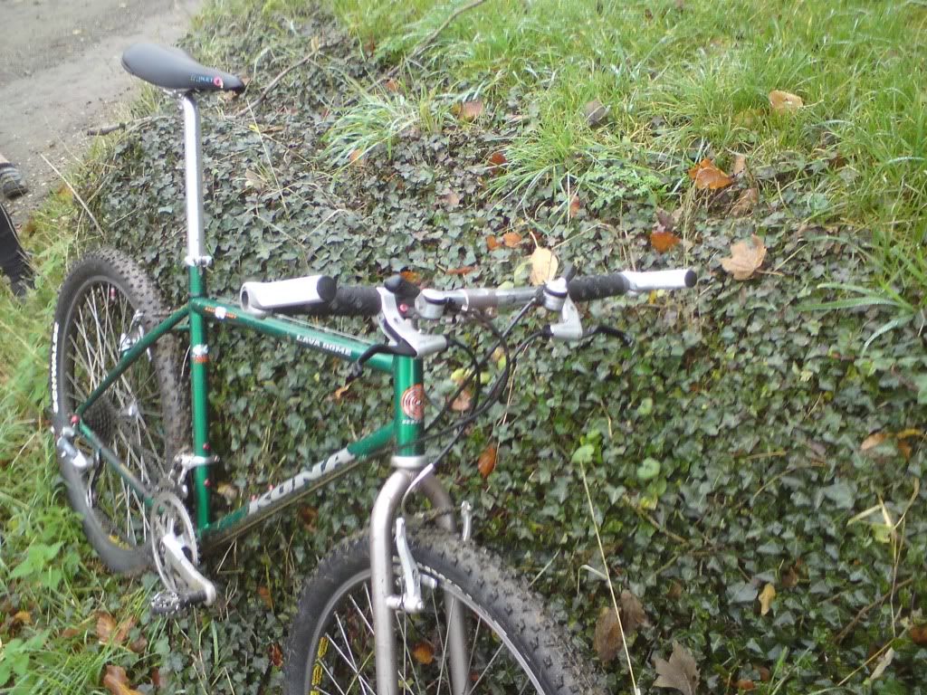

A recent impulse ebay purchase that had been left outside in the sellers garden for quite some time. The frame was in a pretty sorry state but plenty of time, polish and elbow grease and it came up a treat.
It was a full bike but the only bits worth keeping were the farme, forks, stem, headset and Dx thumbies, the rest was either binned or put on ebay.
Anyway spec and pics to follow, I really should have taken some decent pics before I got it all muddy at todays Binbrook ride :lol:
The 1st Kona I have ever owned and I'm loving the ride already.
Frame: 19" 1994 Kona Lava Dome
Fork: Project 2 Triple Butted
Headset: Impact
Stem: Velocity
Handlebar: Syncros
Barends: X-Lite Stubbies
Brakes: Avid SD 2
Brake Pads: Clarks cartridge
Brake Cables: Shimano
Brake Levers: Xt M739
Shifters: Deore Thumbies
Front Derailleur: Xt M735
Rear Derailleur: Xt M735
Derailleur Cables: Shimano
Cassette: Shimano ?
Chain: Shimano
Cranks: Xt M730
Chainrings: Xt inner & Middle, Xtr Outer
Bottom Bracket: UN54
Pedals: Coda Spd's
Hub Skewers: Halo Hex Skewers
Rims: Mavic 231CD
Hubs: Xt M730/732
Tyres: Schwalbe Rocket Ron
Tubes: Specialized
Saddle: Original Avocet
Seatpost: Ritchey Style
Seatpost Binder: Original Kona
Weight: 24.4 lbs

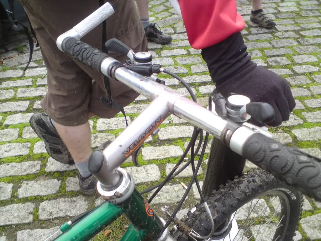

Looked great in the flesh on Sunday.
Go on Chris, show 'em your neat trick on the rear brake cable!

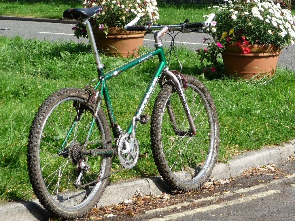

I love mine too...
Need to get some thumbies on there, am running 8 speed Gripshift presently which work well but don't have the look. Original cranks polished up look great I think.

What have you done to allow the use of rear V's with the canti stop, we just used to use a piece of outer cable between the removeable stop on the seat tube to the V brake noodle, back when we were skint young kids and couldnt afford the proper bolt on V brake stops lol :lol:
PostPosted: Tue Nov 15, 2011 8:18 pm
retrobike rider
retrobike rider
Joined: Fri Aug 08, 2008 1:36 pm
Posts: 11873
Location: East Yorkshire, England
Spudly, we are just skint grown up kids now :lol:
You'll see it out on a ride soon too, probably if he doesn't mind it getting muddy again.
The bolt on v-brake things look a bit ugly too.
It's a V-pipe as normal, and a cutdown-upside down v-pipe into the dog collar and a short bit of outercable.
Looks neat and tidy and works.

I drilled the cable hole in the dog collar just enough for a cut down v brake noodle to be a snug fit, don't drill right through the collar!
Then a short length of outer brake cable between the 2 noodles makes a nice tidy job. I was lucky in that the 2 noodle pipes lined up perfectly but I'm sure they can be bent if yours don't achieve the correct angle.
Sorry about the pics its dark in the shed and the bike hasn't been properly cleaned since Sundays Binbrook ride.
