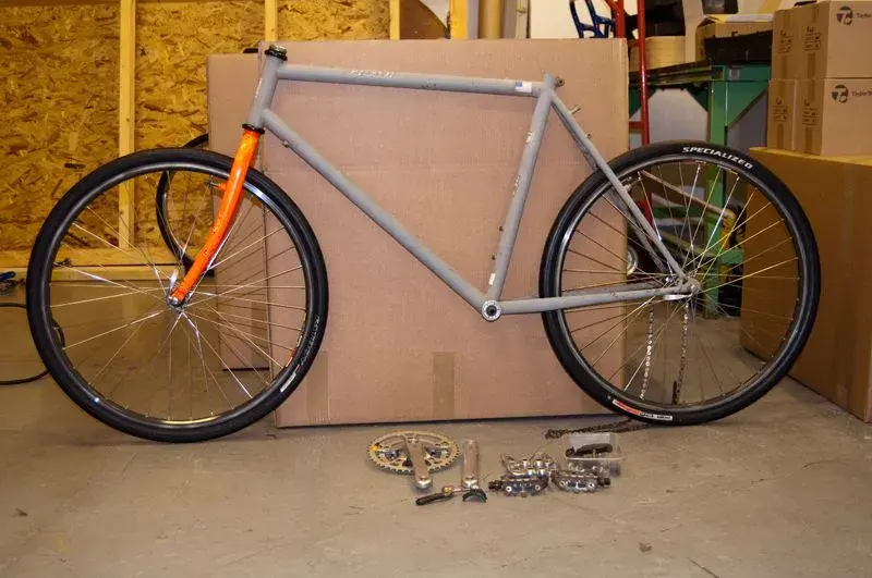

Here's my recent acquisition - bit of a resto project this one! 1990 Marin Pine Mountain in Zolatone 2000 grey/orange fluroscent. Obviously it hasn't been well loved and cared for but the price reflected that. The grief involved in actually getting the bloody thing delivered was impressive though - it took 3 weeks to arrive and when it didarrive it came with a Royal Mail fee of £14.69 to pay - somehow it had got through the system with no postage paid on it......:shock:
Since I've been commuting backwards and forwards to work I've come to realise that I need a big frame (I'm 6'2") - the 18" Palisades Trail that I currently ride is too small - cue long seat post and riser stem so that I can actually feel comfortable - so I've been on the lookout for a 19" Marin frame for a while to replace it. In browsing retrobike over recent months the early 90's Zolatone Marins have really caught my eye so when this "project" came up on eBay I took a punt on it. The paint is in pretty poor condition, it's presumably been stood outside for a while and the forks/stem/handlebars are pretty badly chipped. But it's not dented or bashed around so it seems to be a good basis for a resto.......

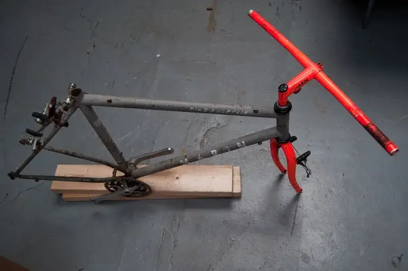

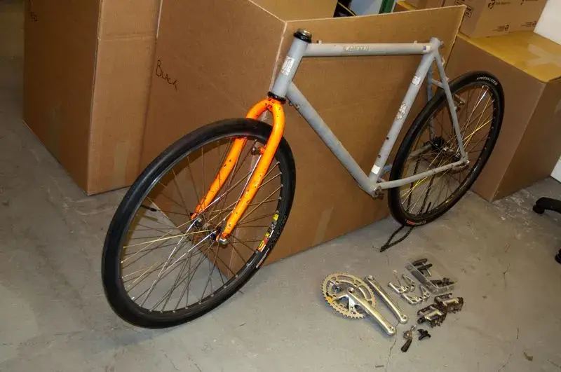

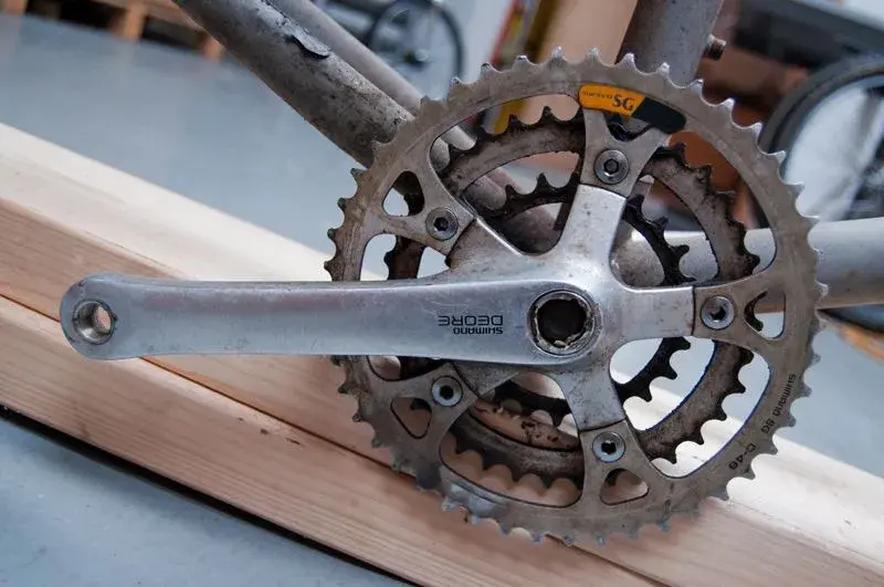

I'm gonna have a bash at it myself - I've resprayed stuff in the past and have been fairly successful, although the zolotone may prove hard to replicate.
I've cleaned up the frame a bit and removed some of the knackered stickers (after photographing them for the record) and borrowed the wheels off the MTrax. It's looking a lot better......I'm sorely tempted (for the time being) to respray the forks, touch in all the chips in the grey, chuck some new graphics on and get riding it.

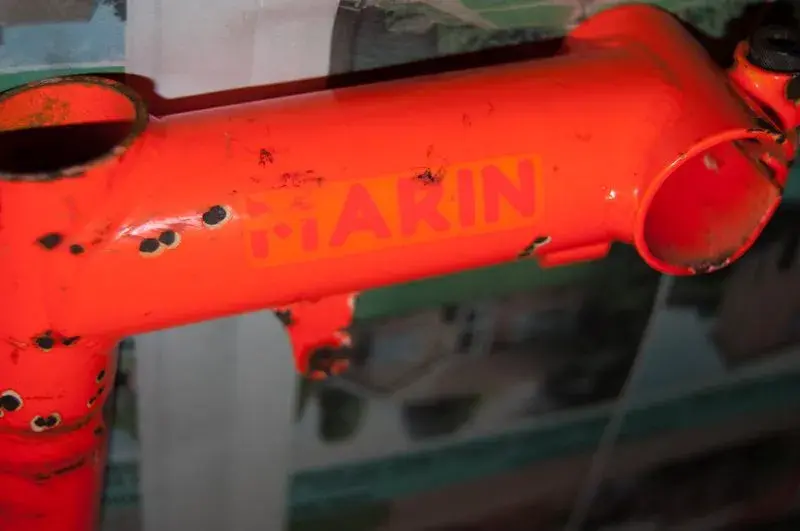

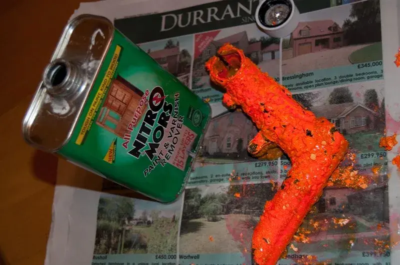

Stripping! Nitromors works a treat. - Thought I'd have a go at renovating the orangy bits first.....Acid Etch primer, white undercoat and fluro Orange paint all on order! Seems these orange bits are also prone to some bad fade - 20 years of UV exposure and the Marin decal is still evident on the stem even after I've removed it......
