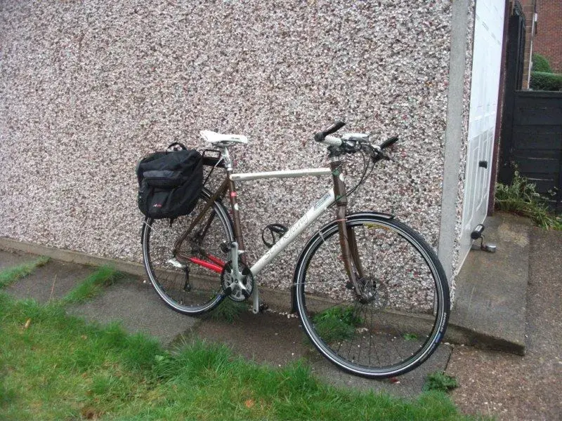

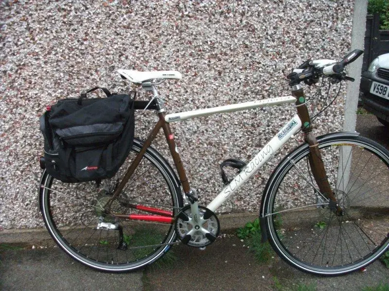

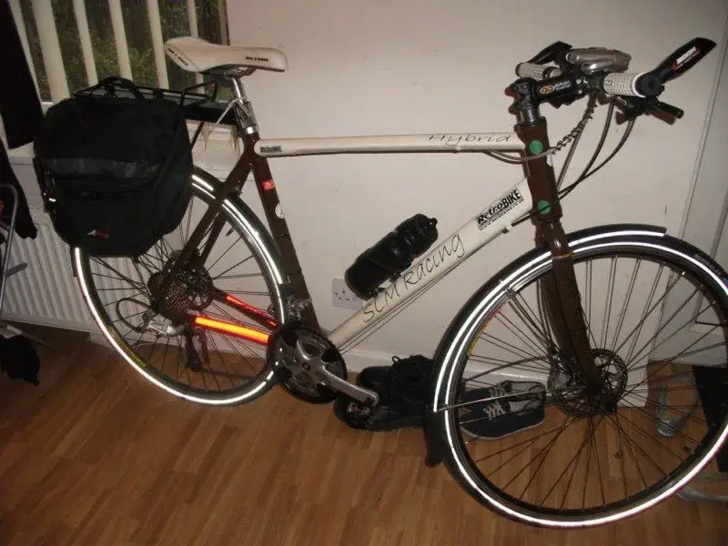

Well it's finally finished, I got the frame off weeman mtb at the forest of dean (karma) it's an 08 boardman hybrid (was a dark blue). I have built it on a retro theme and the spec, gears, brakes etc are exactly what I need to suit my commute to work and back, just been out for a road test and apart from a few tweeks with the gears she is good to go
The spec is 08
boardman hybrid frame
Deore lx mtb hubs laced with mavic cxp 22 700c rims
schwable marathon comfort tyres 700cx32
Deore lx integrated hydraulic shifters 2x9 speed
xt calipers and rotors
xt rear mech
shimano road front mech
shimano nexave double chainset (dirt cheap, winter knocks the crap out of a chainset)
on one big nose saddle
semi integrated headset
easton stem/tioga flat bars
avenier pannier rack and bag
As for the cost of the build (less than £500) I don't think I could find anything in the shops that would do what this bike can, very pleased with the bike and look forward to thousands of miles worth of riding
