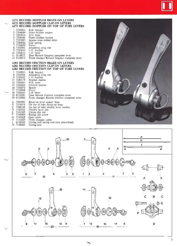

The Shifters I bought off ebay had sawn off bolts , maybe it is common for the bolt to bottom out in the lever boss before there is enough friction. The bolts should be titanium so shortening them might be hard work :D
Anyhoo, the parts catalogue suggests you've got too many washers and both bolts should be the same ...
PostPosted: Mon Oct 03, 2011 1:16 am
Joined: Sun Aug 03, 2008 12:31 am
Posts: 585
Location: London
Thanks to the diagram, I think I know what's causing the problem.
There were 2 types of levers.
The levers in the top half of the diagram are the "retro-friction" type, called "Doppler" by Campagnolo. The bottom ones are the plain friction levers.
It looks like the OP's got the plain friction levers fitted with some of the parts meant for the retro-friction levers.
The 2 types of levers work in a different way.
The retro type only has resistance when you push the lever forward, unlike the plain friction levers. So when you pull the RH retro lever back to change to a lower gear (ie to a bigger sprocket), the lever has no friction, you are only pulling against the derailleur spring.
I've got a pair of the Doppler levers but I've always prefer the Simplex Retro-friction levers. The washers marked F and G are not flat (parts 6 in the diagram), they act like a sort of spring, Campagnolo calls them "spring cups".
