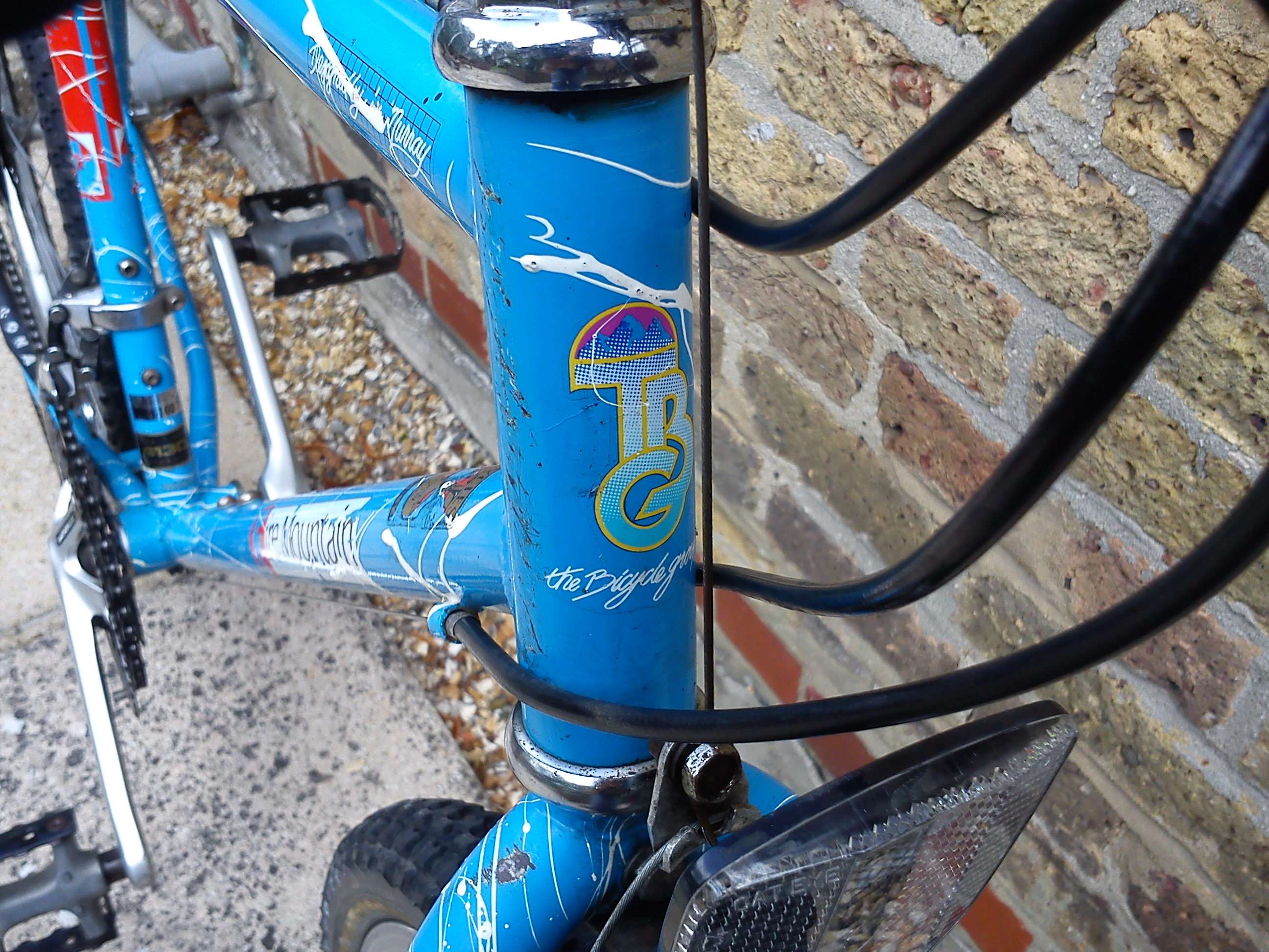

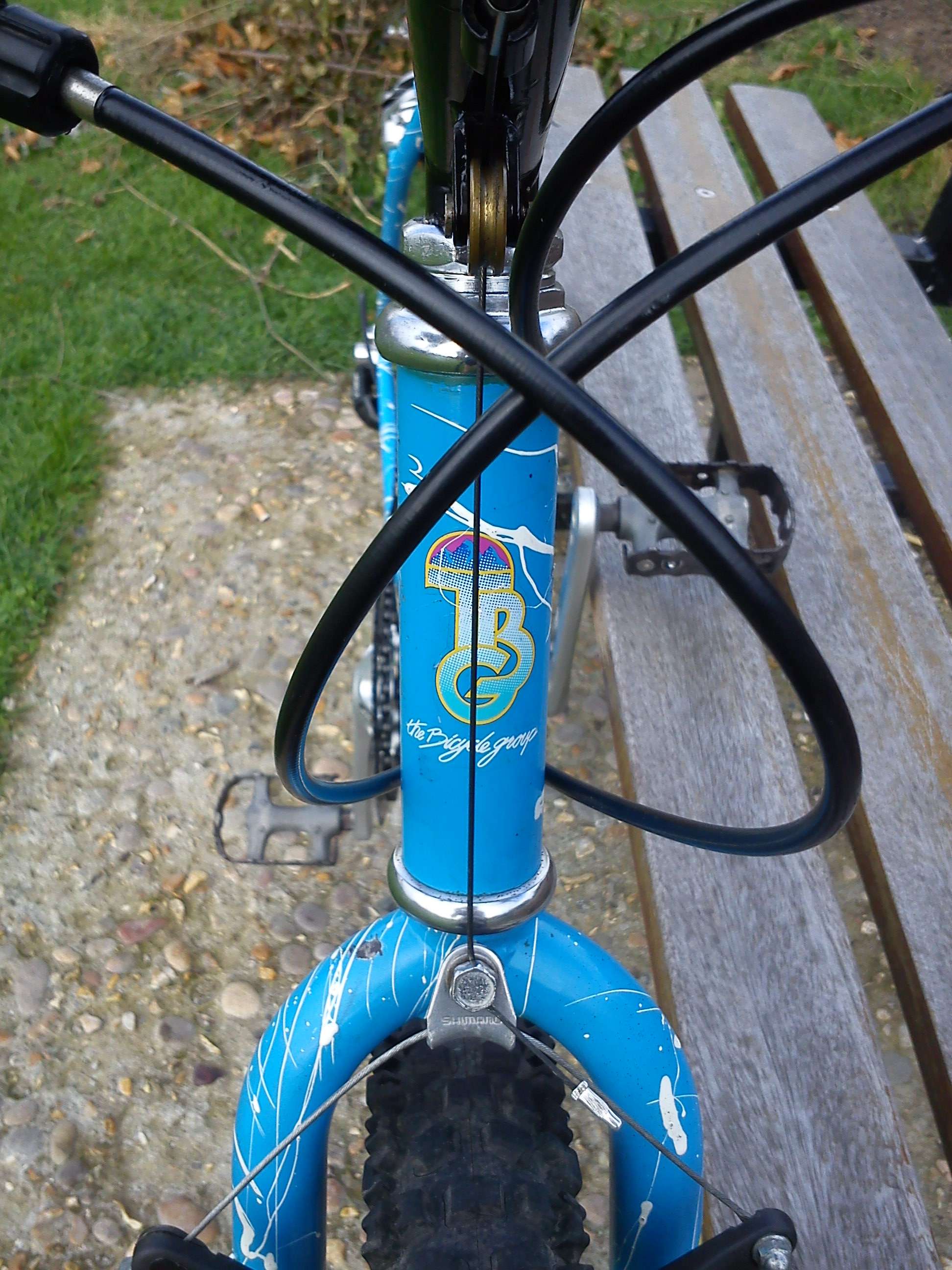

The mystical TBG branding added that little bit extra for me at least. Remember there's a wealth of catalogue information on here. So I studied the 1990 brochure before hand to make sure it had as much of the original kit as possible.
As you can see, it was rough around the edges, but was fully original. It had one lady owner who revealed her boyfriend back in the day had bought it for her. He had great taste I said!

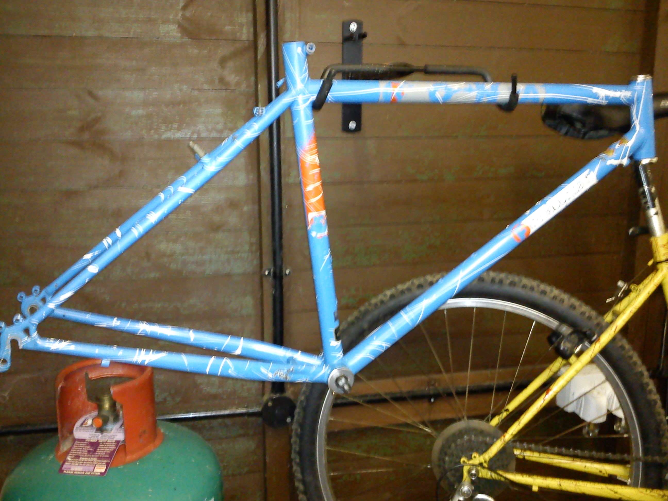

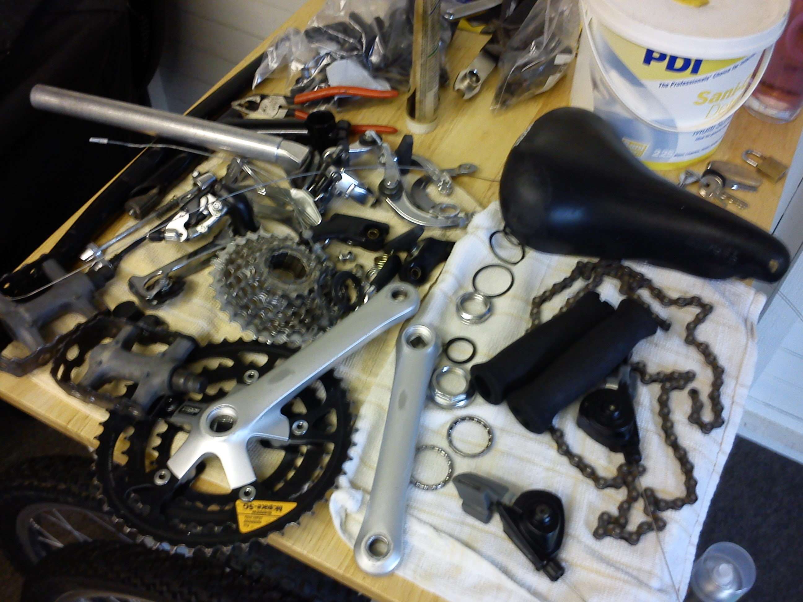

Once I had my paws on it, it was clear where the build was heading. Since it was my first proper is was simple - take it apart, completely. Everything. And that's what I did. Kit you need that wouldn't normally have in a usual toolbox:

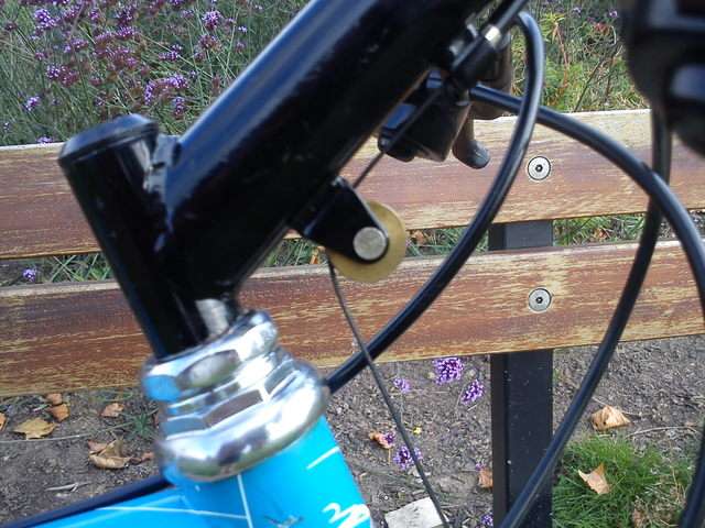

Headset spanners - don't even think you can remove one with normal spanners like I did. You'll ruin the metal and it slips like a bitch.

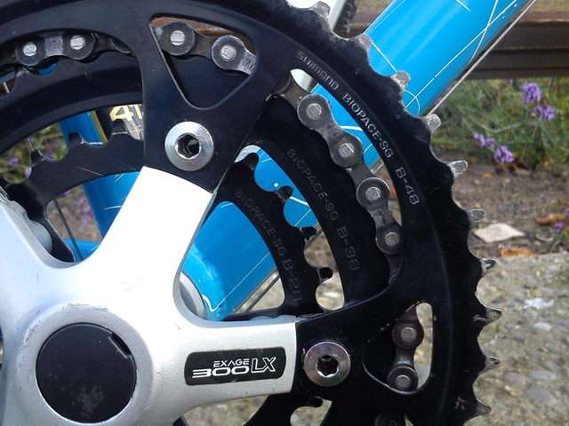

Crankset remover - massive faceplam moment was I posted on here going "why can't I get these off?" and was politely told, "have you used the remover?" :lol: Top tip, make sure you screw in the bolt as far as you can otherwise with really stubborn cranks, you can shear off the thread...which ALMOST happened.

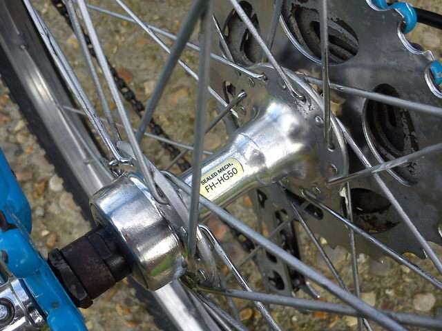

Cassette remover adapater and chain whip - luckily I had these already. Remember the earlier cassettes can take different adapters...as I've just found out with my next build :lol:
I also recommend:
Patience - you can't buy this. But seriously, don't rush, take your time. This took me 7 weekends, about 4-5 hours a pop.
Halfords motorcycle/ car degreaser (spray can)
Halfords lacquer
Autosol - whoever invented this is a genius
Cilit bang
Old tea towels

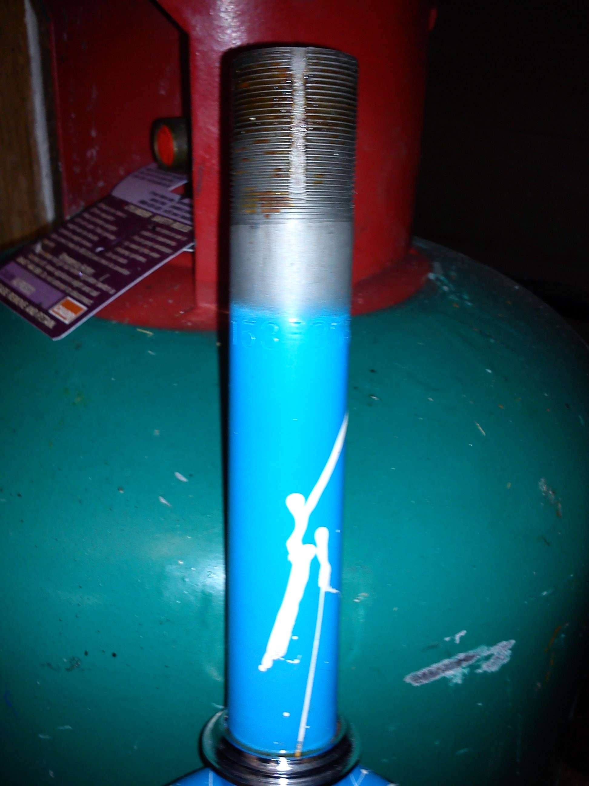

Slowly but surely, I took everything apart. Cleaned, degreased, polished. The only item I didn't remove was the BB only because it had no play in it whatsoever. Don't mess with stuff you're not familiar with was my motto!
Dinner is served.

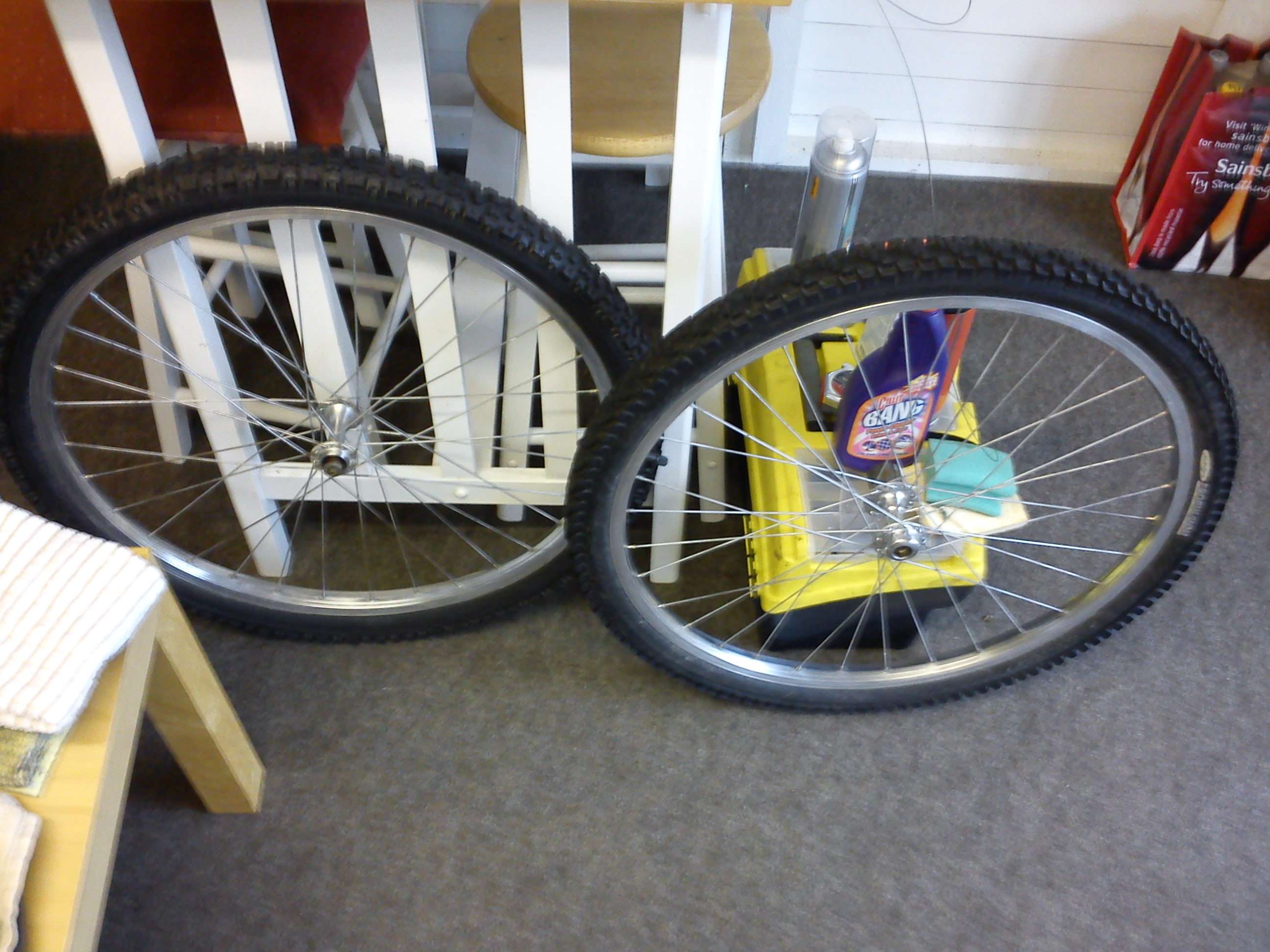

What was my nemisis? The wheels.

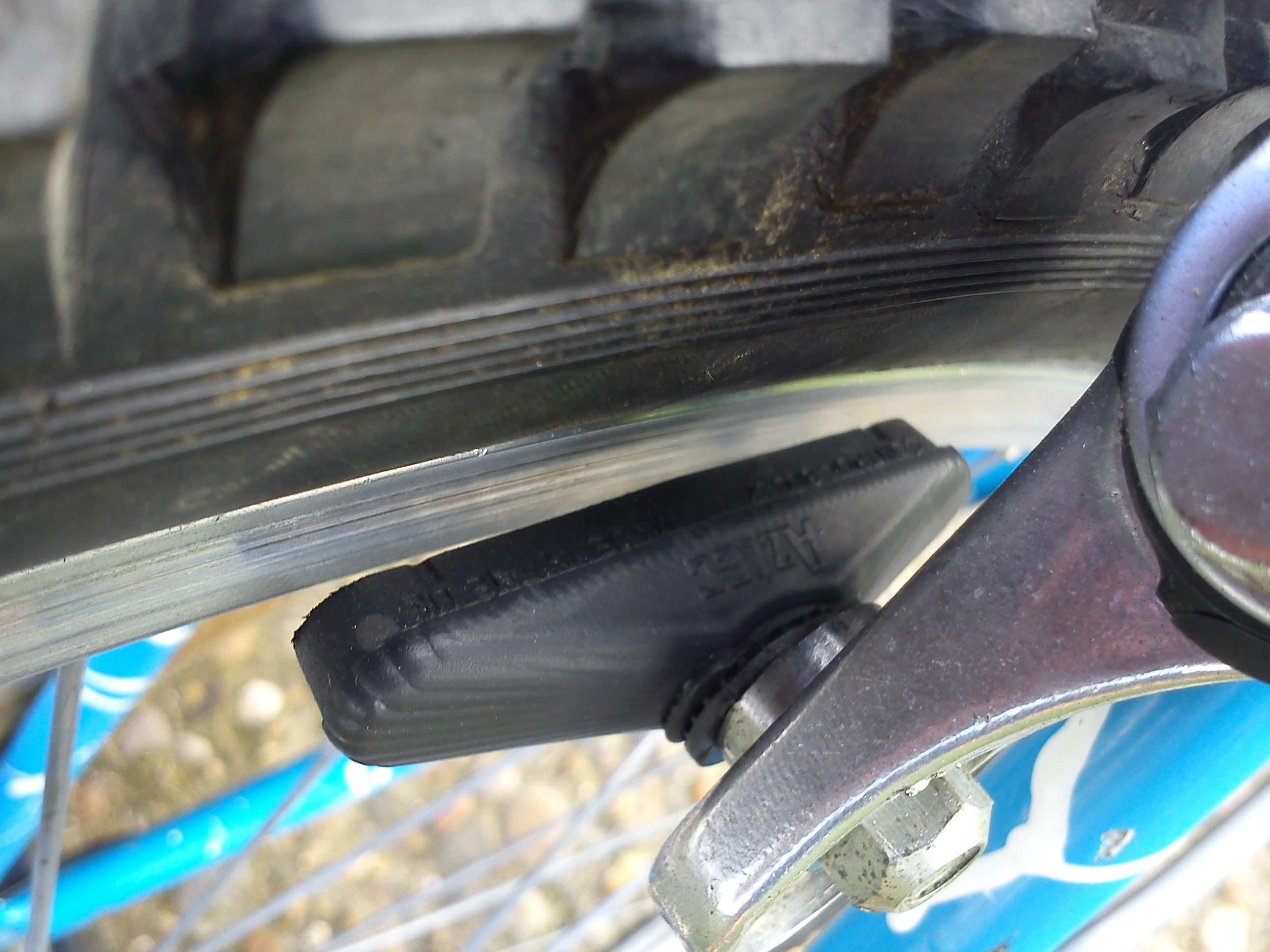

I spent the best part of 4 days cleaning, scrubbing and polishing. Stainless steel clearly stains. In fact they were covered in a crust. So, scouring pads and Cilit Bang - this stuff is brilliant but be careful since it's acidic. In 3/4 spoke sections, I sprayed the bang, left it for 90 seconds, then scrubbed. Off came the crust. Then when rinsed and dried, it was polish time with autosol. I think they came up a treat.

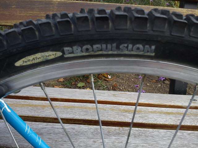

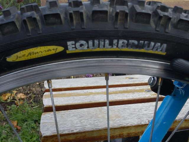

The tyres were shot as were the tubes so, thanks again to the For Sale section I had some 92/93 original Joe Murray's. I think they look ace.

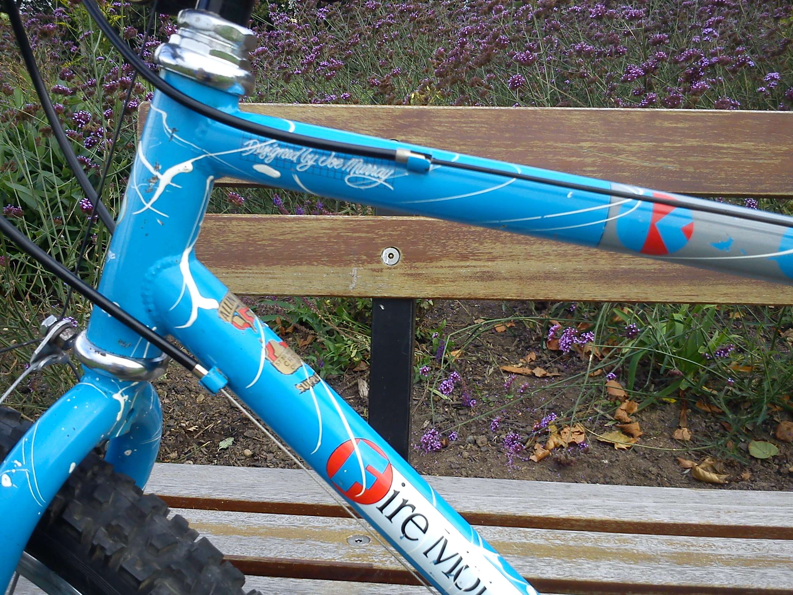

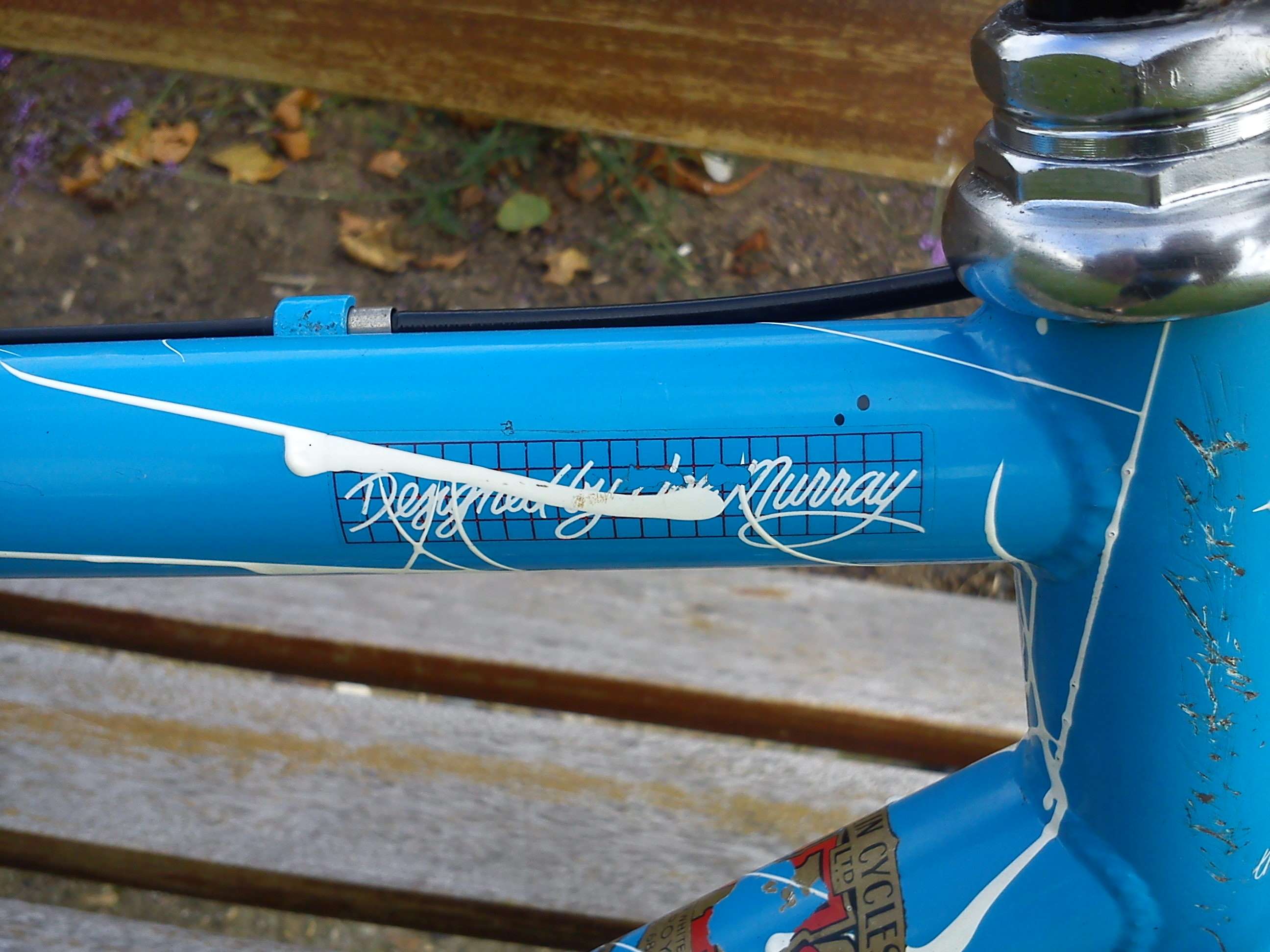

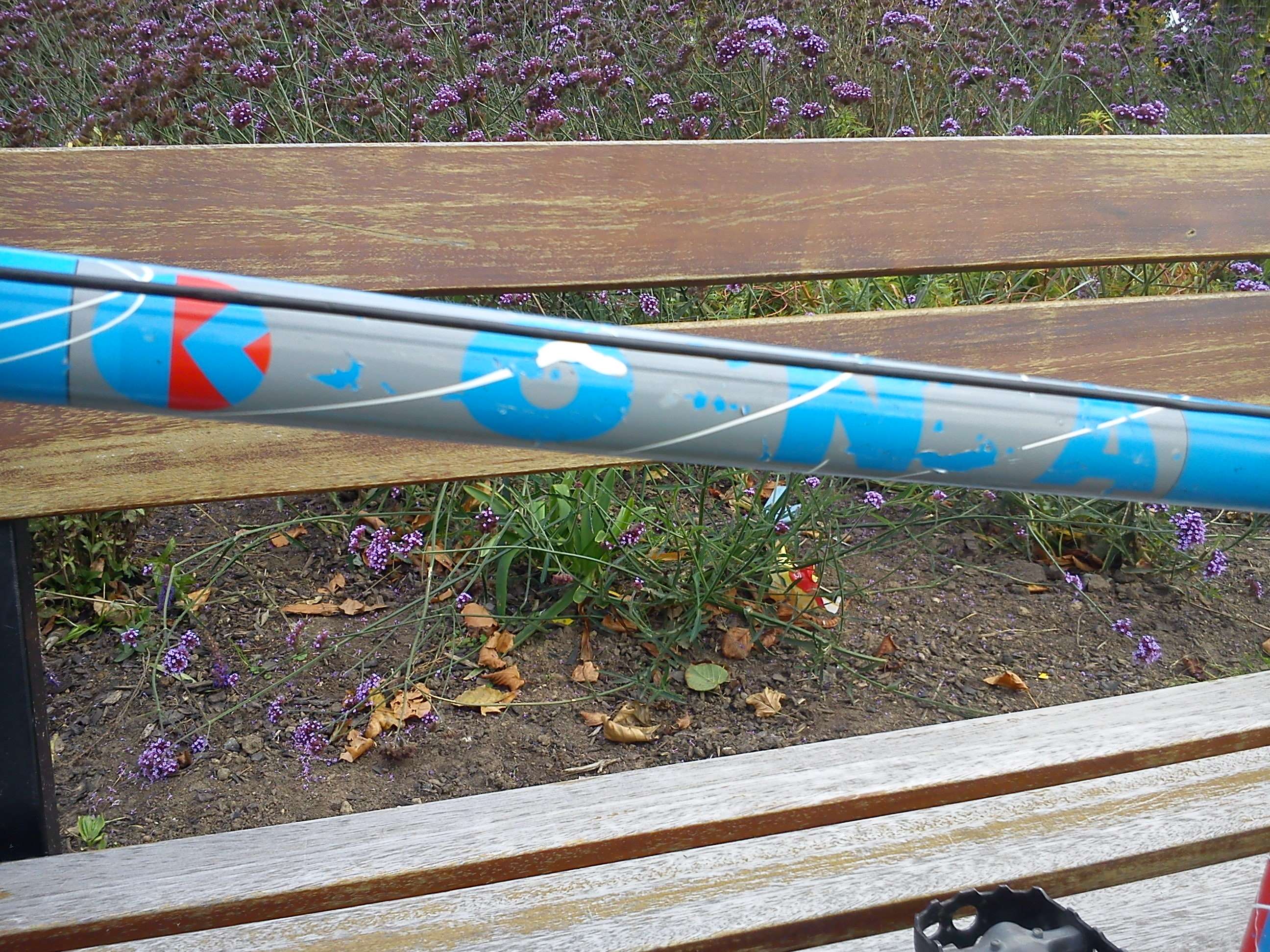

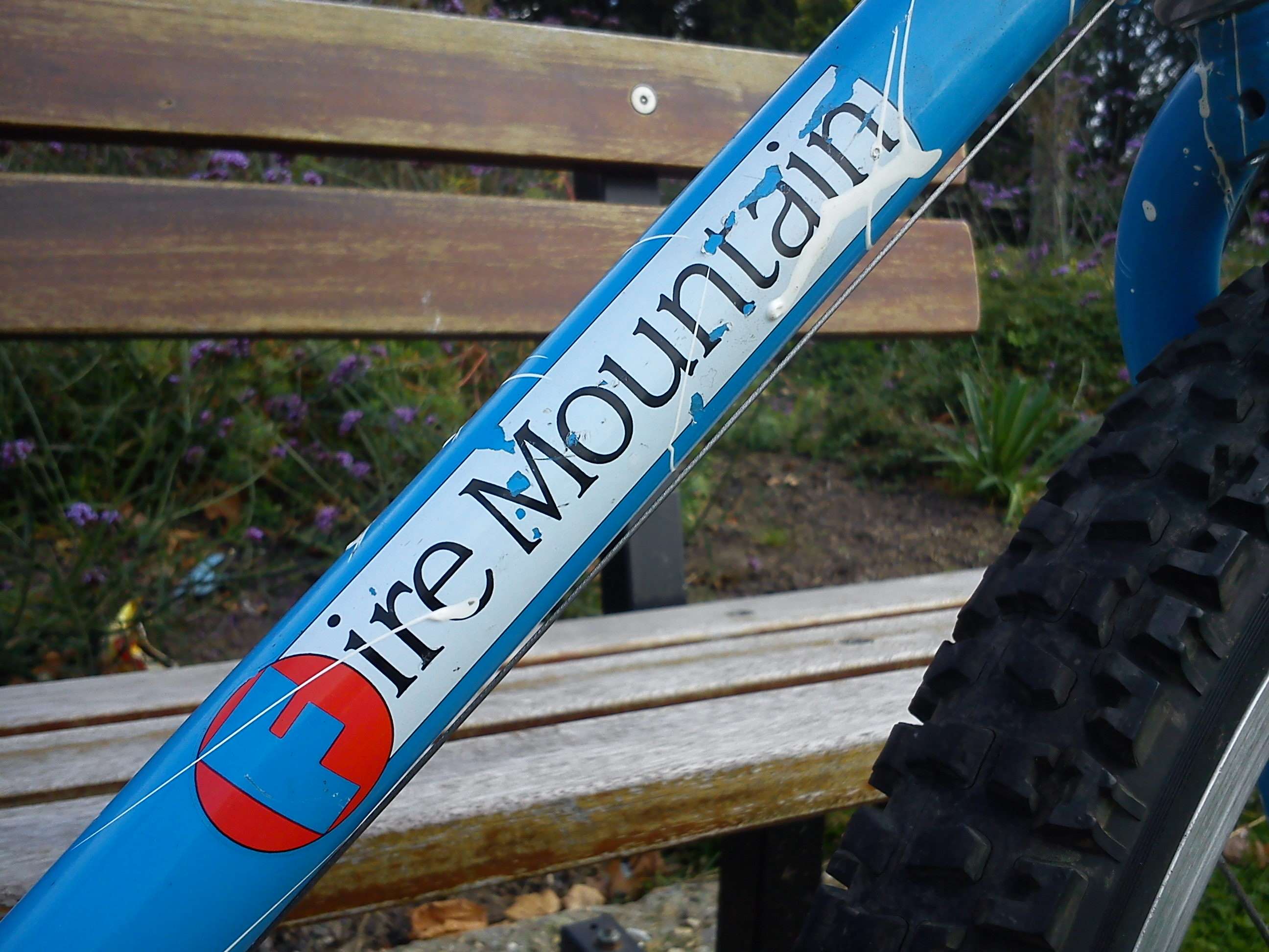

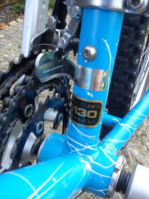

Love the paintwork. Lesson learnt, the paint is splattered on top of the decals, not the decals on top. At one point I really was torn on whether I should keep them or remove them. I think I made the right call.

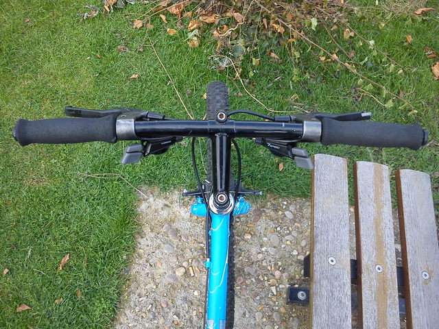

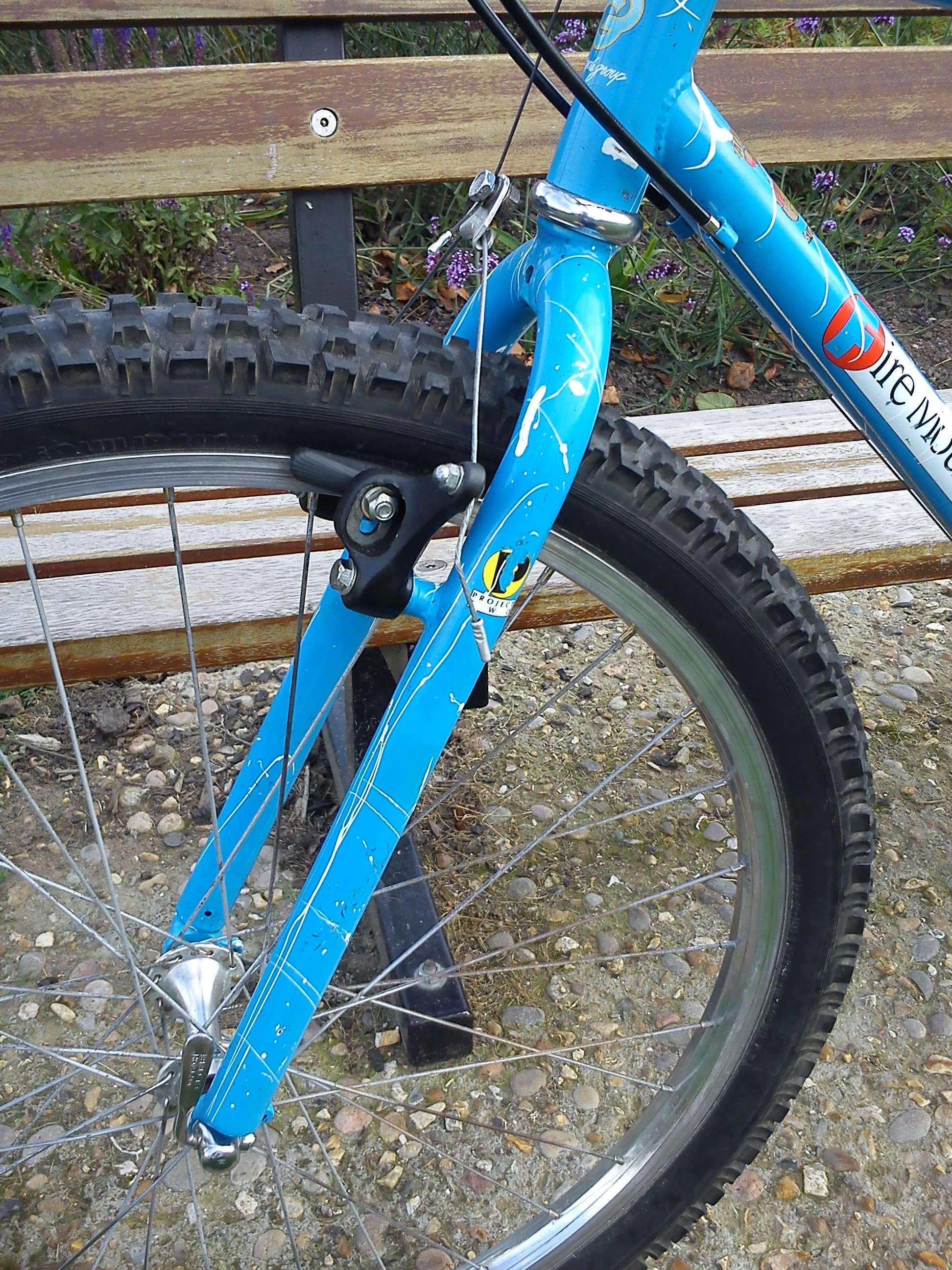

Here she is, complete. The only other item I had to source other than the tyres was the seat bolt / quick release. That was an evilbay purchase from the US and it's lovely (NOS apparently but you never can tell).
Picture heavy content coming up:

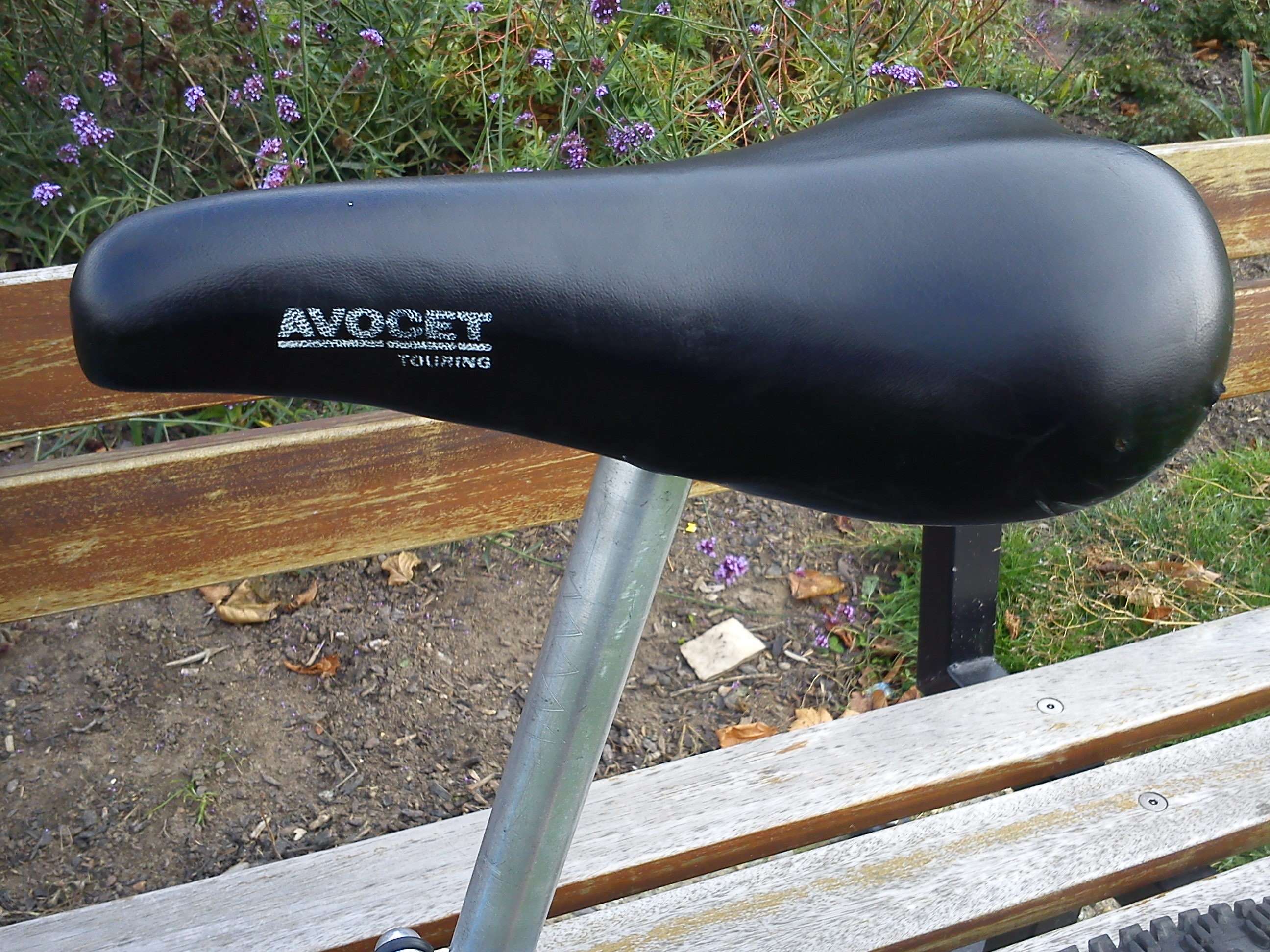

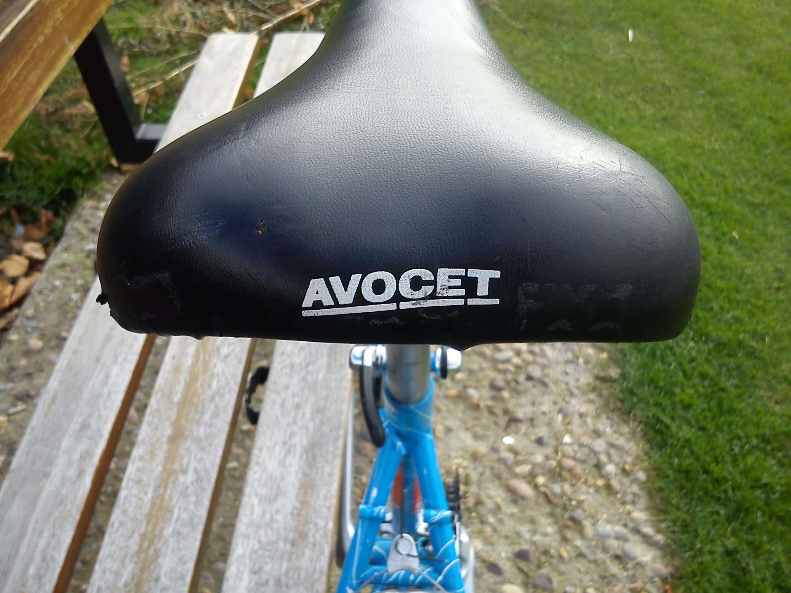

The saddle was repaired with evostick and some pegs. Not perfect but too good to replace in my opinion.

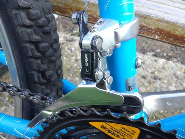

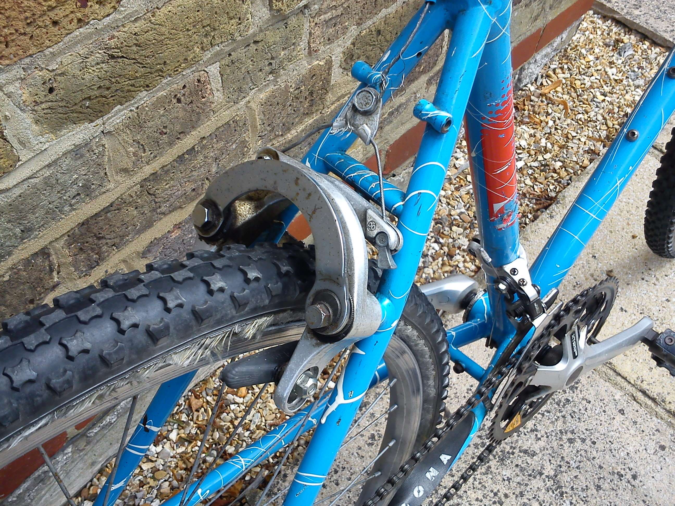

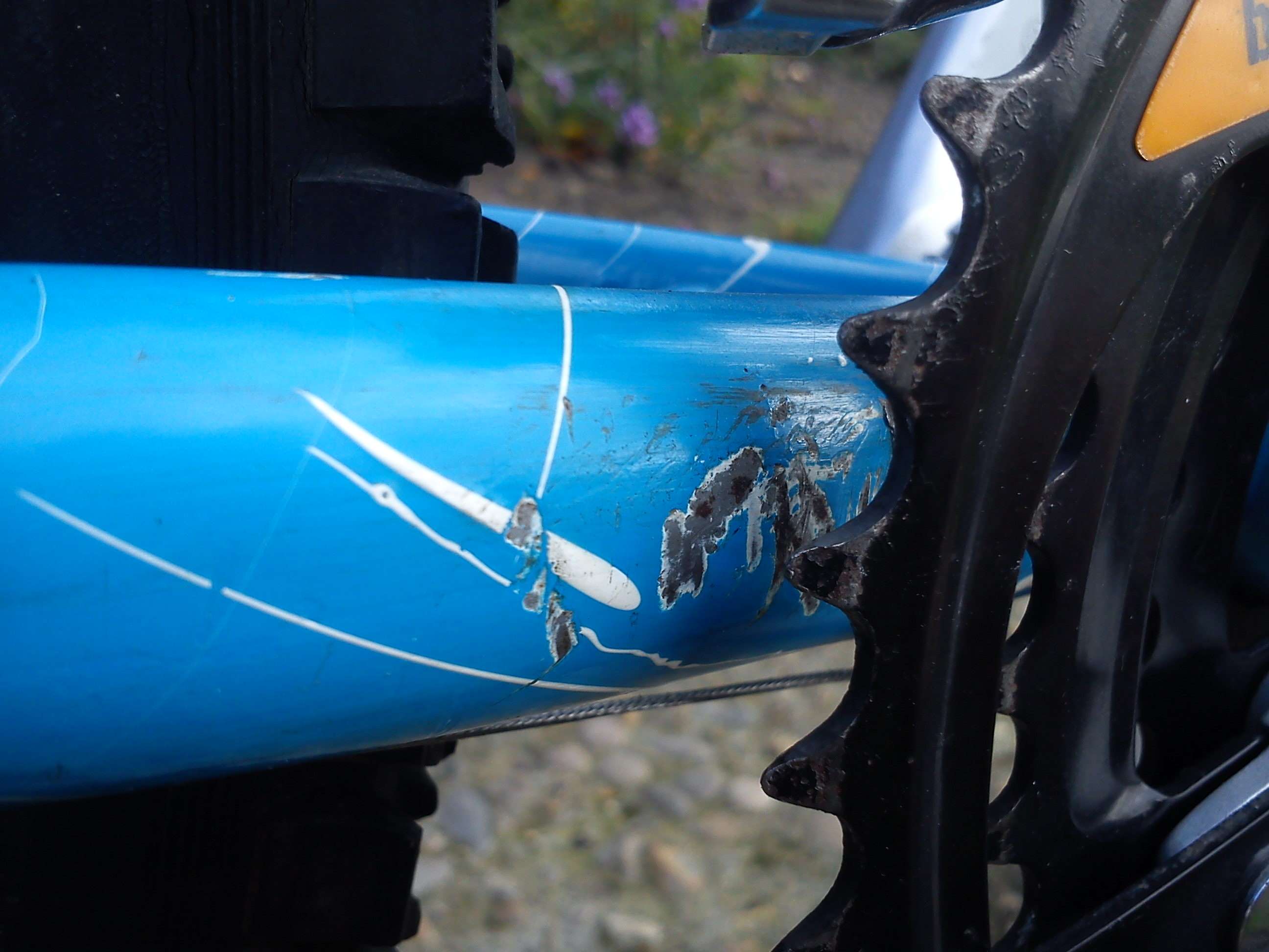

The only really noticeable chain suck, there are a few light scratches elsewhere but she's been well stored.

Little bit of brasso with a wire toothbrush and it came up nice!

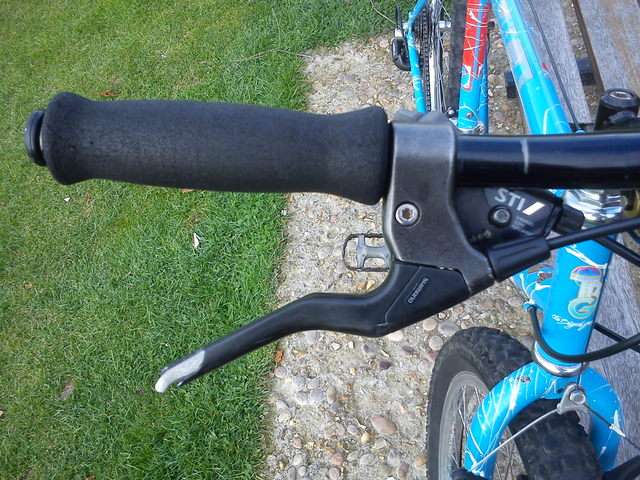

Nice original grips, carefully removed with WD40 and re-applied with hairspray. Shame the brake lever is missing a little plastic.

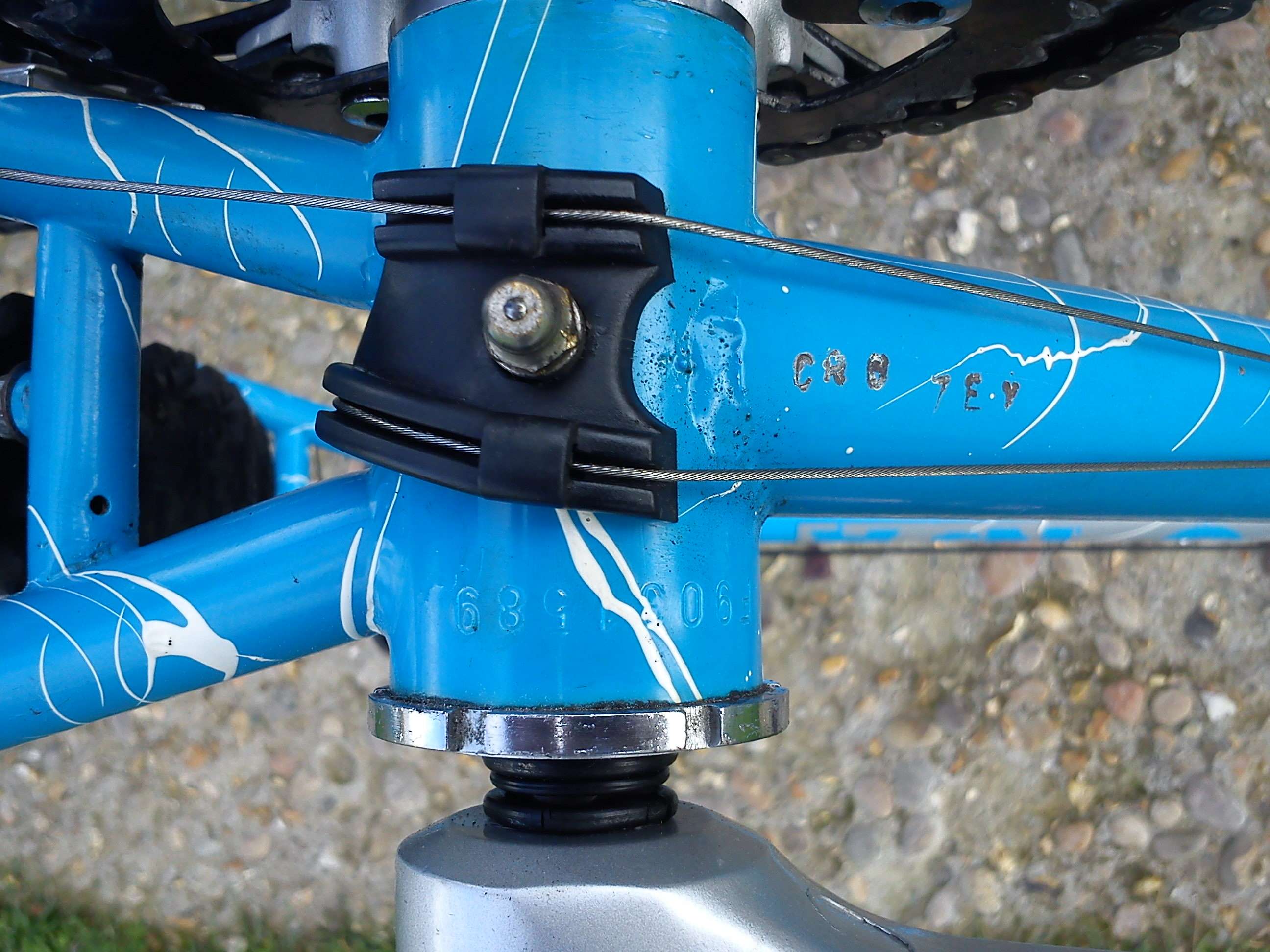

Serial number action and post-code protection :wink:

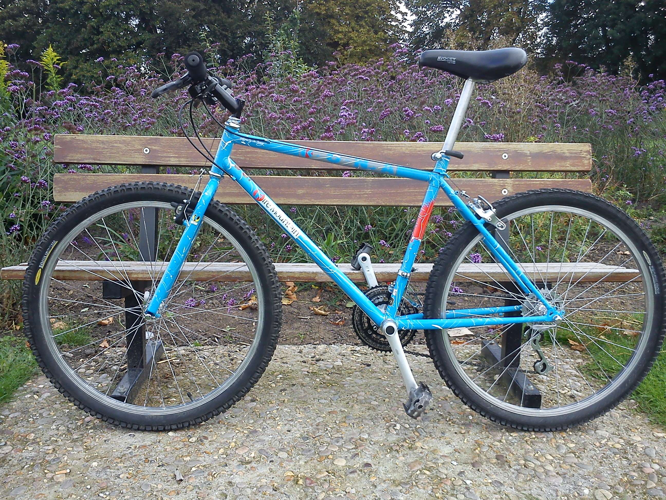

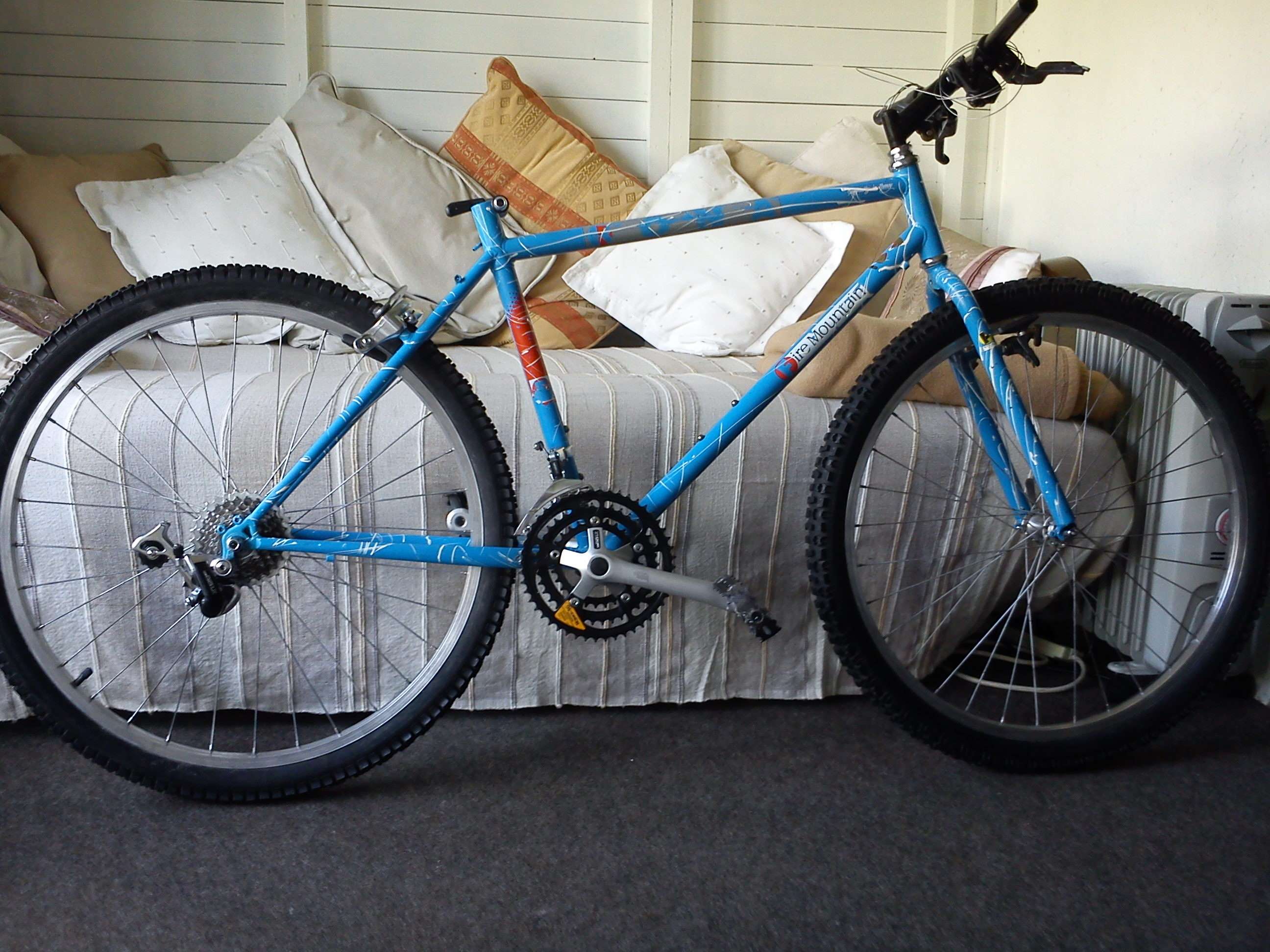

And there we go.
She's heavy and the shifting is a bit :? but once you get her going, she's fairly nimble.

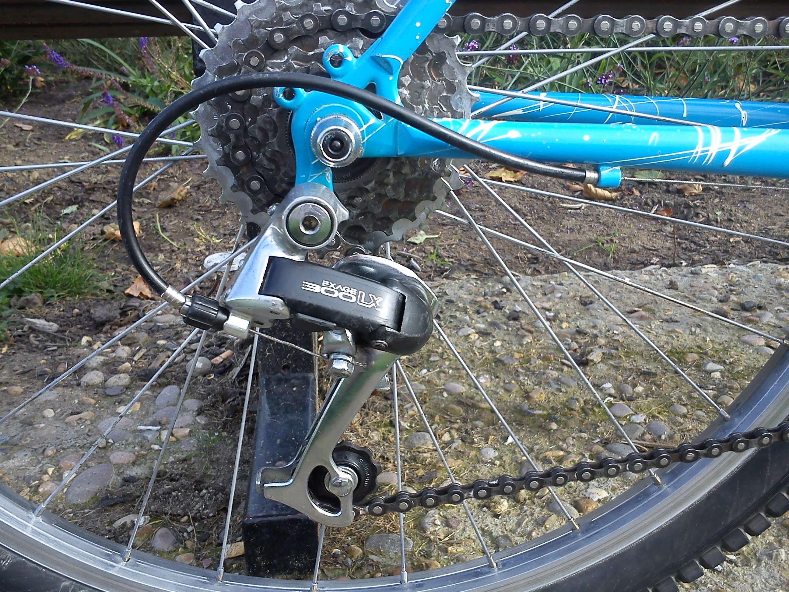

Very nice. Just goes to show you don't need a high-end, bling-spec bike to make a good project. It's tough to decide about paint stripping but i think that looks fine. A few chips add a bit of character and certainly keeps costs down. It's very good for a bike of its age.
How does the 300lx kit perform?
