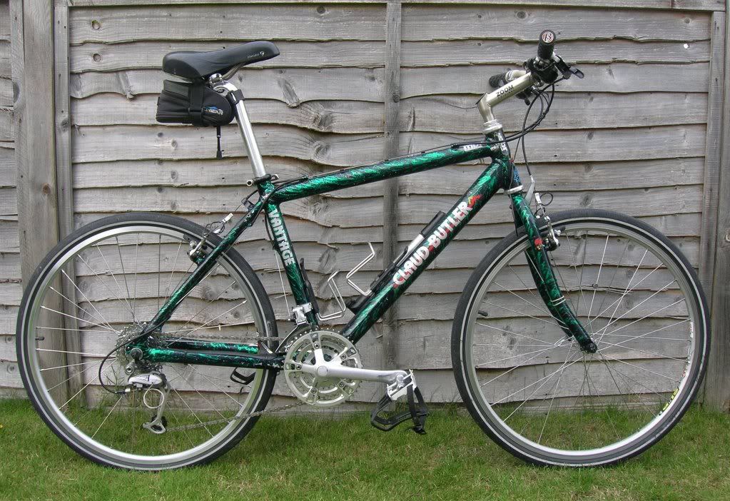

This is just an up-date really from the Retro MTB Chat forum regarding my dear old Claud Butler.
It has been with me for nearly 20 years, but was retired from any Off Road activities a while back. Saturday before last it was hit be a car, see:
http://www.retrobike.co.uk/forum/viewto ... highlight=
The driver of the car paid up, and I have replaced the damaged parts with vaguely suitable components.
I re-built the wheel using a Mavic XM 317 with D.T. Swiss 2.0/1.8 spokes back onto the XT FH-M737 hub. Doesn’t quite match the SUP 217 that was damaged, but good enough I guess.
Sadly… a Shimano LX M581 SGS to replace the beautiful XT RD-M739 Rear Mech. A few other nick knacks, and it’s back on the road as my Happy Shopper.

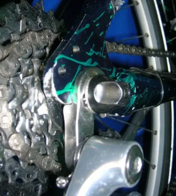

Glad it helped you reminisce - I believe the Vantage was higher in the range. I would say that it's Oversized Aluminium, and would have been quite the thing back then! Mine didn't originally have a replaceable gear hanger.
The previous owner of mine has hands like shovels and had virtually stripped the frame's Aluminium thread for the Rear Mech.
I contacted Claud Butler in Brigg, and free of charge they sent me some instructions with a gear hanger, a 3.5mm drill, a 4mm tap, some M4 C/S stainless fixings and some touch-up paint - which was sweet of them.
Sorry about the poor pic.
