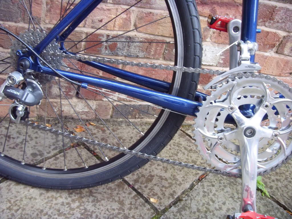

- Lightweight steel frame - Dedacciai brazed by Lee Cooper I believe
- Deore Wheels
- Deore Vs
- Unbranded XD2R cranks (similar to those sold by Spa) - quite good quality actually
- Crappy steel rings - will get some TAs eventually - 52-42-30
- 8 speed 11-28 cassette
- Alivio rapid fire shifter
- XT friction thumby
- Kenda slicks
- Specialized BG saddle
- Ultegra road triple front mech
- Exage 300 short cage rear mech

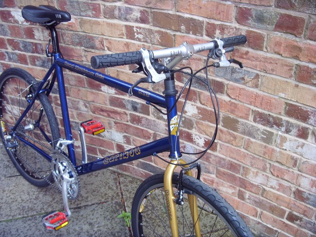

to do:
- pedals will be changed (silver platforms on order
- guards to be fitted
- some kind of ergo bar-ends

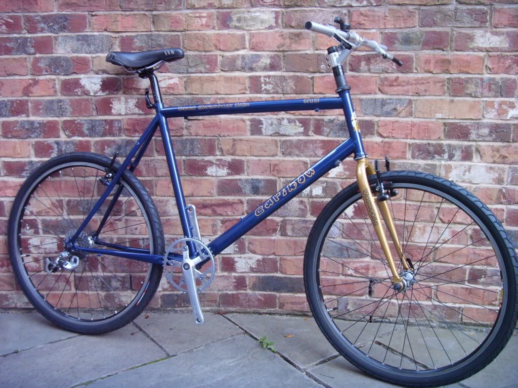

All in all seems like a nice, bomb-proof road bike. 27" to 118" gears - suits me fine for hills. Fairly upright position, again ideal for me.
Initial impressions are good, comfort with speed and good road handling. I like it!

What sets it apart from just another slicked-up MTB are the forks which give quick and lively steering (not at all ponderous) and the ease of fitting road chainsets with narrow bottom brackets.
Even with the steel rings it is quite a light bike thanks to the dedacciai tubing.

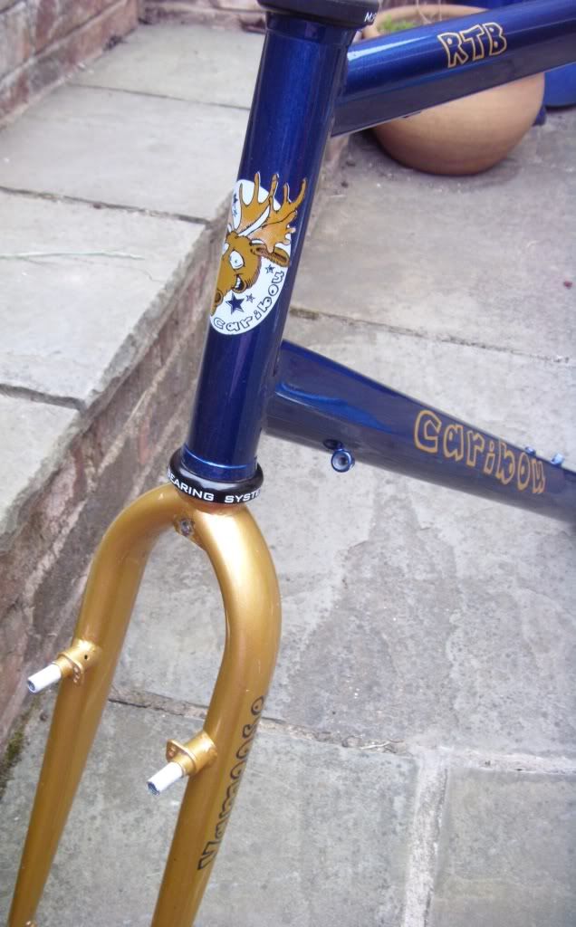

How long is that steerer?? :shock:

The steerer is uncut. Don't recall how long it was. 270mm? Something like that.
