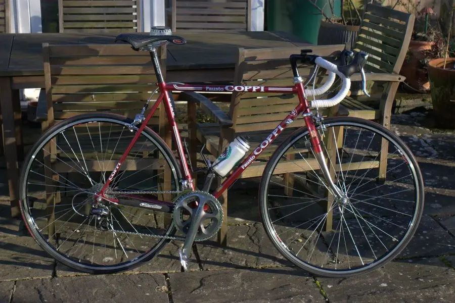

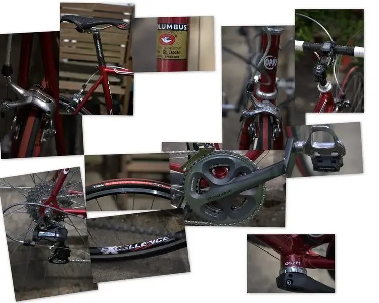

Here's my second effort, possibly not retro enough for some but a light-ish and stiff racy ride in steel. Now with quill stem
Frame: Fausto Coppi by Masciaghi
Fork: Columbus EL
Headset: Campagnolo Record
Stem: 3TTT
Handlebar: ITM Millenium
Bar Tape: Fizik Microtek
Brake Levers/Brifters: Dura Ace 7800
Brake Calipers: Dura Ace 7800
Brake Pads: Kool Stop Salmon
Brake Cables: Transfil nox snake
Front Derailleur: Dura Ace 7800
Rear Derailleur: Dura Ace 7900
Derailleur Cables: Dura Ace 7800
Cassette: Dura Ace 7900 12-27
Chain: Dura Ace 7800
Cranks: Dura Ace 7950 Compact
Bottom Bracket: Dura Ace 7900 Italian
Pedals: Dura Ace 7810
Rims: Ambrosio Excellence
Hubs: Dura Ace 7900 36H
Hub Skewers: Dura Ace 7900
Spokes: DT Competition
Tyres: Vittoria Open Corsa Evo-CX
Saddle: Selle Italia Flite Genuine Gel
Seatpost: Campagnolo Chorus
Bottle Cage: LifeLine Black alloy
Weight: 7.5 kg or thereabouts

generally i like what you have done there, i have a coppi galaxy frame which is lovely, there are only 2 things that spoil it for me, the stem arrangement, please find a suitable quill stem and lose the adaptor assembly, and on a personal note i don't like the new dura ace, too dark for my liking. i think the previous version might have being a little nicer having a more polished look.
bet it rides lovely though :)

Agree about the 7900 - a bit ugly, even close up. I wanted the compact chainset though and when you have that you might as well have the RD too. The FD needs to be 7800 with the 7800 STIs, which I already had keeping the cost down a bit.
The other aim of the project was to build out of parts that are still widely available new, so a quill stem was not really an option either - unfortunately. I bet the frame would look great with a C-record or a 7400 gruppo.

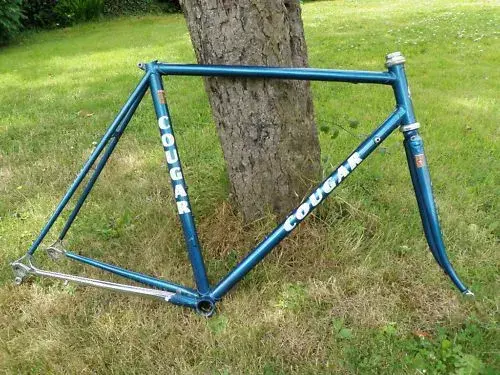

GlasgowSUFC......I'm building up a Cougar too!! I'll keep a look out for your thread.. :D
There's a couple of Cougars on here already.
Here's a pic of me F&F....
(Sorry didn't mean to hijack the thread)
