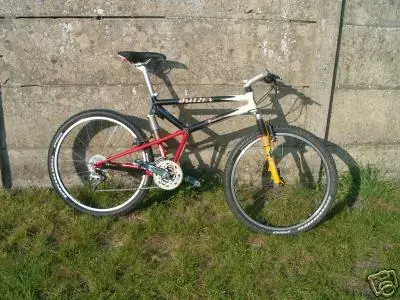

here's a photo of the one with the straight top tube for comparison.
