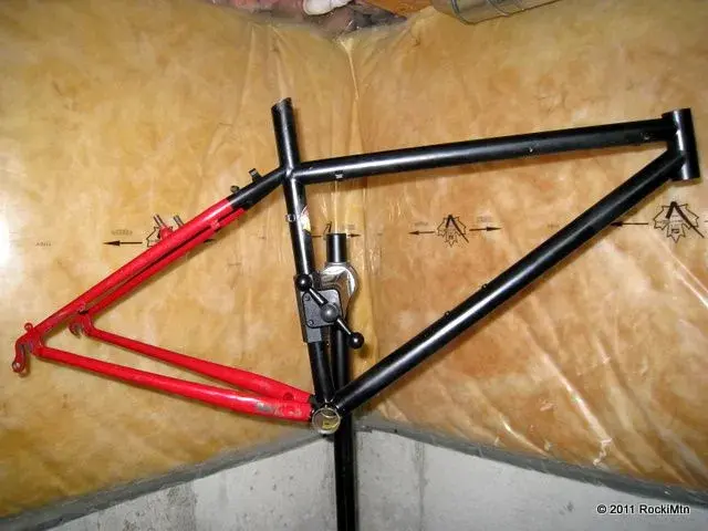

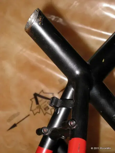

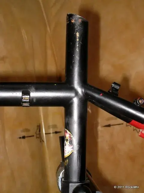

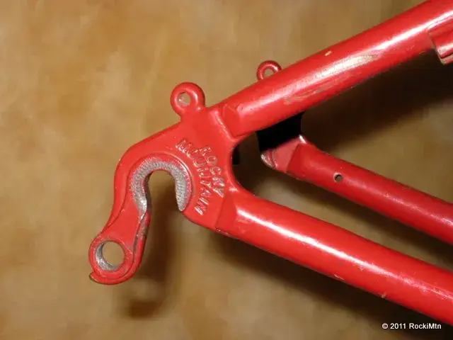

Got myself another project and was wondering if there's an easy way to strip paint that has been sprayed over the original paint? Or if it's even do-able??? :roll:
The front triangle has been resprayed with black paint. Prob from a rattle can. It was ever sprayed over some of the original decals, which I highly doubt I'll recover. :roll:
I want to get back to the original paint to see it's condition and perhaps retain that.
[edit] Okay, added some pics to the thread now! :D

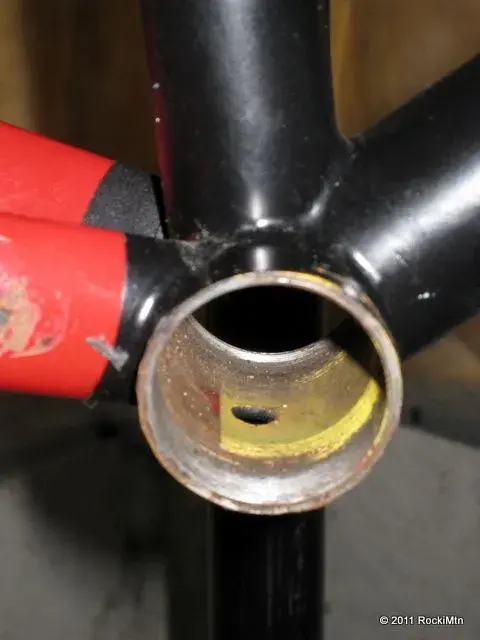

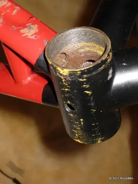

there's no serial number :? as you can see the front triangle was originally yellow, and of course it's an RM. :roll: ;)

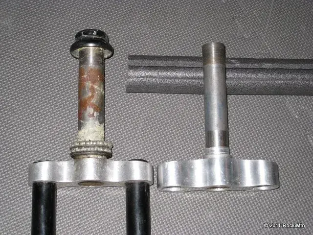

oh, and does anyone have any info or know about a short crown Syncros fork? It's a third shorter than any of the other forks I have! :shock:
this came off another RM bike, not the frame above. it's OE off a 1991.

If that were mine i'd try some cellulose thinners rubbed on the black. It'll probably come off if its a poor job. Failing that either paint stripper ( assuming its powder coat underneath??)
Less risky would be a cutting compound (like an abrasive polish if you will) or 1500 wet and dry.

I'd try some thinners or paint stripper, diluted and rub on and off pretty quickly. I hope you manage to achieve removing the rattle can and revealing the original glory underneath!

What they all said. Rattle can paint is not going to be anywhere near as tough as the original paint so a cutting compound and a large tube of elbow grease or a fine wet and dry or if you're feeling brave then some paint stripper quickly rubbed off before it damages the original finish.
