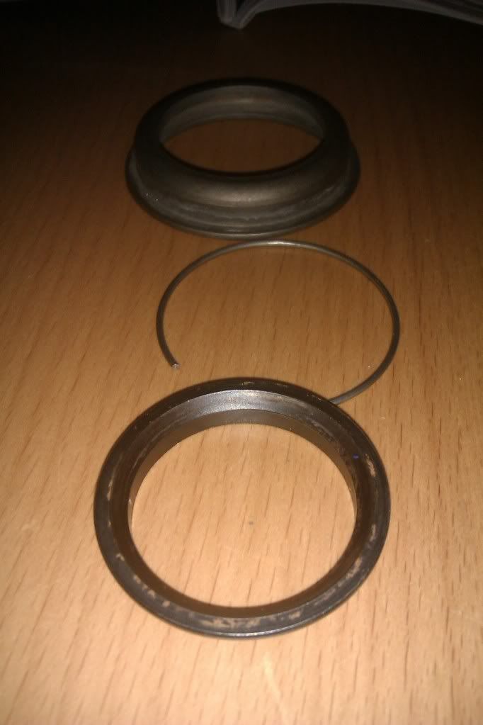

Ok... time for probably the first of many dumbass questions.
The frame I'm hoping to build up uses an integrated headset. It came with most of a headset, but I'm not sure what, if anything is missing, as I'm new to the ahead system in general, especially integrated ones.
Obviously, the top cap is missing, but I have one of those. I don't have a crown race, as such, but then it uses cartridge bearings, so the bottom race is part of it.
Can anyone point me in the right direction.. pics attached

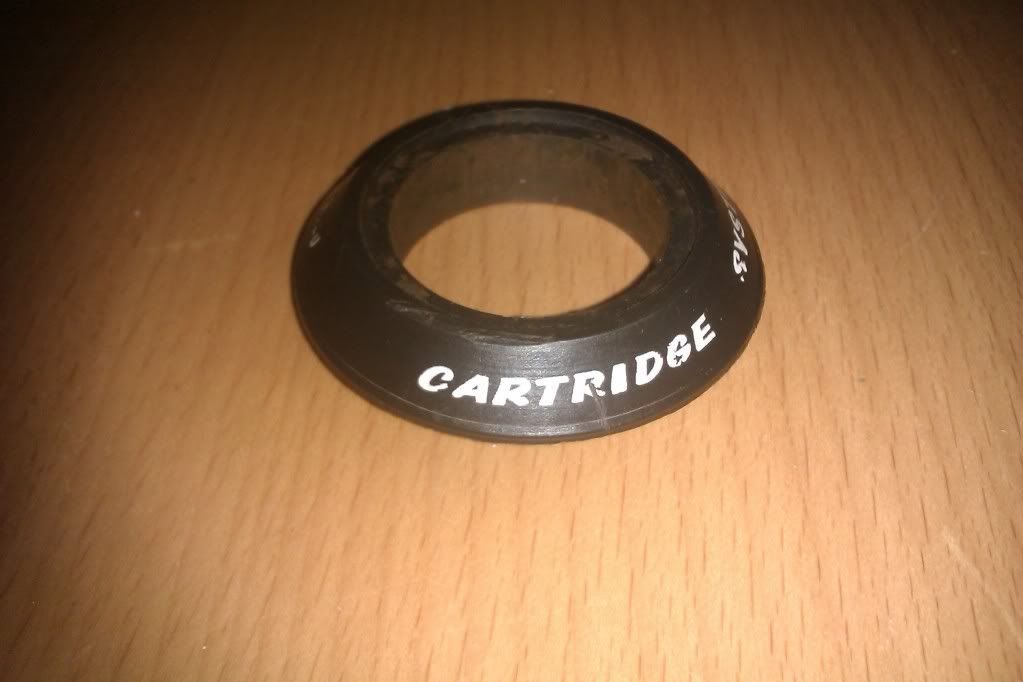

Top Bit

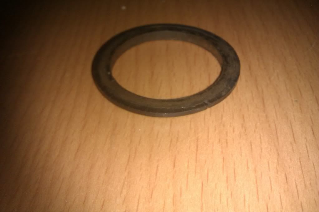

Insert

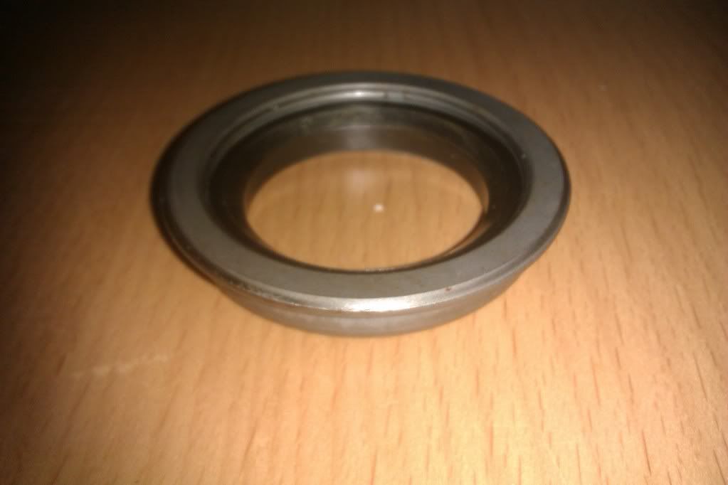

Bearing cup and bearings assembled
Bearing components

looks ok to me :? or am i wrong :?
thats semi-hoop near the bottom though, you should put back in as it holds in the bearing seal
are you considering a new one or on a budget?

I'm definitely on a budget, and the bearings seem fine. I took it apart to give it a clean as it was a bit manky.
I'm hoping to just pop in some shiny new ball bearings and fresh grease.
I'm familiar with the circlip holding the bearing in, but took a picture of it to make it clear what I have.
I figured there must be SOMETHING that goes on the fork crown for the lower bearing to sit against as it IS tapered.

I'm pretty sure you still need a crown race - a mate of mine changed forks on his old bike and left the crown race on the old forks, the headset tightened up and the forks didn't fall out but by turning the forks it was quite clear it needed the crown race - lots of grinding and tight spots!

oh i didnt realise that!
i thought that last part was it
yes, you will need a crown race to sit in there
