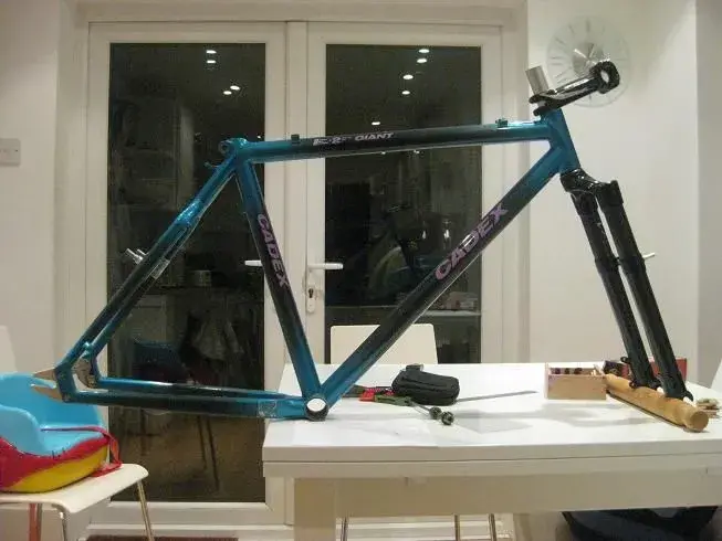

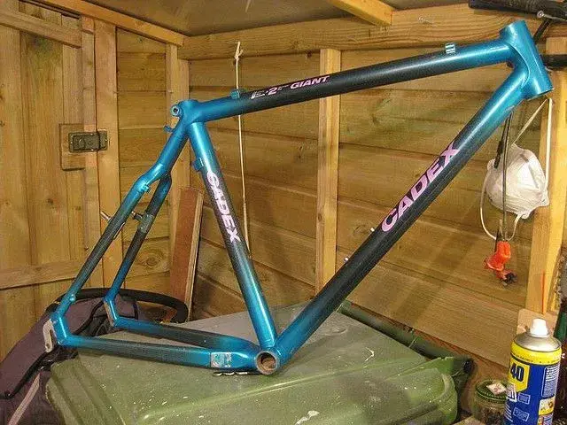

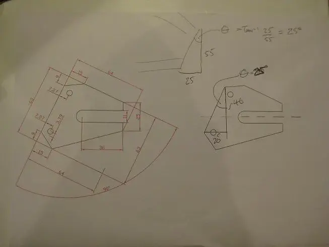

Bought this frame from ebay last year and have finally got round to starting building it up as a single speed. I have assembled all of the parts that I want, and now I'm starting on the dropouts.

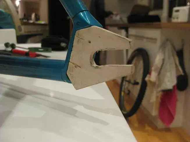

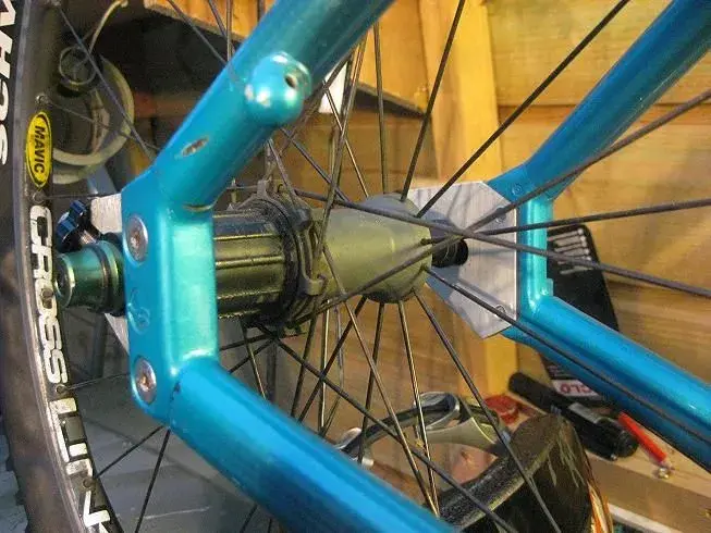

I drew some up in AutoCAD and made a dummy in some 8mm ply as a test - the angle of the slot is not quite correct so I'll make another dummy tonight to get the slot parallel with the ground / wheel base and then get a set made to that template in aluminum.

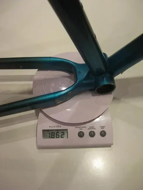

Blimey I bet thats going to be light. I remember they were silly light BITD.
What does the frame weigh?
Good job on the drop outs simple and effective :)

The frame comes in at 1.86kg - I'm not sure how that comparies to other frames but it feels pretty light.

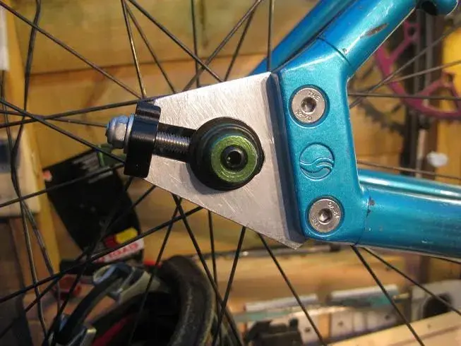

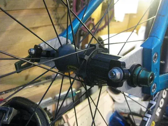

Quick dropout update here - I made another template to get the angle of the slot more in line with the chain stays / ground, updated my drawing and then got some friendly polish metal workers to make a couple out of 5mm plate (£20)
There was a little bit of grinding to get them to make a nice snug fit in the frame (to the dropout - not the frame), but overall I'm quite pleased with it.

FRame is quite light but I'd have expected lighter, still cool project :D and can't weight to see the results. Are you going for as light a build as possible?
