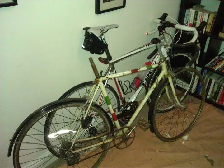

I have decided to rennovate my dad's old Claud Butler, which has been very badly looked after. Im trying to work out the era as well. Its a Caureour but not sure which decade. The Claude decal is in block lettering and the brakes are Weinmann 999s. The forks seem to be bi lam lugs, the front fork badge is a metal not decal and there is an interesting lamp welding on the front right fork. Any clues greatly received. Thanks!
Also, first post, first time ive come across this site but looks great so far.
Cheers, Chris

Hi, the crank is a williams so should have an identification letter which will help http://www.classiclightweights.co.uk/williamsdating.html but looking at it ( the photo is poor ) it looks mid sixties. Check out the Claud Bulter section at http://www.nkilgariff.com/ which has a number of catalogues online. Thanks Terry

How about this "Corridore" from 1969?
http://www.nkilgariff.com/CBcats/Cat_69 ... dorep1.jpg
http://www.nkilgariff.com/CBcats/Cat_69 ... dorep2.jpg
http://www.nkilgariff.com/CBcats/Cat_69/CB1969_Cat.htm
"Striking Finish! White enamel and contrasting triple bands of Italian colours"
It seems to be available for only three years ('68, '69, and '70) and all that changes is the price: an extra two quid every year!

Wow, i think thats it, i must have misread Coureur. The decals have seriously faded! Thanks for your help - now to continue the strip down and prep for a respray. Will have to retain the original colour scheme now!

Chris, the Holdsworthy Company made these from about 1960 on, badged as Claud Butler and Freddy Grubb, well made in quantity cheapish frames, mostly from grade A drawn steel, (not "gas pipe"), some models had 531 3 tubes. Their better frames in the 60's usually badged Holdsworth, not W F Holdsworth.
It looks mid 1960's.
I sold a lot of them then.
No bi-laminate as far as I can see.

Thanks for your replies, really appreciated. Im down to now trying to remove the pedals which given its state of disrepair is not going to be an easy task - being new to the rennovation scene (but addicted already!) ive never come across this type of set up before - as you can see from the Trek in the background!

Chris, impossible to know your state of knowledge, but pedals are right hand thread for the right, and left hand thread for the left. R H pedal undoes anti clockwise.
Failing any other tools, (I had a cyclo cam type cotter pin squeezer) I could knock out cotter pins using 2 fairly light hammers. Support the bottom bracket or underside of the crank, undo the nut, place one hammer on the threaded end of the cotter, and hit it sharply with the other.
This has 2 advantages, your fingers are out of the way, and you can hit more sharply because you have a bigger target. They are still a pest. I was a cycle repairer in the 50/60's.
